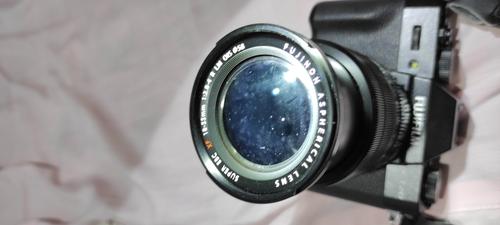

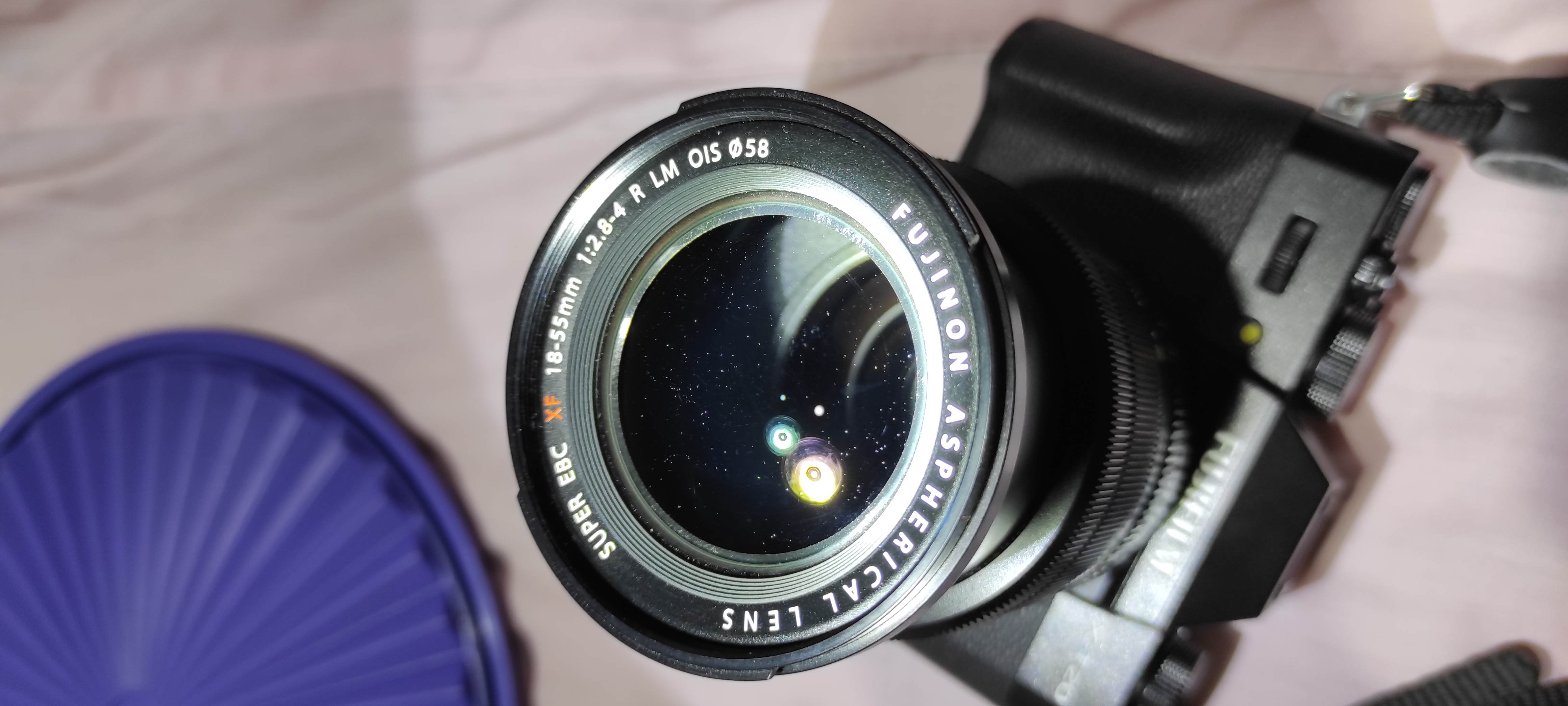

    I bought this camera from 2017 used it not so much for 6 month, sit in tupperware with silica gel for 5-6 years, is this fungus or just some smudge and dust??? first is uncleaned and 3rd is cleaned with microfiber on front element. If it is fungus do i have an option to remove that? will it harm my Camera sensor? since this lens is attached from first i buy it and i dont have any other lens

    No, it looks like dust to me.
    I wouldn’t worry too much about it.

    Thanks for the reply Greg, I live in very humid country which is hot and rain season, in 2018 i brought this to japan in fall-winter season that what worried me the most because of condensation, the coldest is -4 and no snow. I store it in tupperware though with silica gel instead of dry box and i dont monitor my humidity, i havent buy any lens since, because i dont shoot too much and 35mm f1.4 is my next destination. if i dont strike the lens with direct lamp like in the photos the lens look very clear though and from image quality i dont feel any difference since the first i bought it

    Is it only on the outside or also inside?
    As Greg said, expose the glass to sunlight. In addition to very careful cleaning with a microfiber cloth and demineralized water. If water does not help, you can also try or methanol p. A. or isopropanol p. A.

    First, that looks like dust, so a proper cleaning by someone who knows how to disassemble the lens and perform a cleaning may be the first step. Second, if you do find fungus, then realize that sunlight will stop the growth of fungus, but not remove it...

    i can only clean the outer part, and yes it looks like there are many dust inside the lens compartment, i dont have any profesional to open my lens though so this will be enough, and do alcohol(etanol) 70/90% damage the coating? is it any difference with methanol or isopropranolol?

    Ethanol is also fine. It is less polar than methanol and more polar than isopropanol. All those three belong to the family of small alcohols. They are very similar, chemistry wise, means they have similar properties. They will not damage the coating.
    It is much more important that the alcohol you use has no non-volatile impurities. Otherwise it will leave a trace on the glass.
