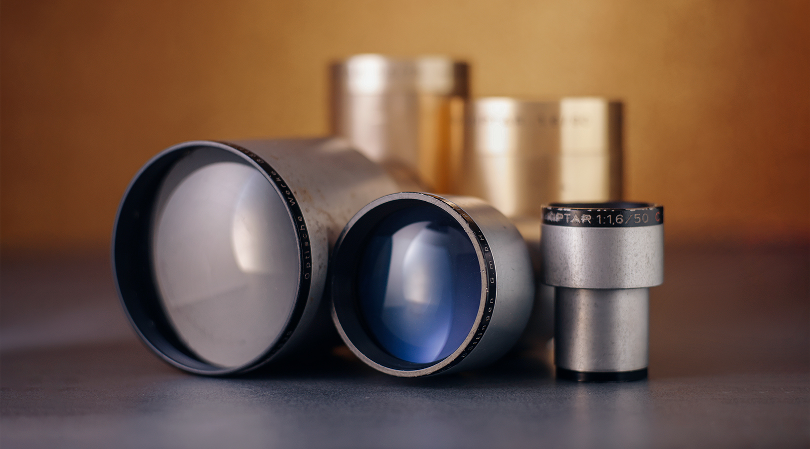

    This one surely is my most comprehensive write-up so far. There are still many open questions and missing pieces, but I've tried my best to provide an overview of the different series of the Kiptar, Super-Kiptar and many related (in name, development and design) lens families. I've also included lots of bits and pieces about the history and possible connections between these lenses or ones from other manufacturers. I also created a rough timeline of Schneider, ISCO and some of the relevant products as well as a serial number overview. Unfortunately Schneider didn't respond to my questions about the matter, but I still hope they're going to help me out by clarifying or adding some of the stuff that's still unclear or missing.
    You can find the article here:
    deltalenses.com/the-kiptar-story/
    I've experimented with many of the lenses in question myself and included a lot of sample shots. In addition to that I'm also very happy and thankful that Gudrun Besler (aorta-besler) who is a wonderful artist, photographer and experimenter of unusual lenses from Germany, has agreed to share some of her beautiful shots taken with several samples of Kiptar lenses as well.
    If you have some additional information on the matter, please let me know!

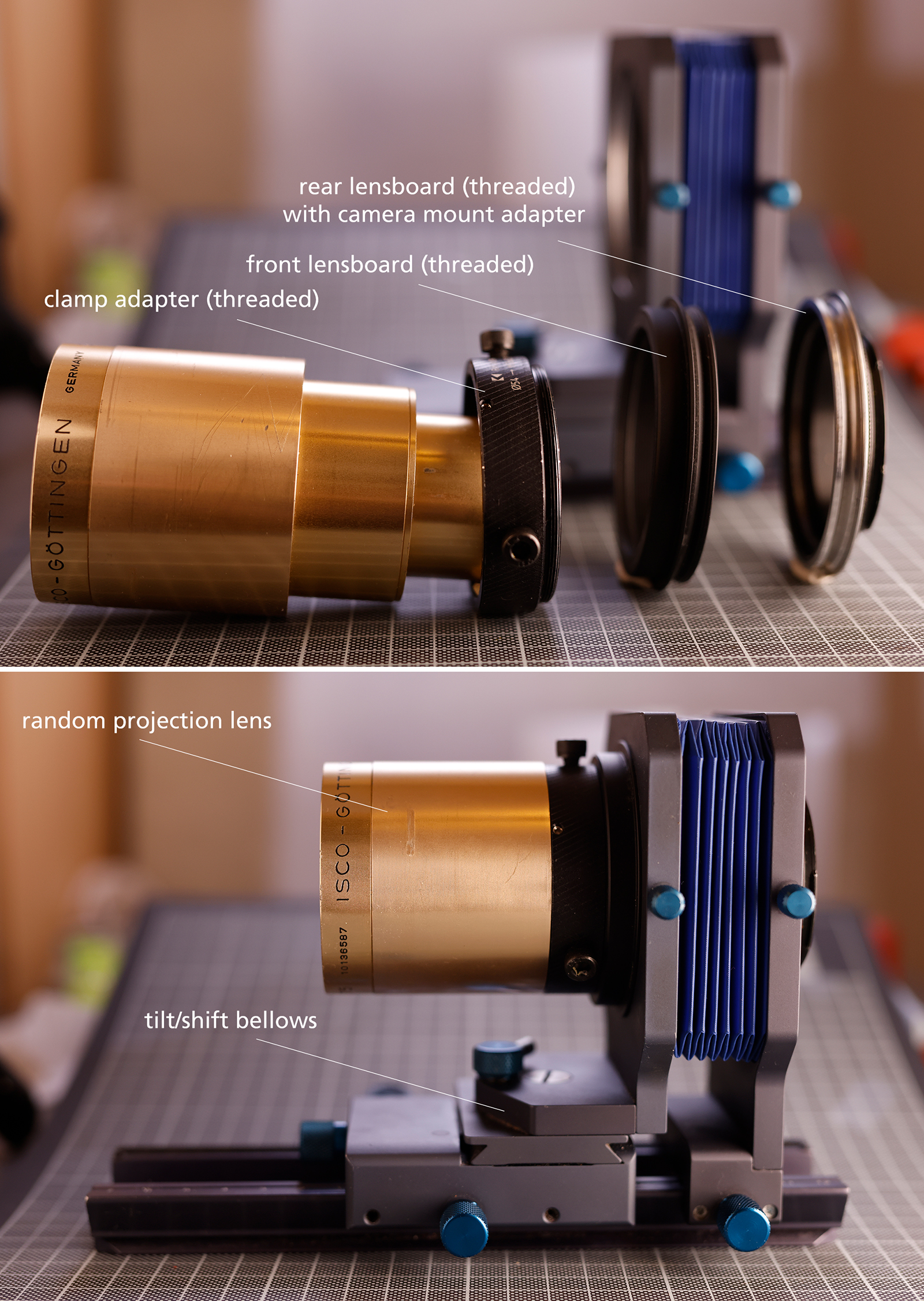

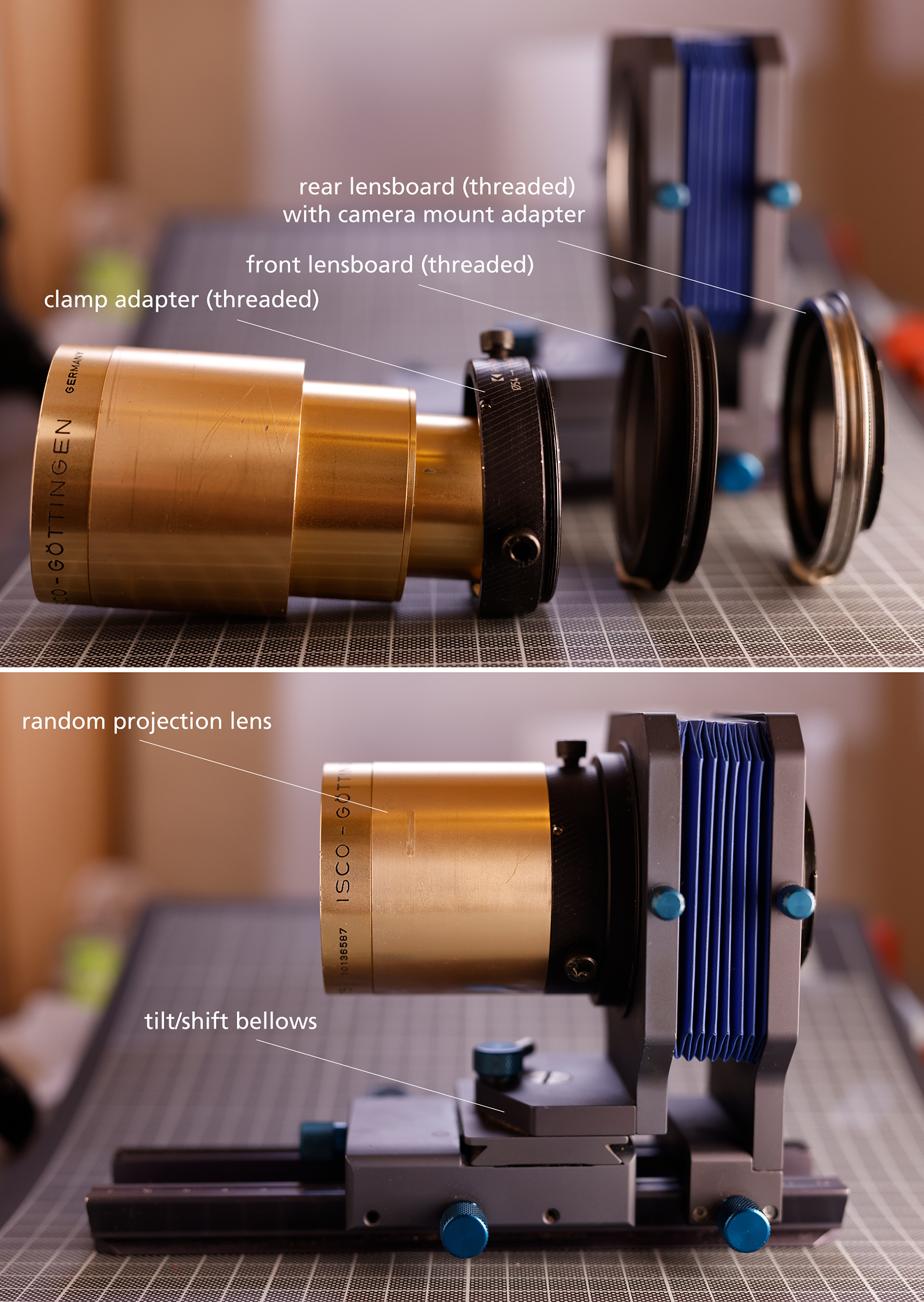

    Is it possible to show us some photographs of your setup, camera, lens adapter, etc.?
    I am curious 😁
  • Members 1995 posts
    July 2, 2025, 11:14 p.m.
    Thank you very much.
    Indeed... and it's very obvious from time to time.
    Yes, of course. Here's my basic setup:
    Of course there's quite a bit of variation in that (depending on the diameter of the lens) and it's also not necessary to use a bellows. A helicoid works as well and is significantly cheaper and easier to adapt stuff to. I just prefer the bellows because of its tilt/shift capabilities and the extended range for macro it provides.

    Thanks for sharing your very professional looking "base setup" 😎
