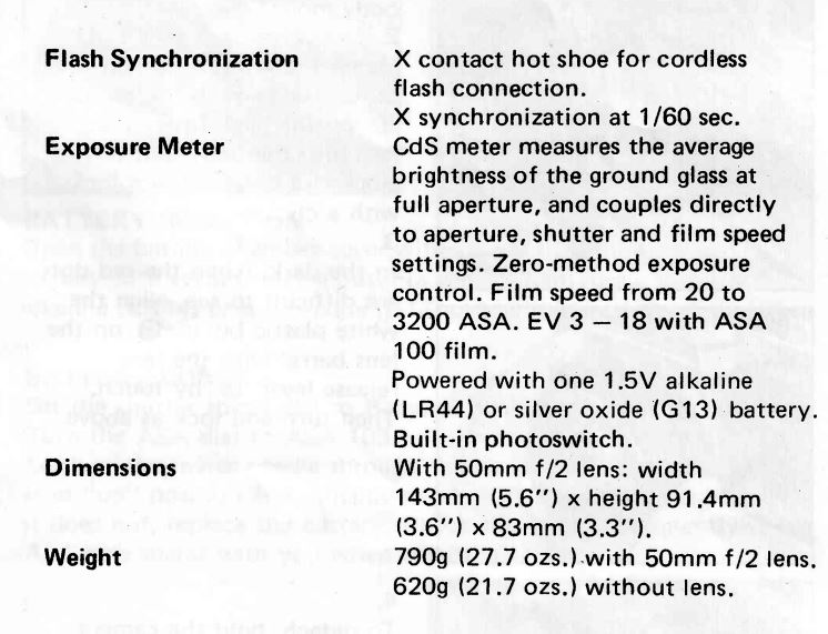

    says here directly
    JPG, 84.9 KB, uploaded by DonaldB on Aug. 9, 2023.
    Aug. 9, 2023, 8:21 a.m.
    ISO sets the shutter speed indirectly as was shown in the example because the shutter speed is set according to ISO and will vary as ISO varies.
    Aug. 9, 2023, 9:33 a.m.
    I think it would that on most cameras but the example I posted only the image lightness remained the same while the exposure in Setting B was halved.

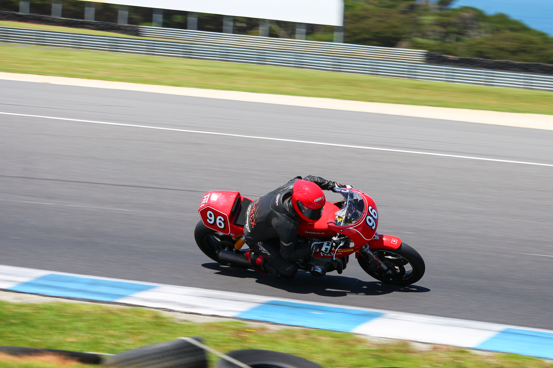

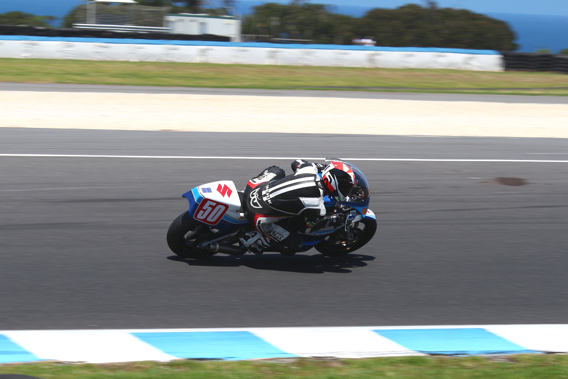

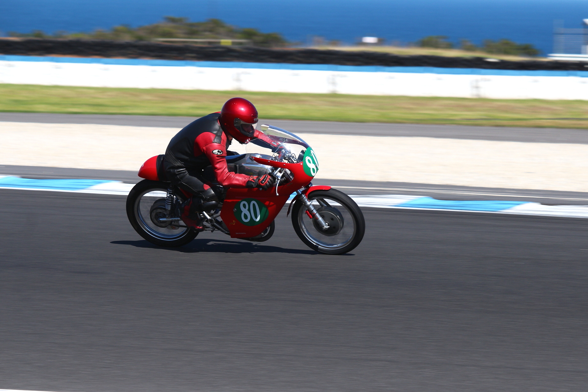

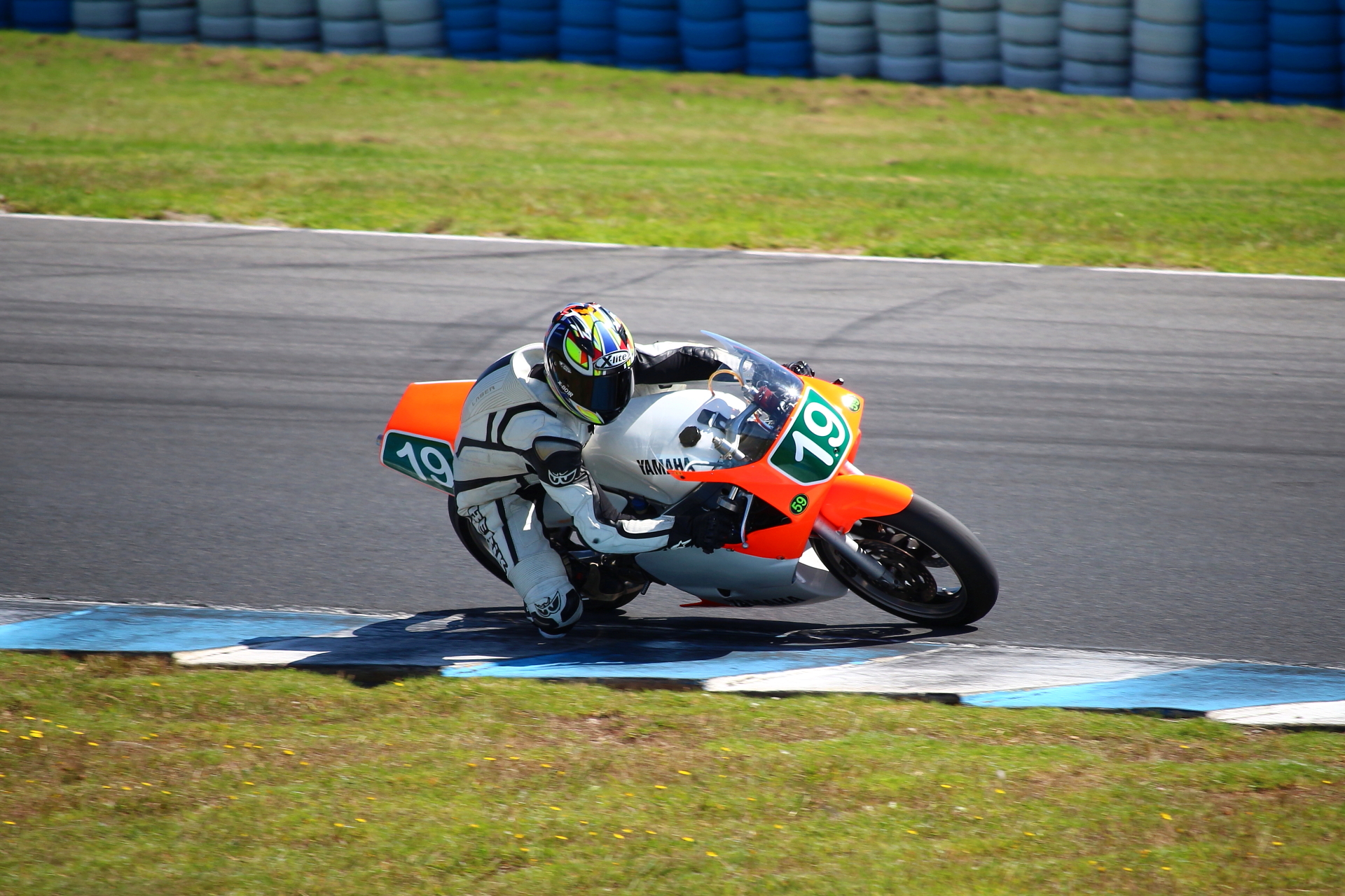

    I think I've got that under control mostly, even manual focusing, so I think I might be allowed to play around with ISO & give that a bit of attention.
