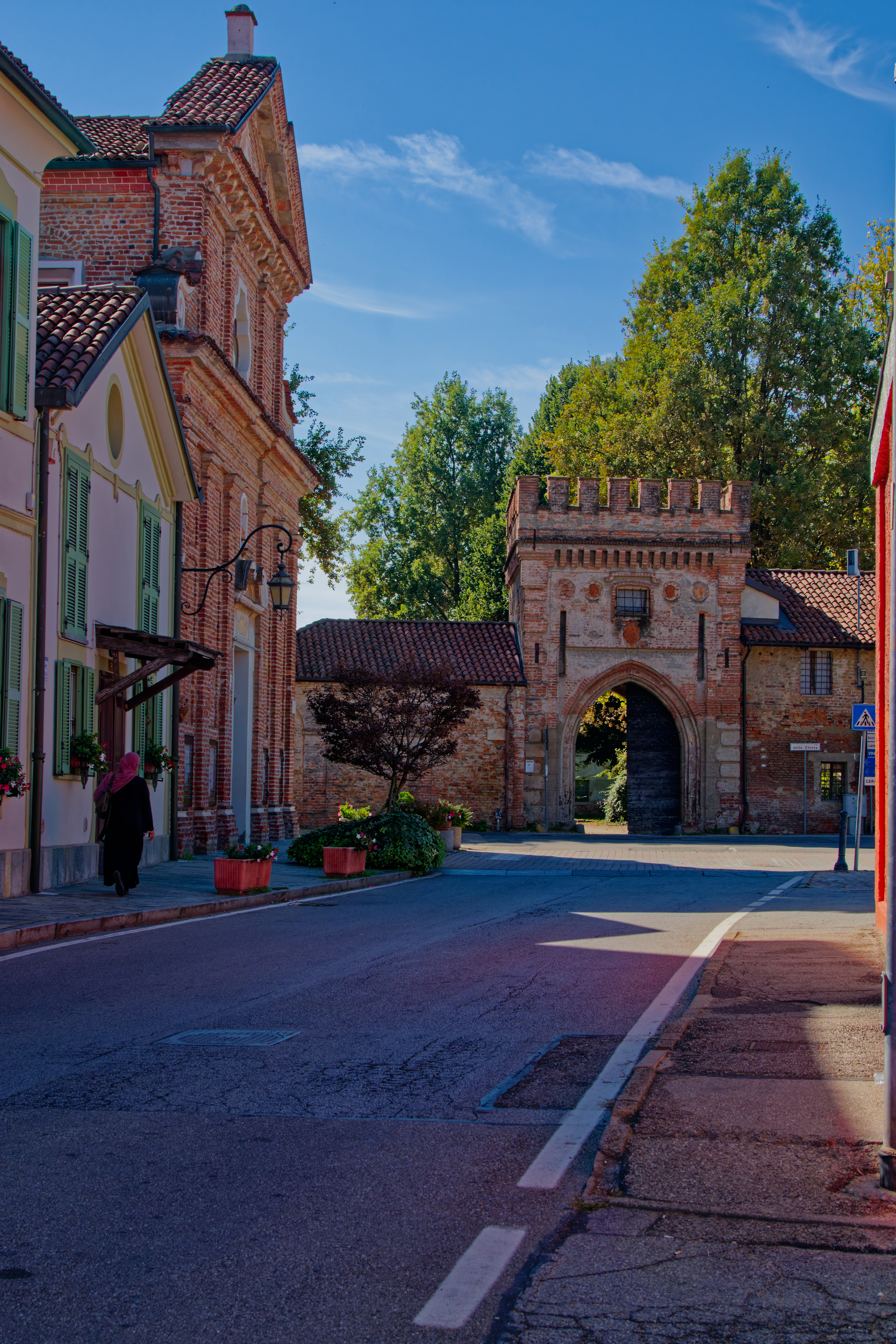

    About the Photo ... I tested here Google translate for > The Lodge The Church <
    Naahh ... City: "La Loggia" ... Place: "La Chiesa" road's intersection
    Note on the Two Walls on the right:
    One ... bright Hard Yellow for the church, the other Bright Red for the curb, asphalt, and sacristy.
    [Nikon Zf +24-200ZE - 1/650; f/8; ISO 450 @58mmE ]

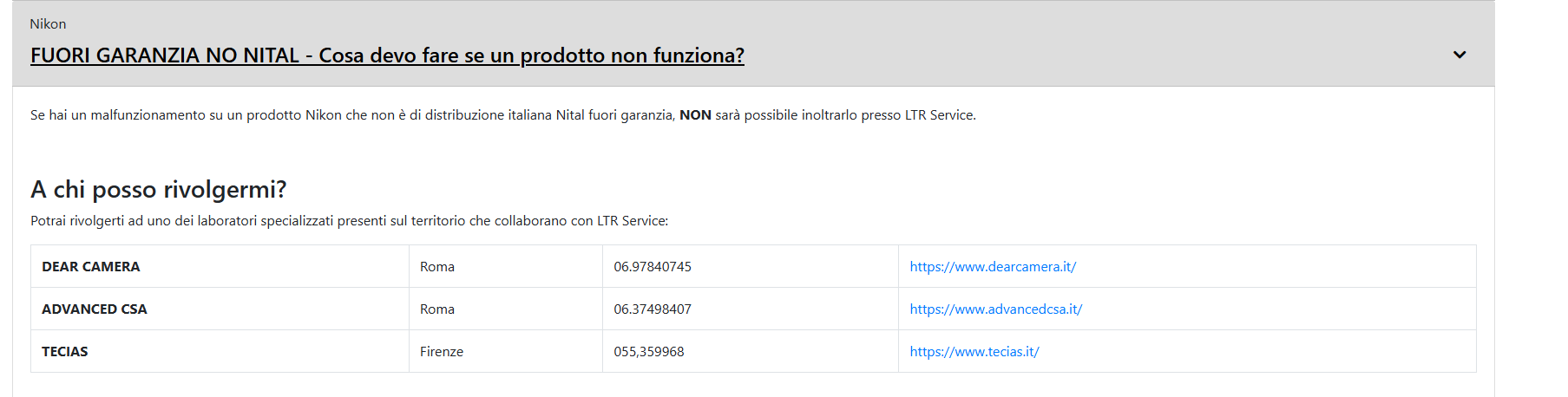

    Have you tried with Nikon Europe?
    It is true Nital/LTR will not touch non Nital gear, but they give the names of 3 repair companies.
    ltr.it/faq/?c=1&b=NIKON&w=0
    In Italy it is pretty vital to buy Nikon/Nital as if shit happens, you can get things repaired. LTR are top notch for repairs, from my experience.

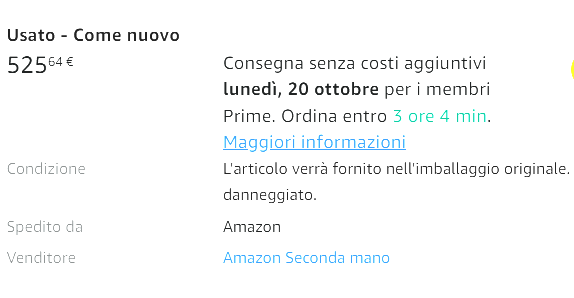

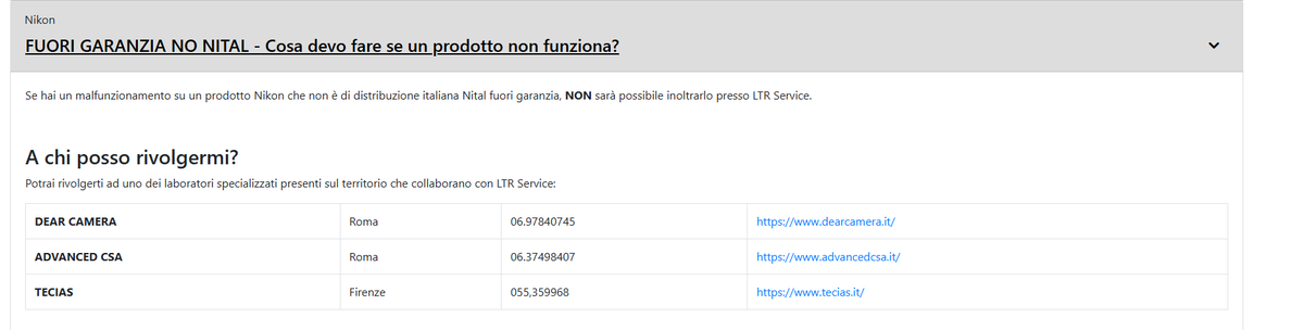

    About Nikon France/Nikon Europe/ Nital repair:
    Nital repair any Nikon stuff ONLY in the FIRST 12 months > respecting Nikon-WorldWide-Waranty.
    Would have been inside the 24 Months, both Nikon.FR & Nikon.Eu offered me Full Coverage on logistics.
    But outside the UE warranty period, it would not have been cost-efficient to send an insured parcel both ways. [2x55€]
    I could have sold it to my friend for 250€ with repair at his cost... and buy this one from AzWarehouse New No-Nital for 525€, instead of an Az New Nital 780€
    Thanks!

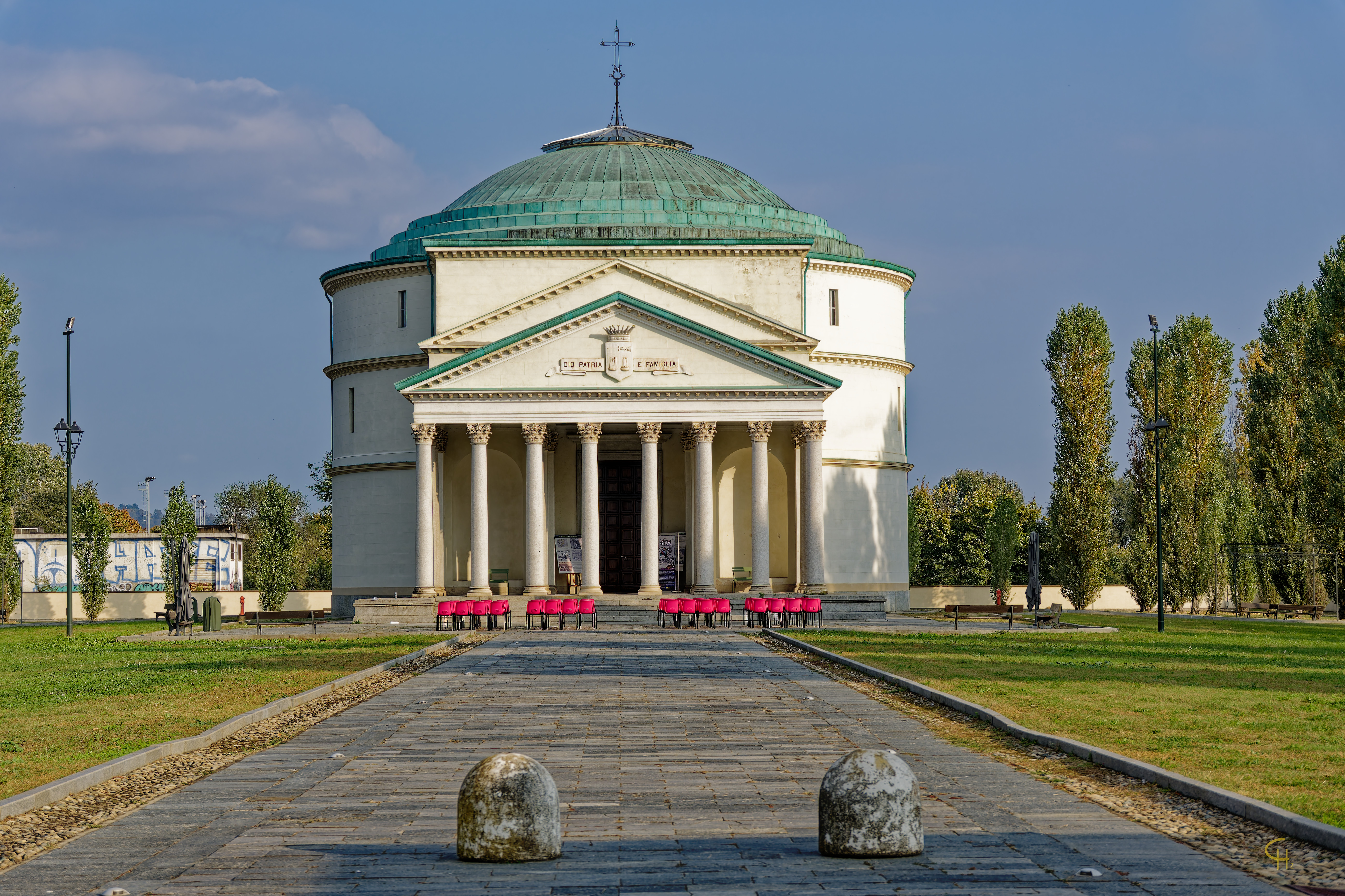

    First shot after picking it >>> "Béla Ròsin" Mausoleum - Countess Rosa of Mirafiori
    Béla Ròsin [beautiful little rose - from Piedmontese] Rosa Vercellana
    - Vittorio Emanuele II. [The king from 1848 to 1878 who made an independent, united Italy]
    She was a commoner who casually met the King.
    The king fell in love, agreed with his official wife not to live with her anymore. After years, he resigned official court to live as a retiree with Rosa.
    She was beloved by the people, as was Vittorio Emanuele II
    Savoy never accepted her:
    at her death at the age of 53, they didn't agree to bury her body in the Savoy tombs,
    at Pantheon in Rome near VE II, nor in the Sacra di San Michele
    The king's and her's sons built this mausoleum for her [1890]

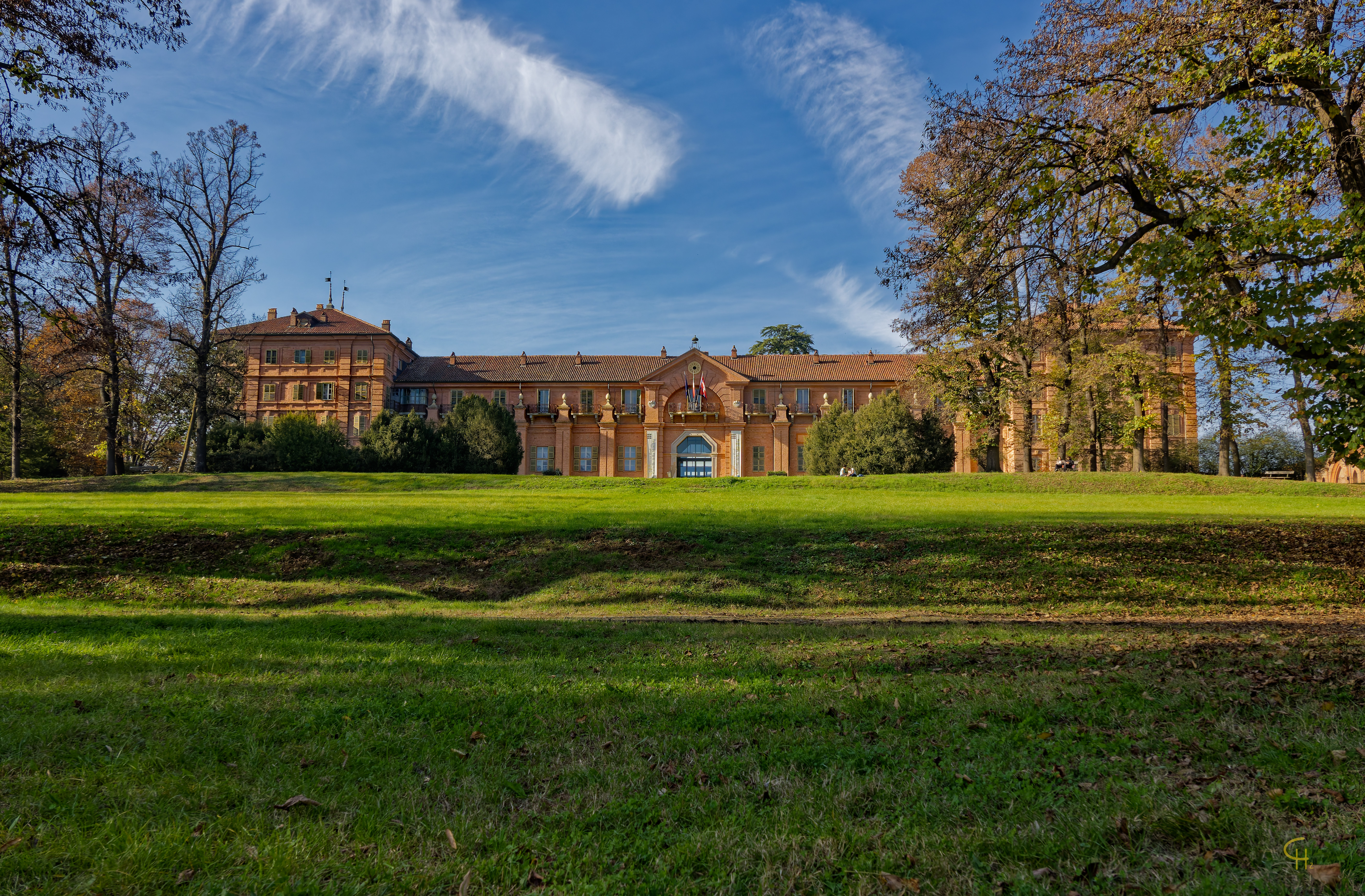

    The king built for them to live togheter this Castle 10km away from the official Venaria Reale Castle [Similar to Versailles]
    2024 Z30 + 18-30 shot
