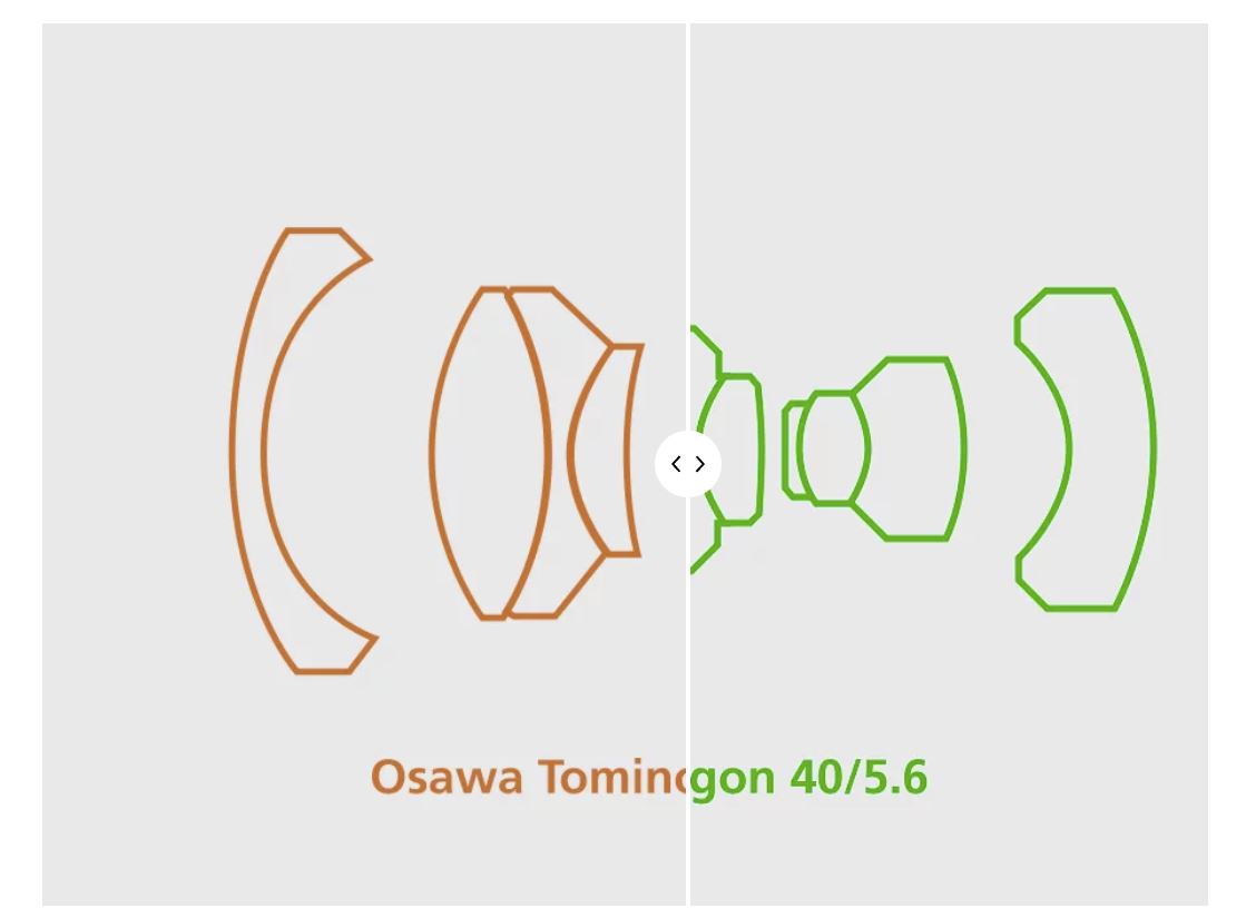

    Wow - thanks! What a fantastic site! Quite a lot of work assembling that. Will have to take a closer look what it covers, but it seems very impressive. I'm trying to incorporate some information about lens designs into my upcoming articles as well. I found sliders to be an interesting tool in order to compare different lens designs. It's nowhere near scientific (like Bill Claff's offerings for example), but fun to get an impression how similar/different the lenses in question really are.
    I'd love to try a Culminar 85 mm f/2.8 by the way, even though that design can't be called a Triplet in my opinion... it has 4 elements after all. Some lenses were called "Dreigliedrig" (three-membered) in German patents, where they're talking about three groups, not elements. Stumbled upon that curiosity while looking up Agfa stuff.

    This slider does not work in my browser. Could you, please, post two single pictures to compare?
  • Members 1947 posts
    Dec. 8, 2023, 4:37 p.m.
    Sorry - I didn't clarify... That's just a screenshot of the slider. Of course it doesn't work. It's just meant as an example how it will be portrayed in the final (Tomioka) article I'm working on. You'll find a couple of those (however none with lens diagrams, as far as I remember) in the existing articles, like here for example:

    Thank you for the clarification! I tried to slide the slider couple of times and nothing happened! So I thought there's a problem with my browser, I could not imagine it was a fake slider.😅
