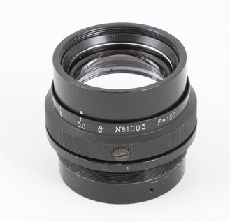

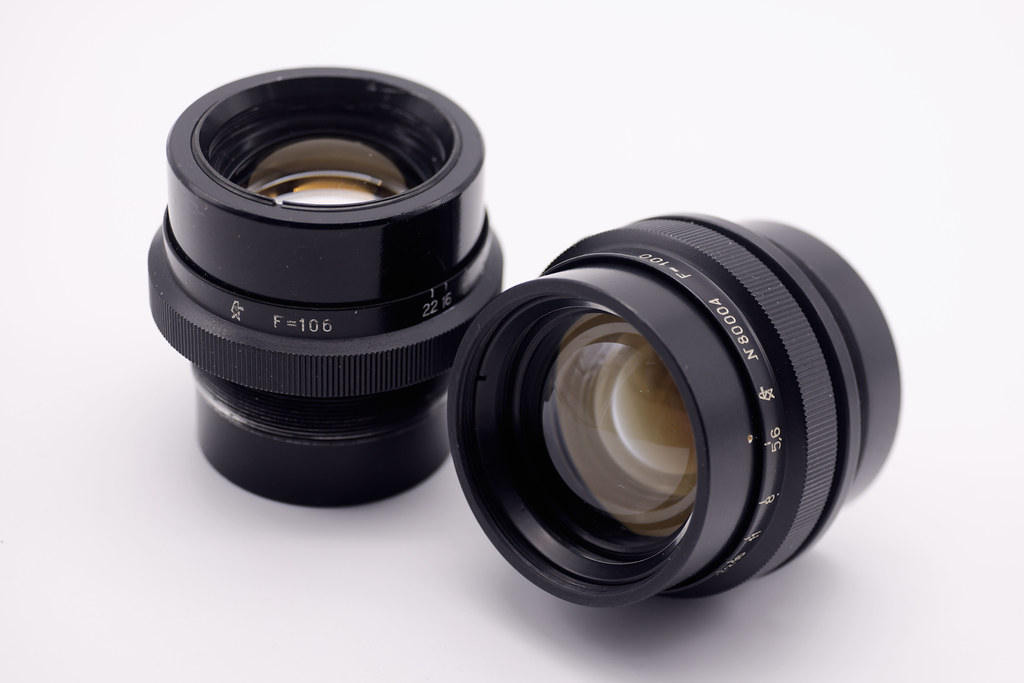

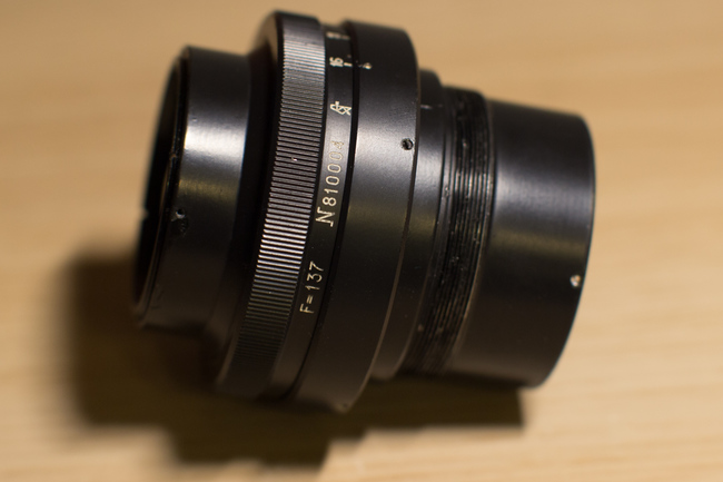

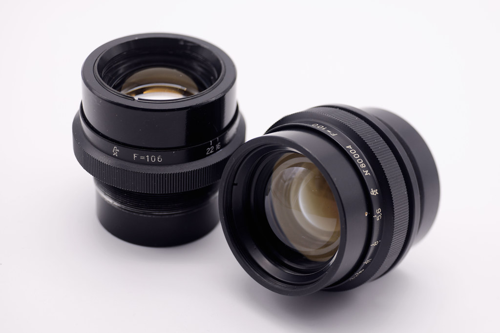

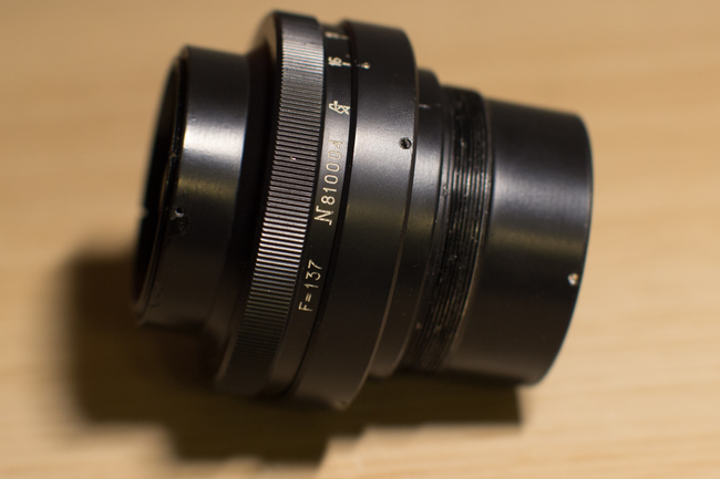

    Are you also familiar with one of these lenses?
    JPG, 69.5 KB, uploaded by simplejoy on June 28, 2023.
  • Members 976 posts
    June 29, 2023, 1:06 a.m.

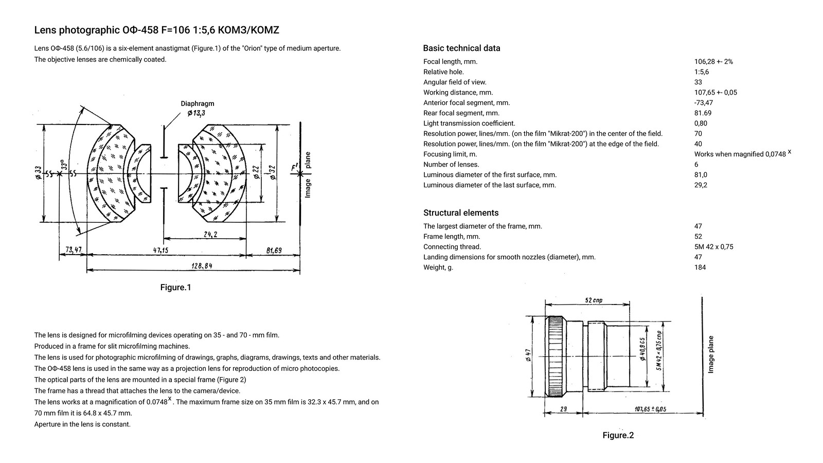

    I know of only one KOMZ (going by logo) 106 mm lens "Orion" (Paul Rudolph's Plasmat) OF-458 / Орион ОФ-458 106/1:5.6 fixed aperture. It was not a big deal to install a variable aperture into this lens. Sometimes it was marked as "100". Could be it
  • Members 1759 posts
    June 29, 2023, 7:41 a.m.
    Many thanks - sounds very likely! The OF-458 was actually the lens a fellow flickr user suggested. He even translated the page he found for me to read:
    But when I had a conversation with Pierre Tizien about it, he doubted the possibility because of the fixed aperture. I didn't know that installing an aperture was a possibility and wouldn't have suspected it, because both of these lenses felt very well made to me, not what I would have assumed from a modified lens.
    I even got an PDF from this book or a part:
    I think it is from David Volosov, but I assume perhaps not the latest version.

  • Members 976 posts
    June 29, 2023, 11:16 a.m.
    This is Yakovlev's lens catalogue part 1, supervised by Volosov, printed in Vavilov State Optical Institute (GOI / ГОИ).
    OF-457, factory-modified:
    OF-458, third-party modification:
    PNG, 80.2 KB, uploaded by IliahBorg on June 29, 2023.
    JPG, 88.0 KB, uploaded by IliahBorg on June 29, 2023.
    June 29, 2023, 6:46 p.m.
    Thank you very much - that‘s exactly it! I really appreciate it, now I finally have an answer to that question. So it‘s yet another microfilm recording lens. I have quite a few of those (like the Zeiss Dokumars for example) and all of them are pretty good.
