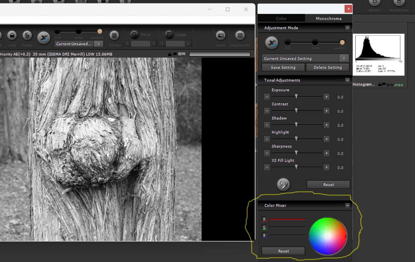

    Here's the color wheel in monochrome Mode from Sigma Photo Pro V.5.5.3 with 100% red layer selected, no adjustments:

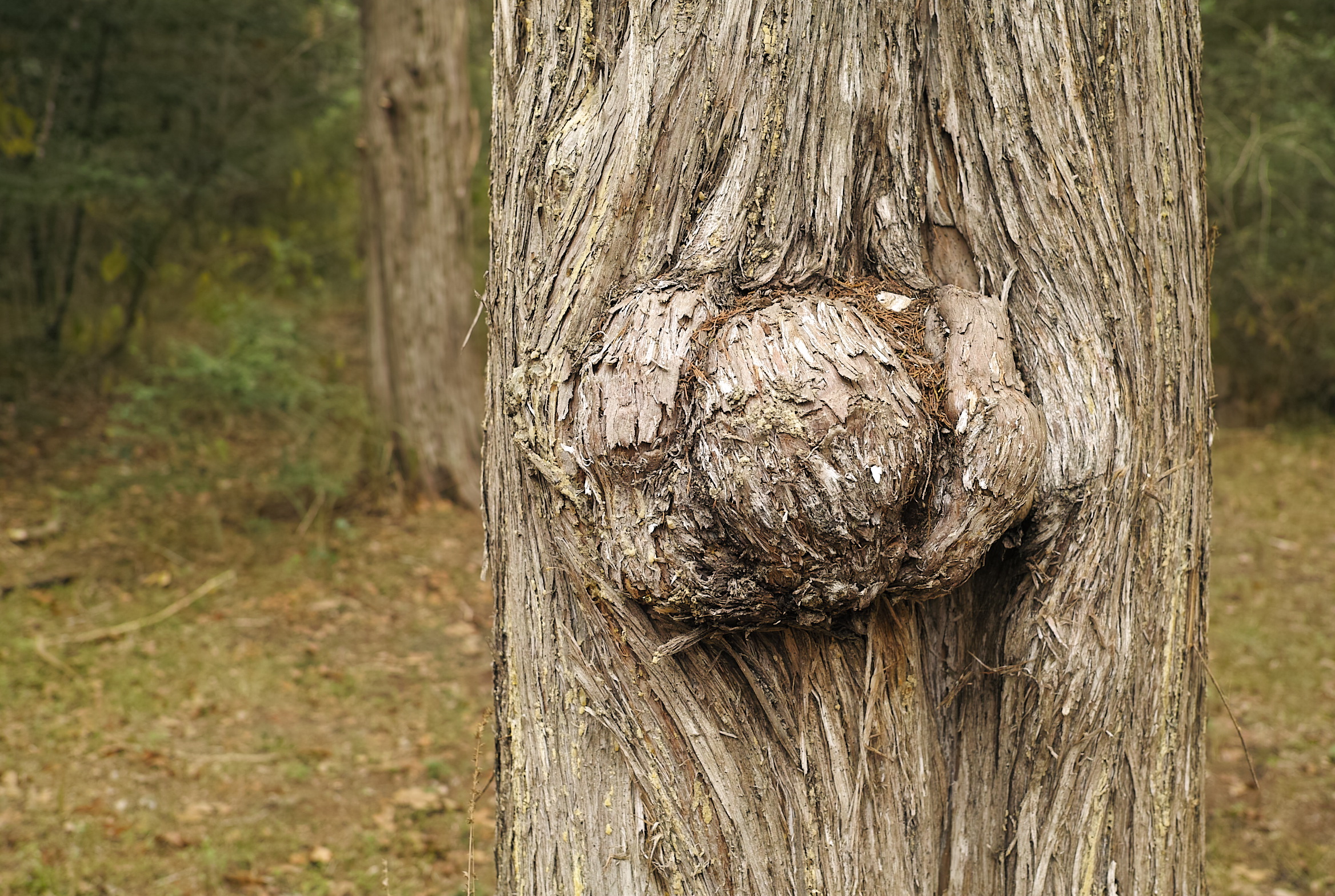

    Here's the embedded JPEG with no adjustments:
    Here's the embedded JPEG desaturated in the GIMP, 'luminance' method, no adjustments:

    Be careful - SPP also has a monochrome setting under 'White Balance', I'm not talking about that.
    I'm talking about the Monochrome Mode which is selectable at the top of the 'Adjustments' dialog in the 'Review' window ...

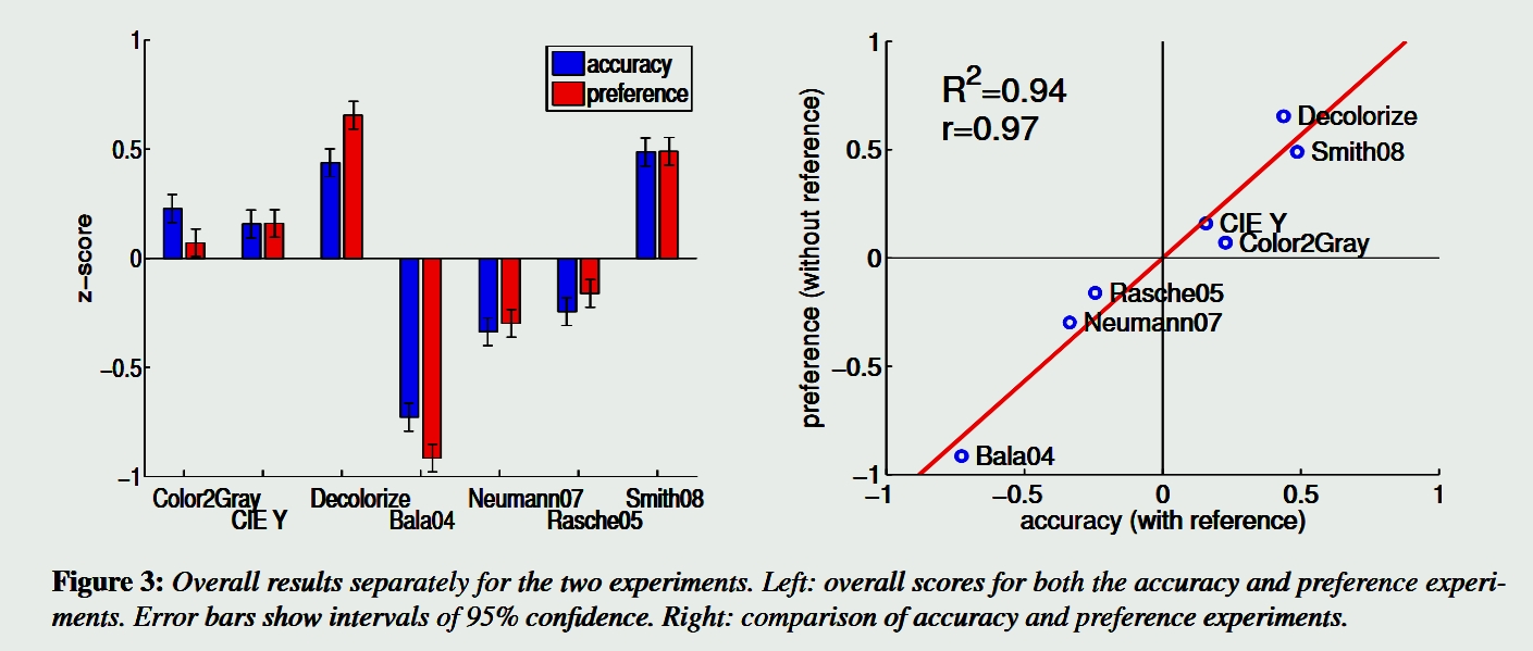

    From the said Work the image on the right below appears against the tested color image:
    Some sort of statistical plot, well above my head ... what are "r" and "R-squared", anybody?
