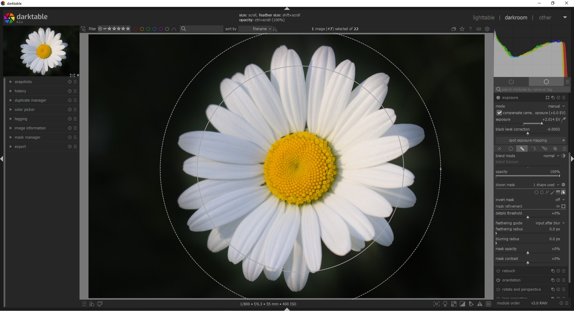

    I'm slowly learning darktable.
    This is my first attempt using a mask - this is just a simple "circle" exposure mask.
    I'm pretty primitive with darktable... I think I'm slowly improving, though.
    JPG, 109.3 KB, uploaded by Dunlin on April 12, 2023.
    JPG, 244.7 KB, uploaded by Dunlin on April 12, 2023.

    I usually use the combined parametric and drawn masks button, even if I just using drawn masks. I find the path tool very useful, it lets you draw complicated shapes, then use the feather slider to blend the mask in. The display mask button is helpful for reminding you where your masks are. The alt key is useful when you click on a mask tool. It allows you to create multiple masks without having to repeatedly reclick a mask tool icon every time.
    You can also combine masks in complicated ways using the mask manager on the left panel of the darkroom tab. It lets you do things like intersect two masks so the module only applies to the intersected area rather the whole masked area.
    I also like using the drop down list labeled "No mask used". This keeps a list of the masks you have created so far and lets you re-use a mask drawn in one module in another. For example, your mask above might be used in the exposure module to darken the whites of the flower. Then you might want to use the sharpen module but restrict sharpening to the flower. In the sharpen module if you click on "no mask used" drop down, you'll find the first mask you created listed there. You can select it and re-use it to restrict sharpening. Quite handy when you want to apply several modules to the same place and saves on redrawing the same mask in every module.

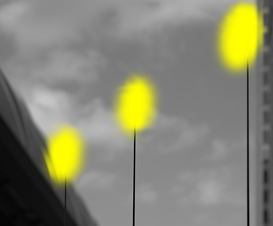

    Here's a simple example of my own:
    This image has very shallow depth of field. Only the light stick things are in focus. There is no value in sharpening the majority of the frame because is it not in focus. So no global sharpening used. Instead I used drawn masks, the oval tool and feathering to smooth the mask. I placed 3 oval masks over the sharp bits and applied sharpening through the masks.
    To create 3 separate masks, control click the oval masking tool rather just clicking it. That allows you to create more than one mask. The feather applies to all three. In most cases the mask doesn't have to be accurate because the feathering smooths the edges. Tip: If you mess up, click the little arrow icon to make the outlines of the masks show, then position the cursor over the outline of the broken mask and right click to delete it while leaving the other masks intact.
    Screenshot of my masks. Dead simple.
