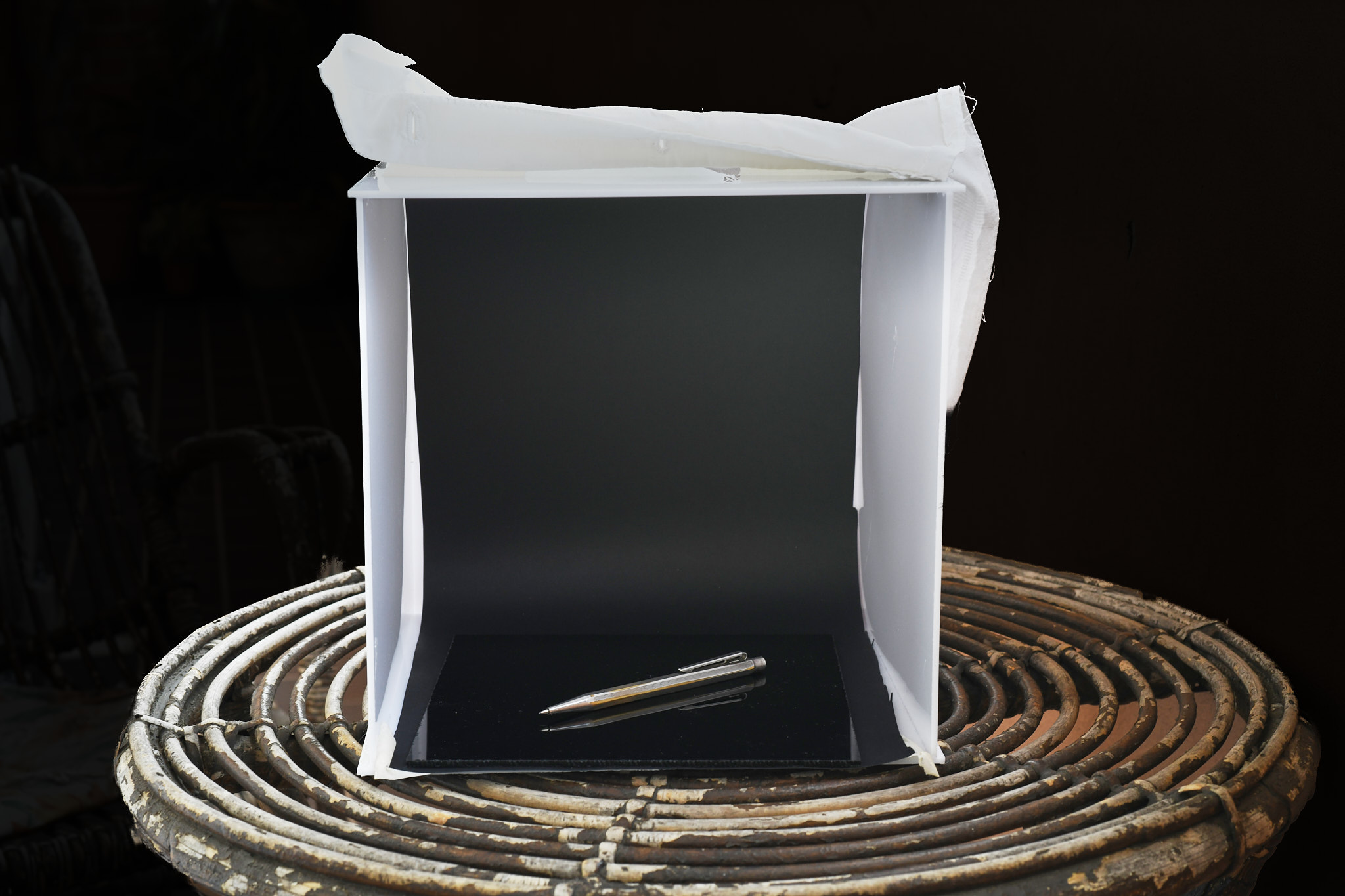

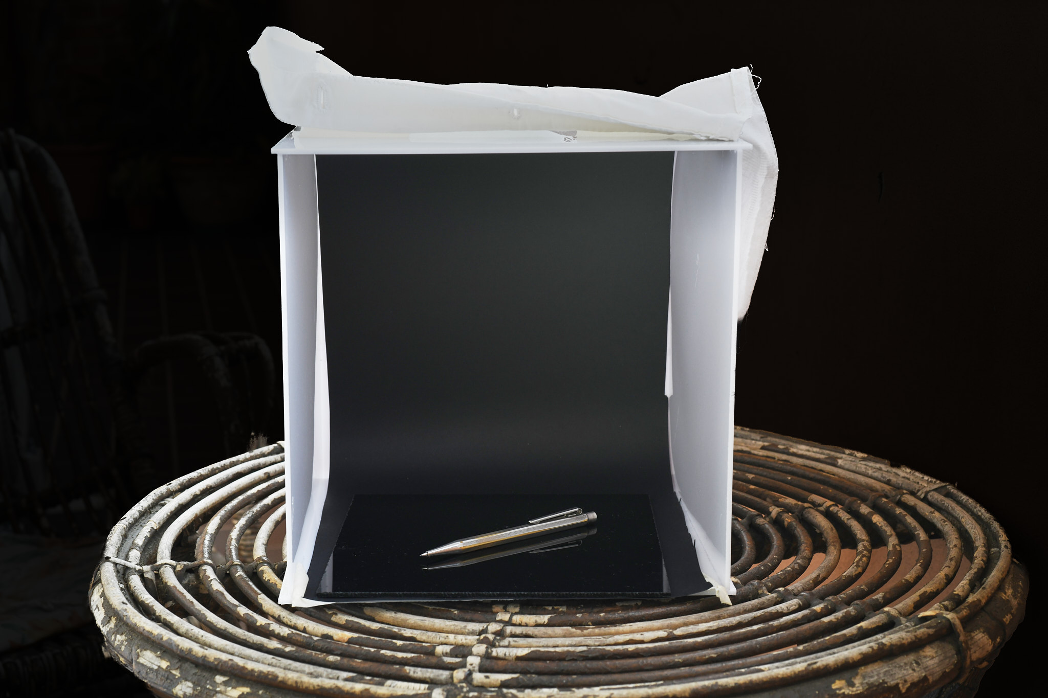

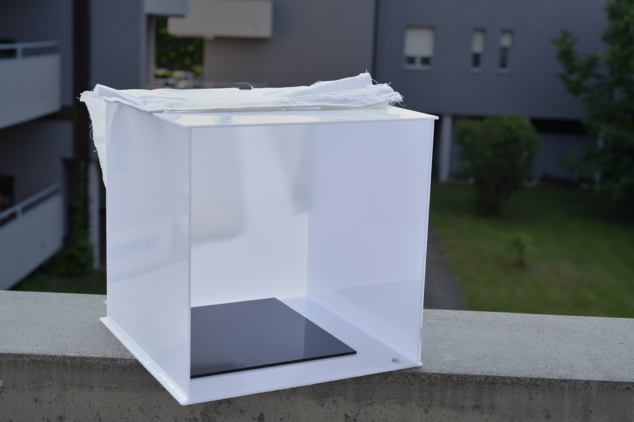

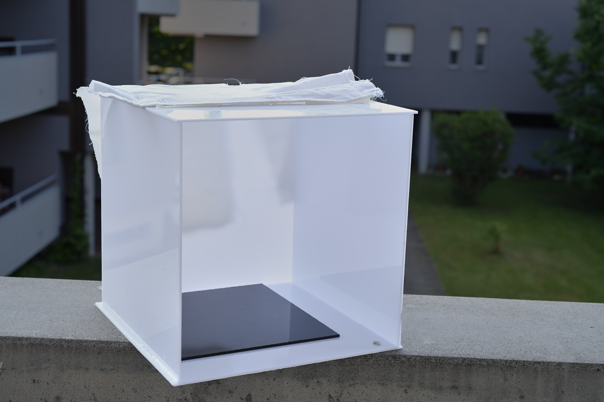

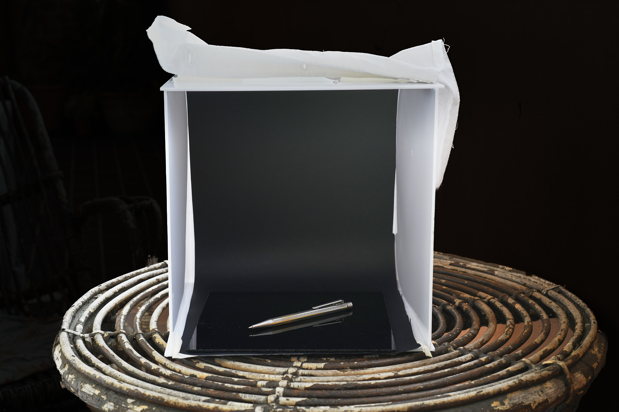

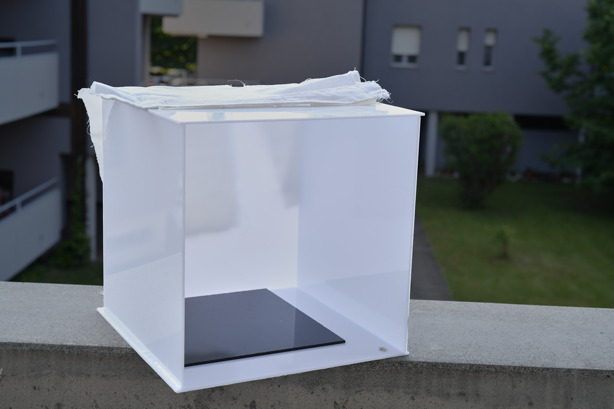

    I bought a collapsible cheap Chinese "tat" light tent which is a pain in the butt. I decided I could do better, and for the grand sum of €17 I bought and had cut to size white translucent plastic squares to make a little light tent for high magnification macro. I think I am going to make a bigger version at a useful size and consign the one I bought to the bin. It took half an hour to put together, with the right glue that the plastic materials dealer sold me.
    I need to get some better fabric for the front. But it works
    260mm x260mm squares cut for the top and bottom and three 250mm squares for the walls I used masking tape to hold it together whilst I glued it together. I used 3mm PVC, maybe 2mm might have been better.

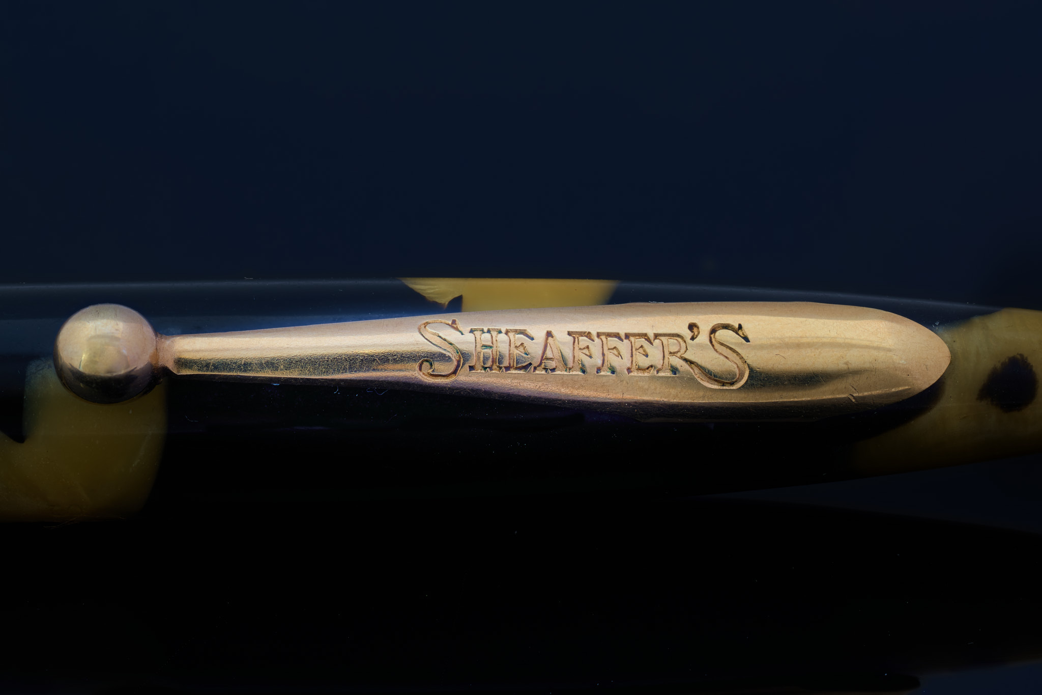

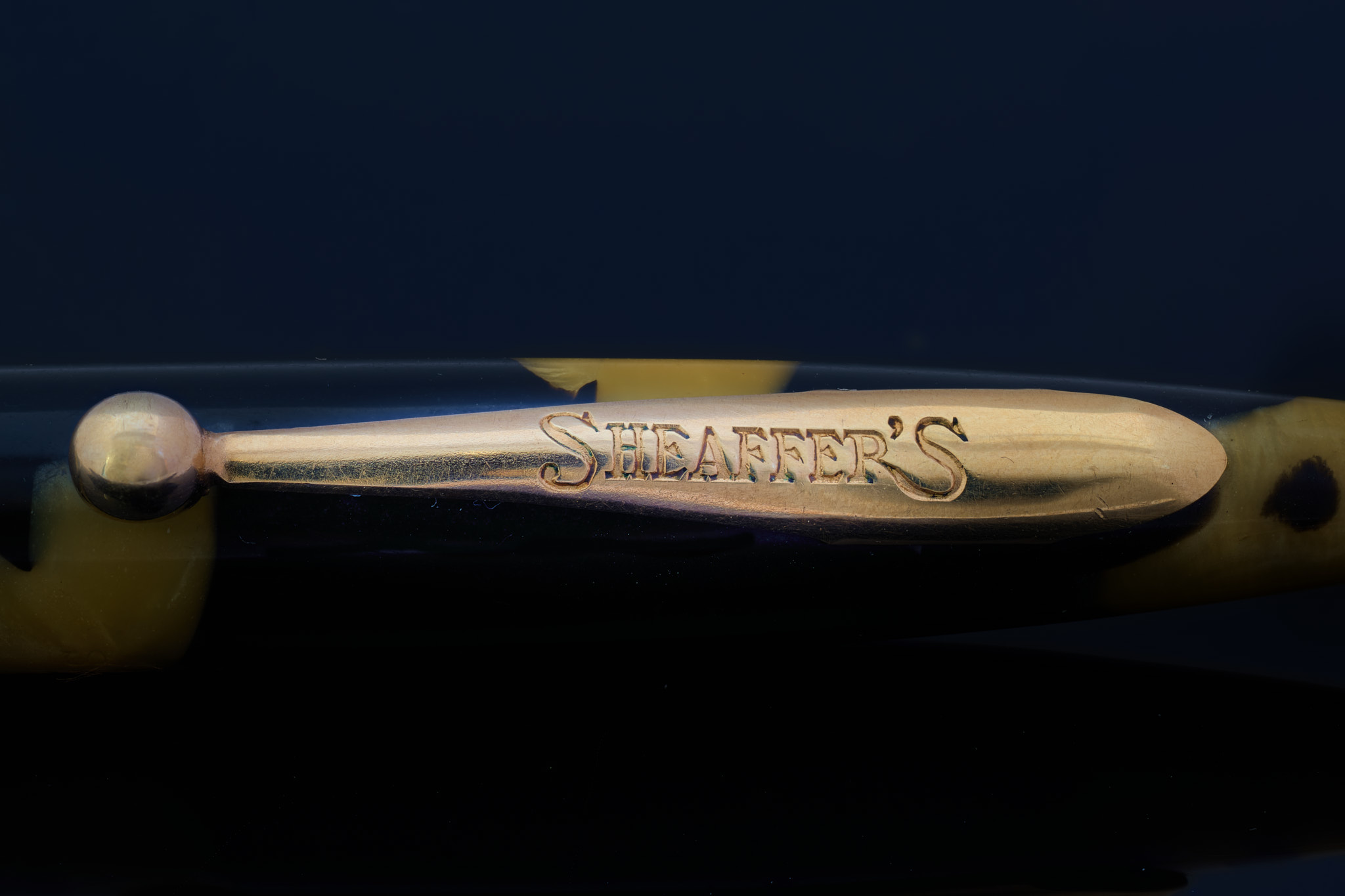

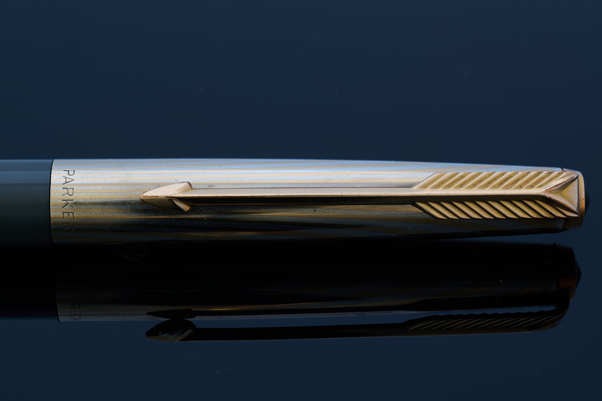

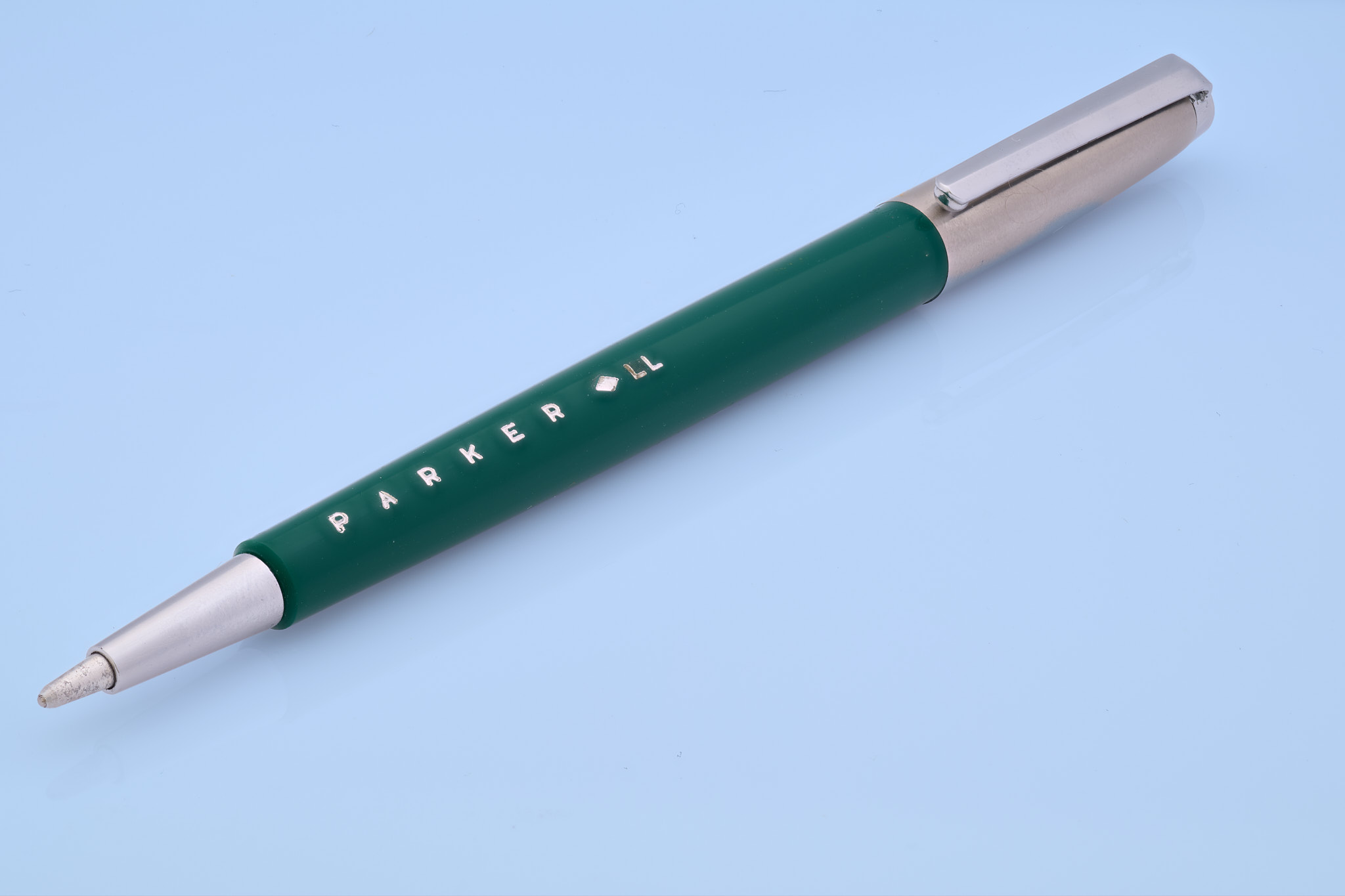

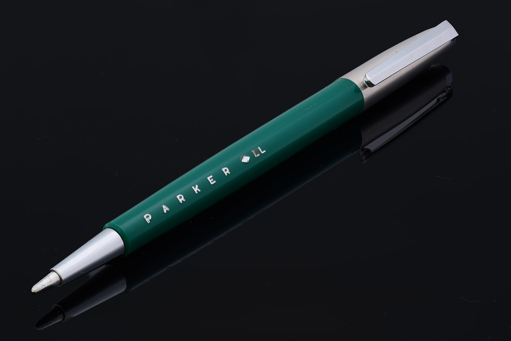

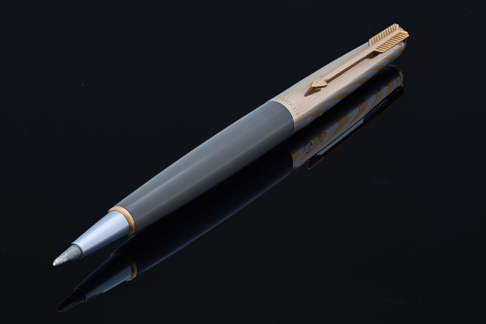

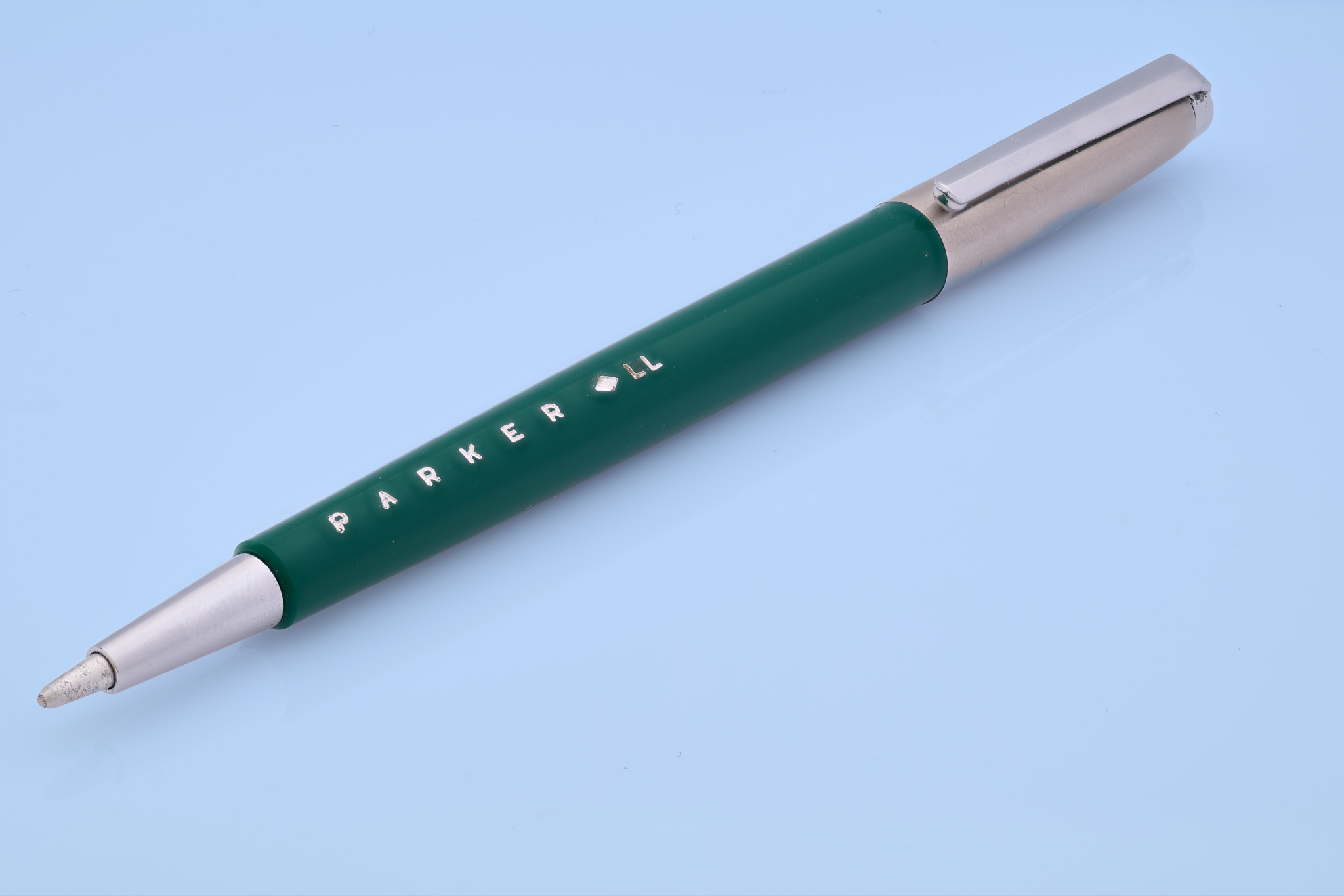

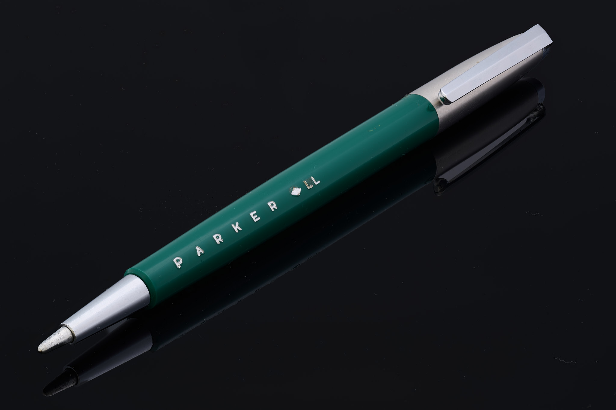

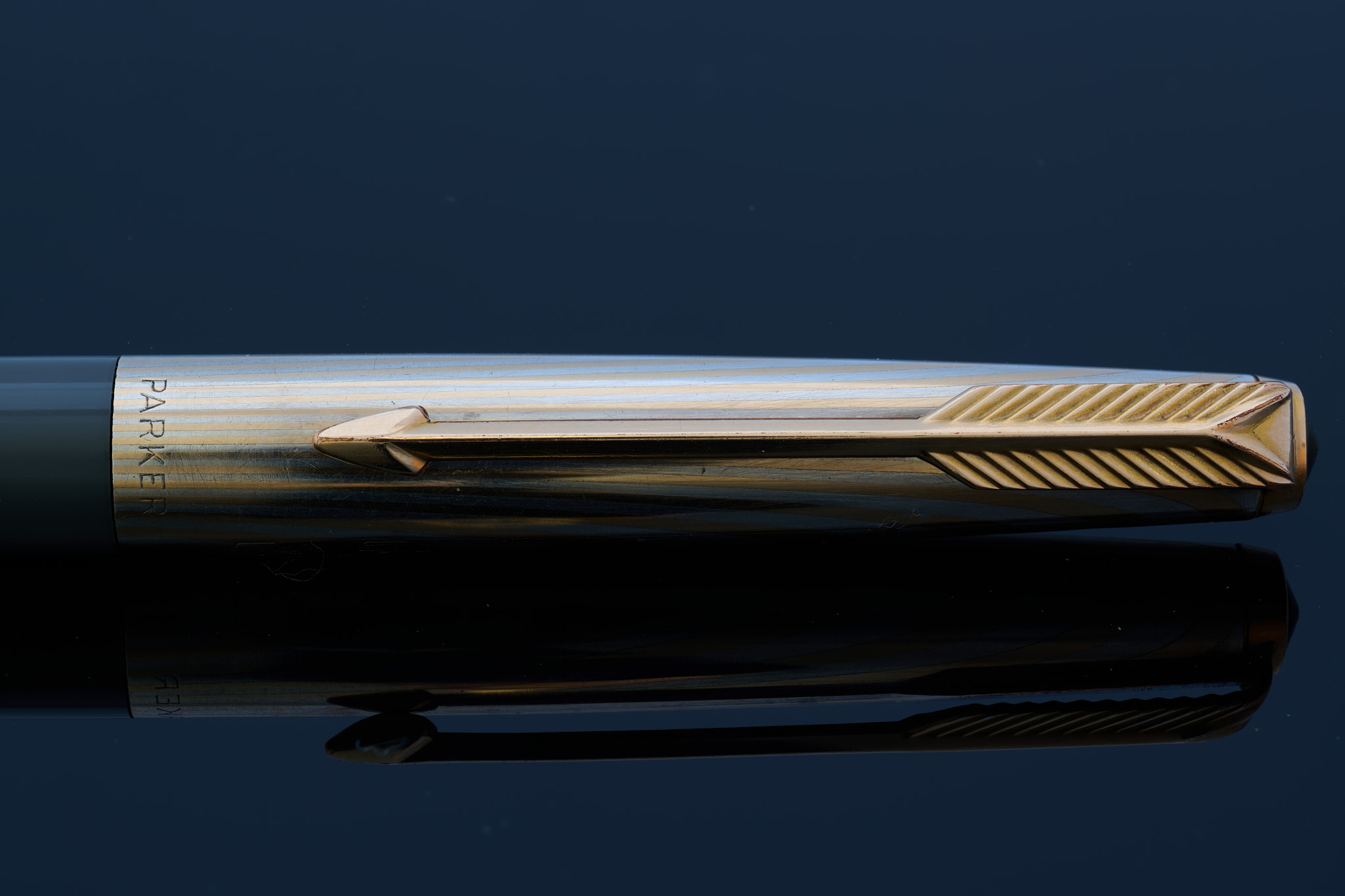

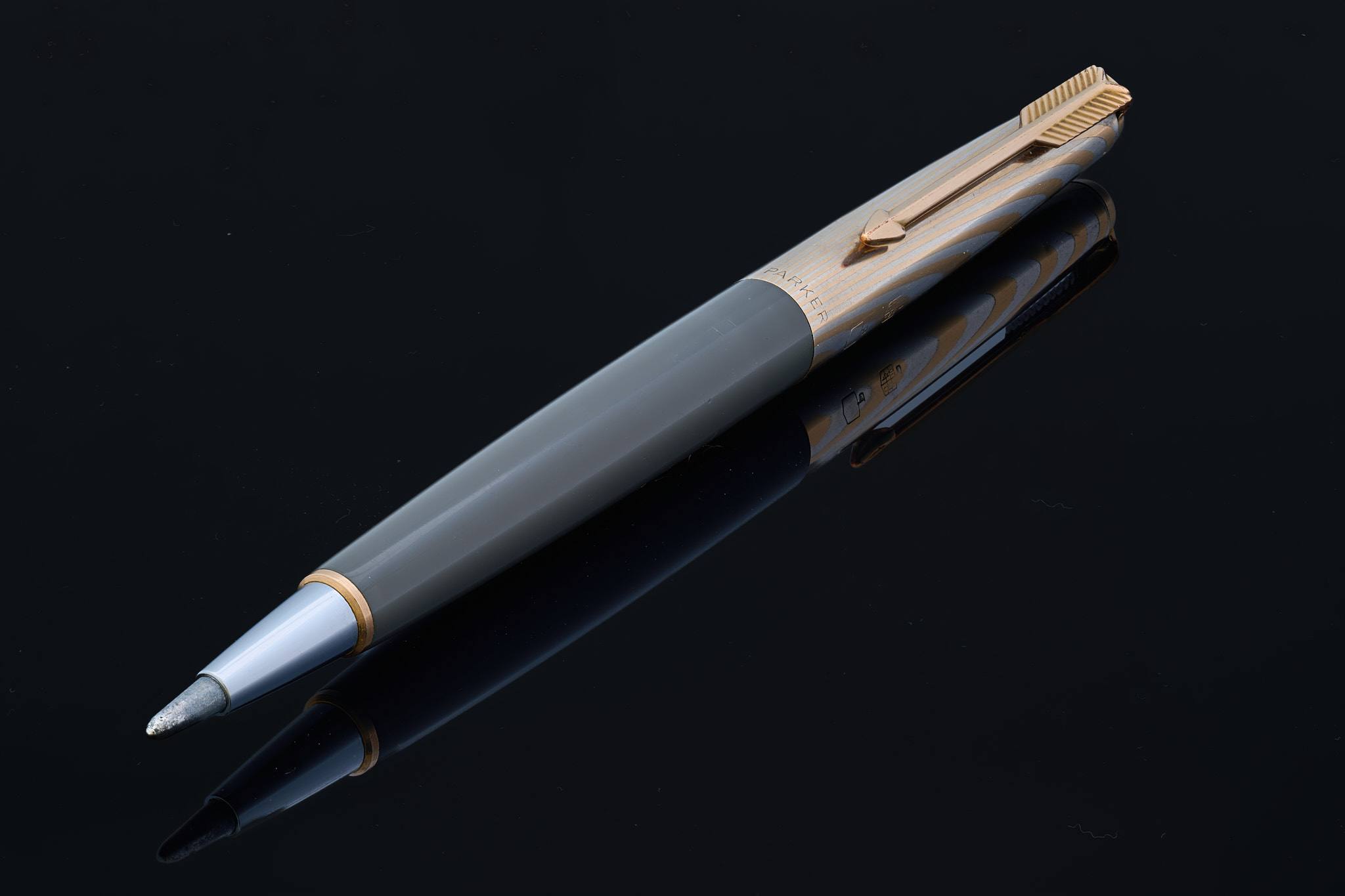

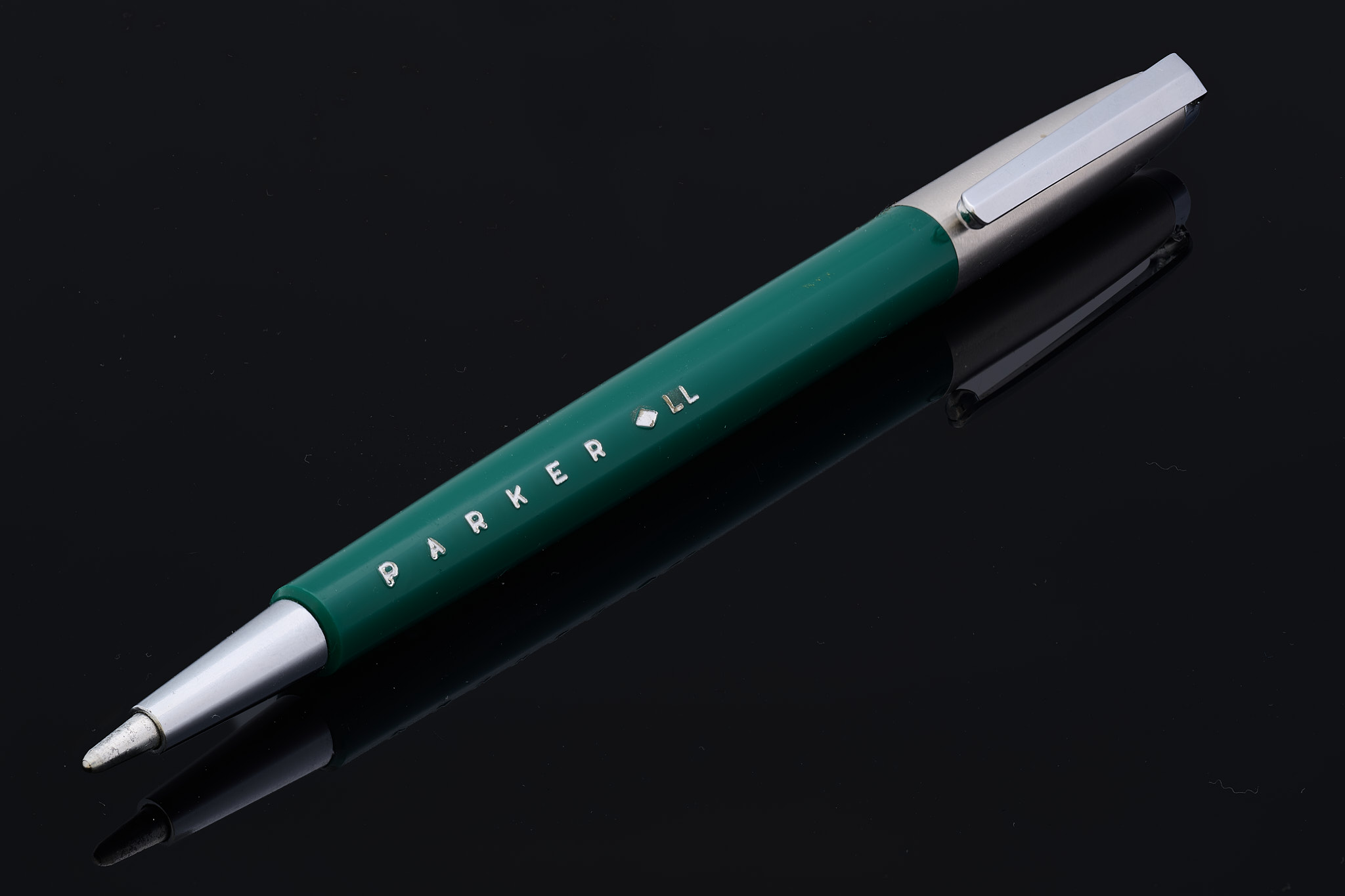

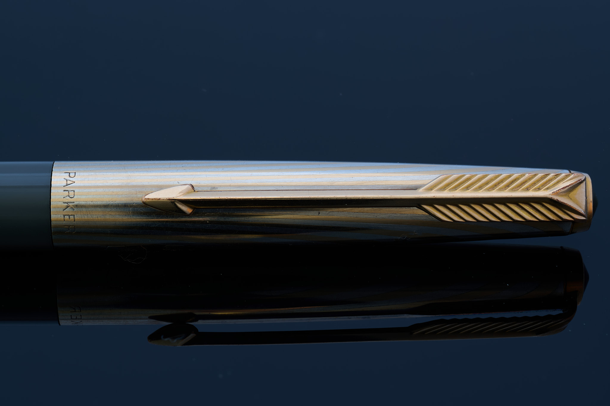

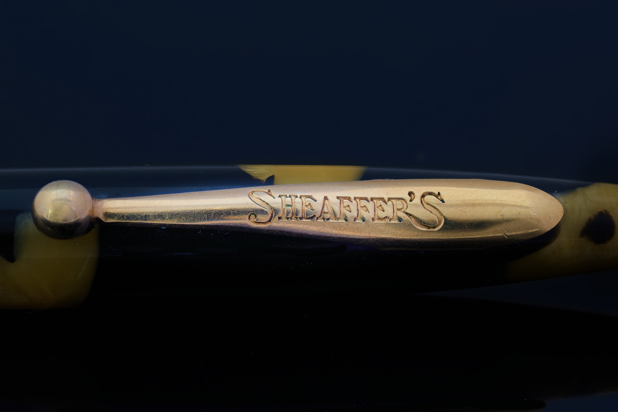

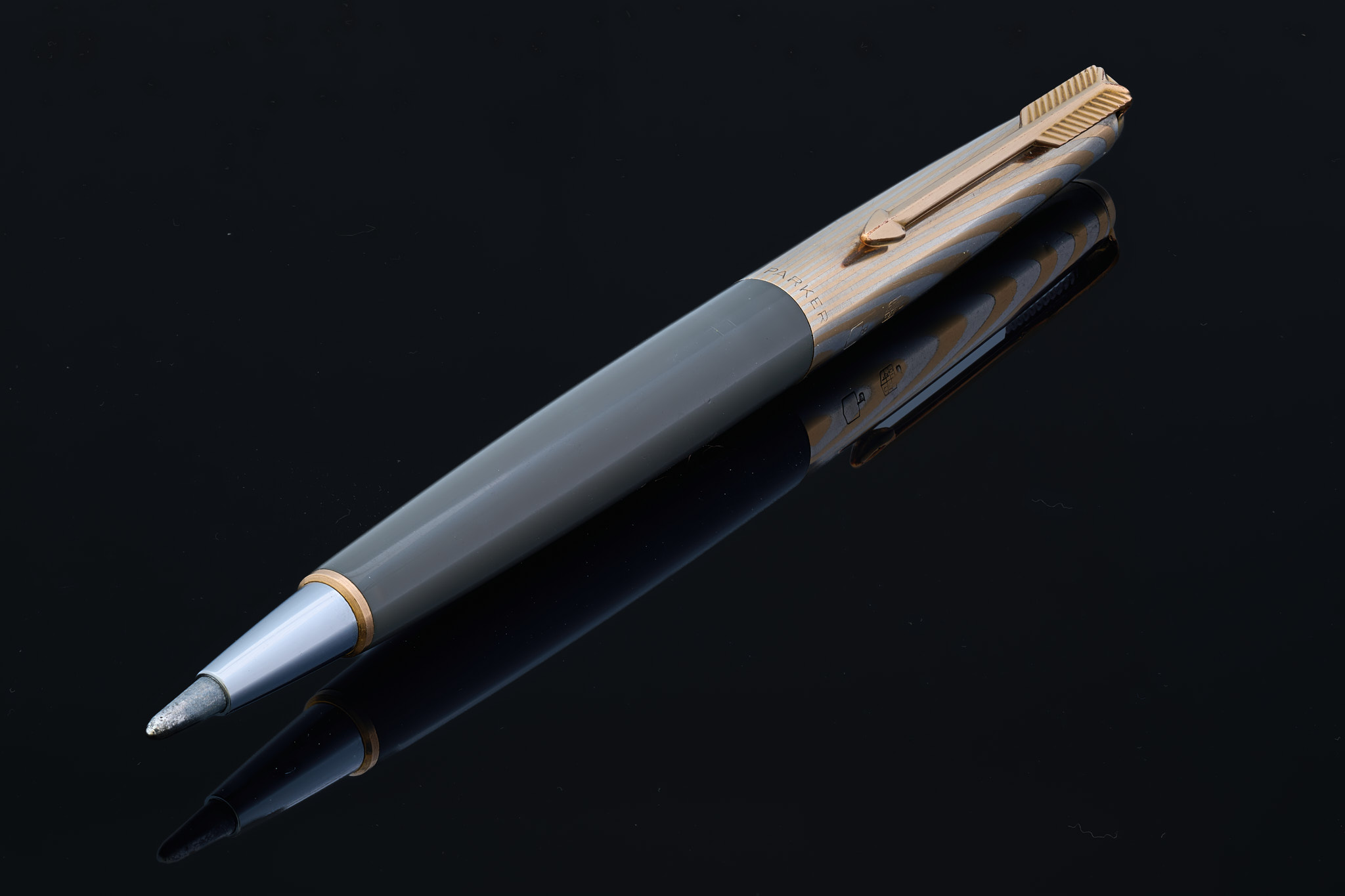

    Here are some examples shot in the little light tent I made in PVC. These are stacked shots using my AiS 55 Macro, with focusing adjusted by hand. The tent is too small for whole pencil shots with the Z105 Macro. Thus the plan for the 400mm cube.

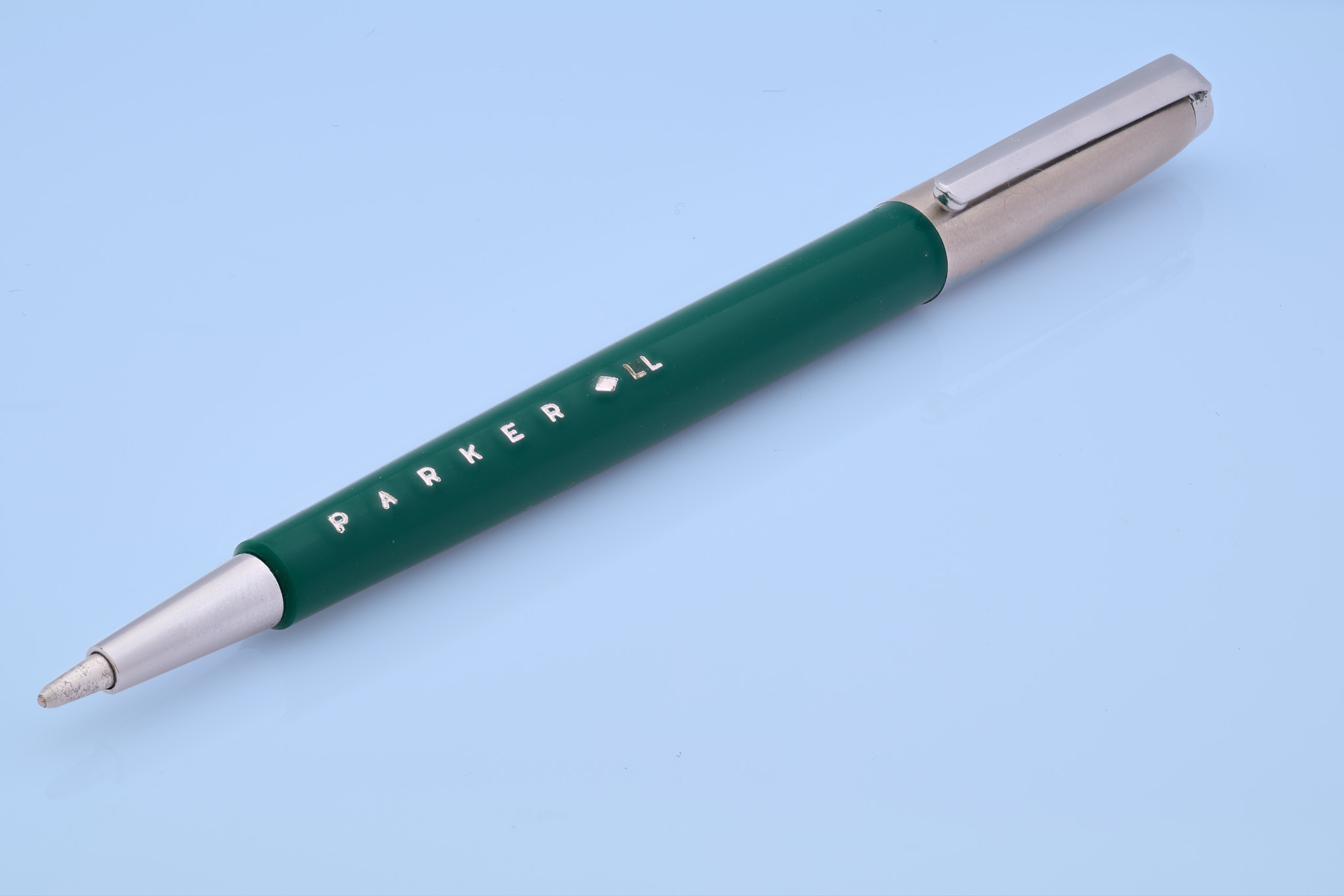

    Good job well done. I used to sell small stuff on-line, coins, jewelry, watches and so on.
    I used two LED flood lamps and made a free-standing 85g A4 tracing paper diffuser for each lamp. The ability to move the lamps separately from the items and to move the diffusers separately from both suited my purpose well:
    Voila:
    kronometric.org/sale/coin/3d/eBayDescDivs.html
