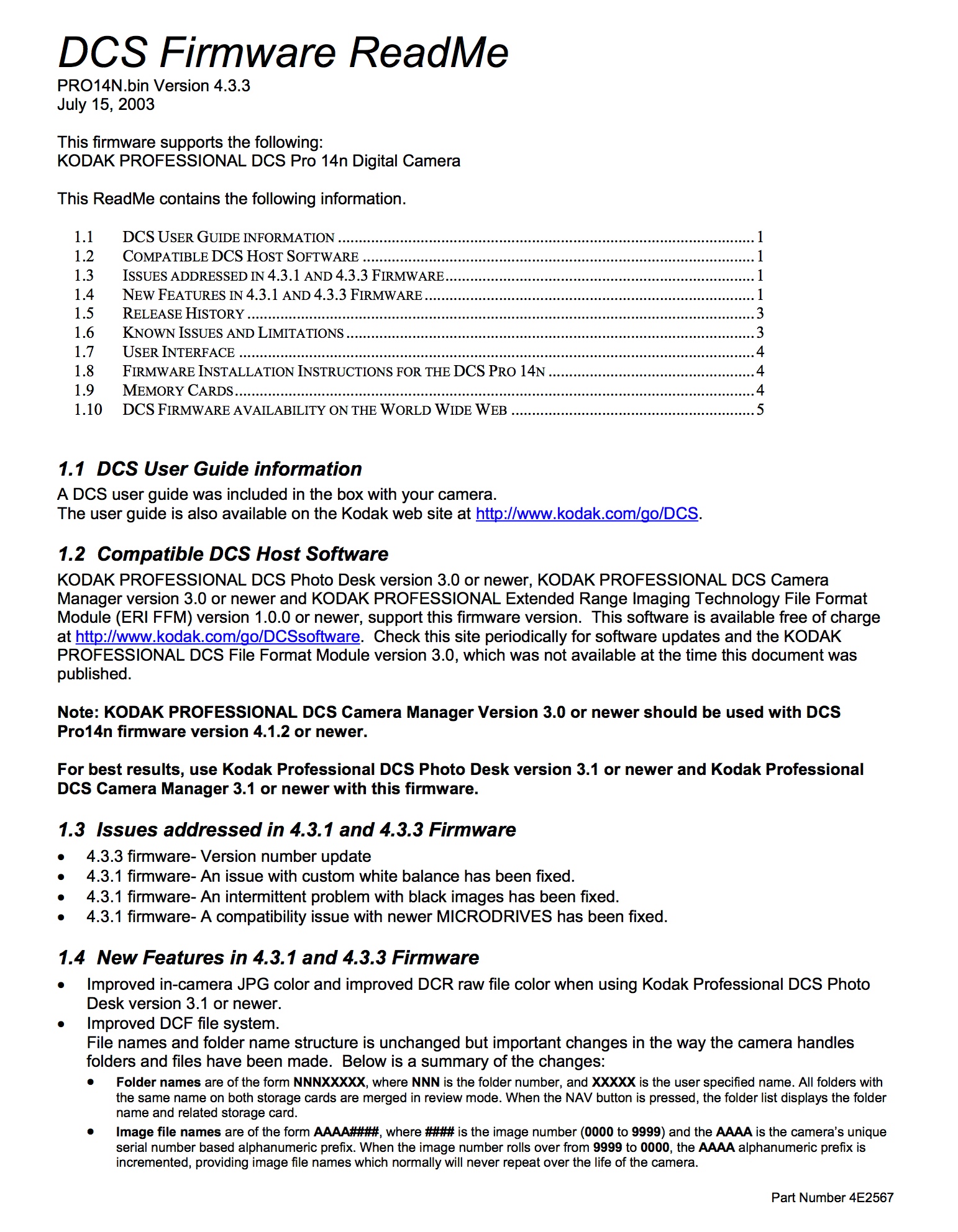

  • Members 42 posts
    April 17, 2023, 2:01 p.m.
  • Members 1752 posts
    April 17, 2023, 2:26 p.m.
    JPG, 980.5 KB, uploaded by Maoby on April 17, 2023.
