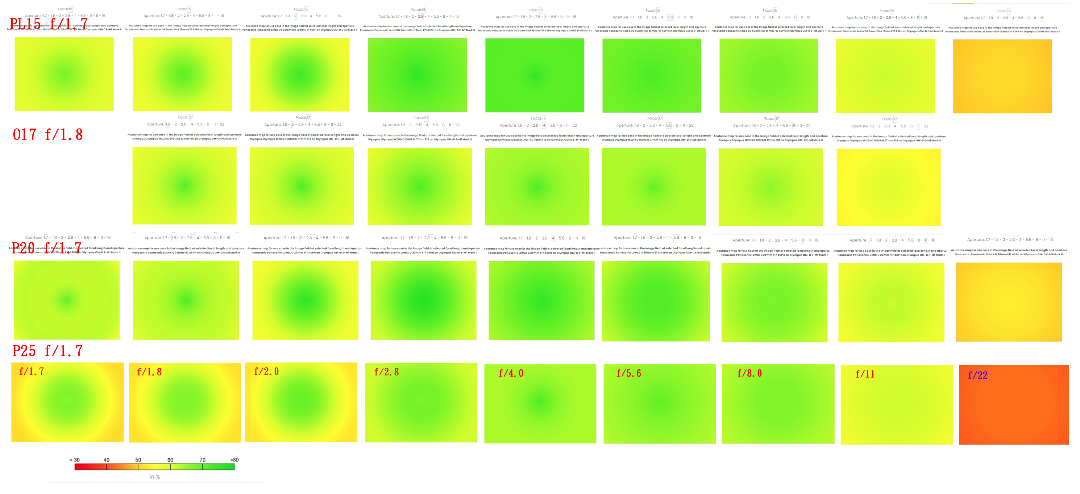

    I guess you are referring to the edge sharpness of 45 I guess you are referring to the edge sharpness of 45 @f/2.8?

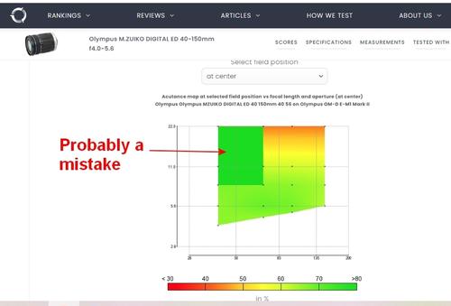

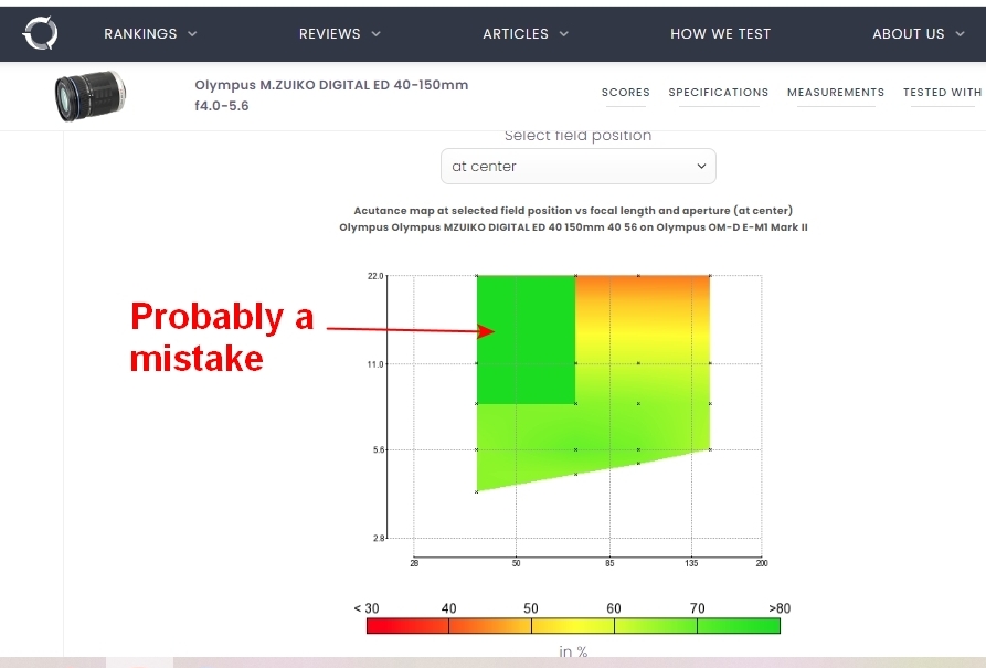

    It is little strange since the field map showed the edge sharpness would be reduced then improved again on stopping down. It could either be the particular lens issue (sample variation) or it was a fault on DXOMark. As per the few lenses on my research, this doesn't happen.
    This happened on some other lens review (e.g. the plastic fantastic O 40-150).
    Next, the 12-40 f/2.8 is a very excellent lens. While it has similar center sharpness of the P12-35, it's edge performance is better especially around the wider apertures.
    In fact, might be of the format characteristic enabling easier lens design, the prime lenses IQ (specially the center) might not have absolute advantage over zoom lenses. It is to say, the IQ of zoom lenses, specially those kit class f/3.5-XX zoom lenses from Panasonic, are not very far behind prime lenses. I would say not the M43 prime lenses bad, just the zoom lenses are outstanding.
    Finally, when I look at the green zone of the field map of M43 lenses, I am impressed. Some of their edge could be not perfect, but M43 lenses have taken lens correction into part of their design. Not sure how much lens correction been taken into account by DXOMark.
    DXOMark has offered great piece of info and on its multiple cameras testing allowing me to compare lenses directly. The down side is a few mistake been there without attention to and it has no more test on newer lenses...
    Lens rental might not offer the level of info DXOMark can provided. I really wish there could be a site having all the goods from DXOMark, Lensrental and OpticalLimit...
