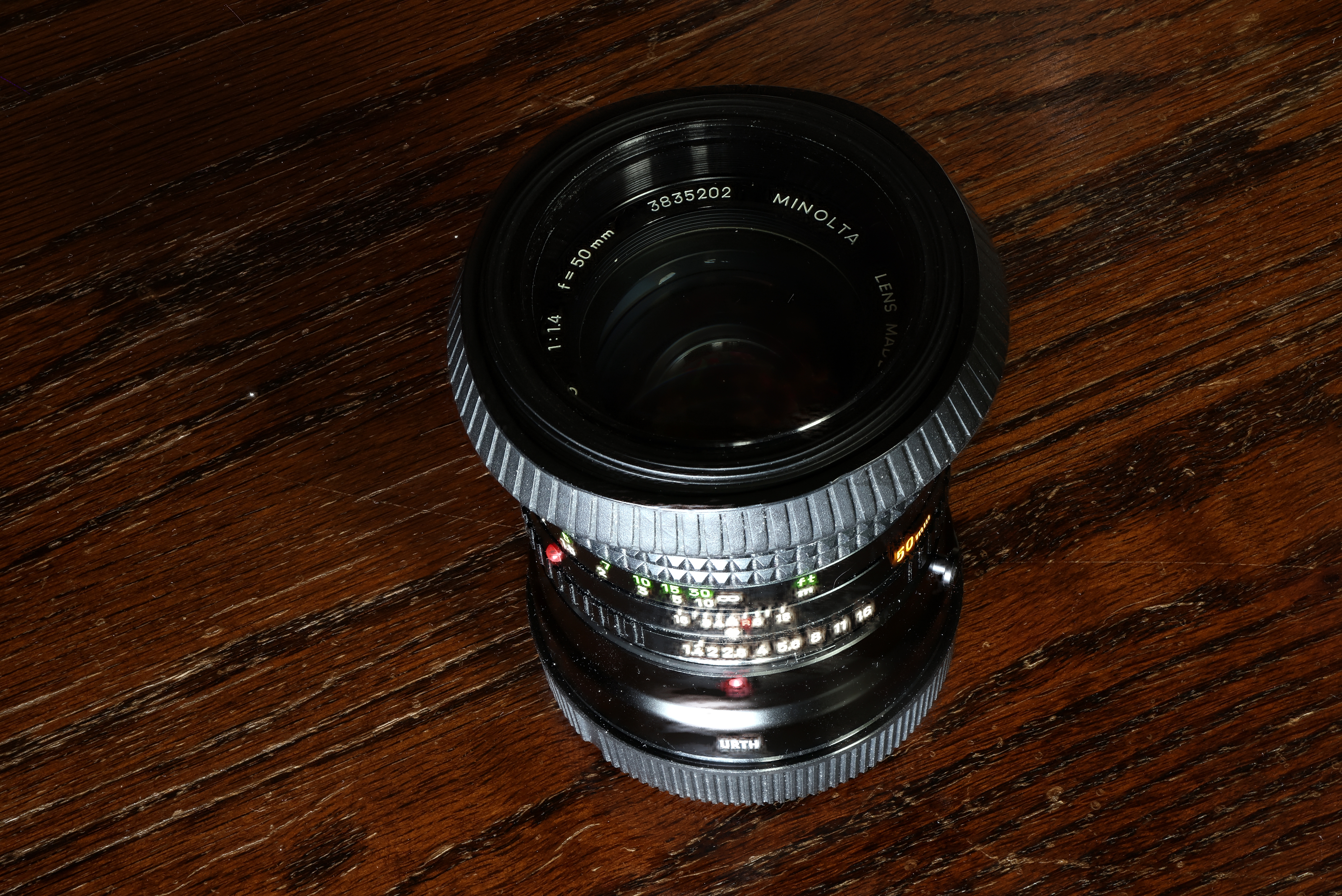

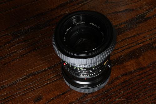

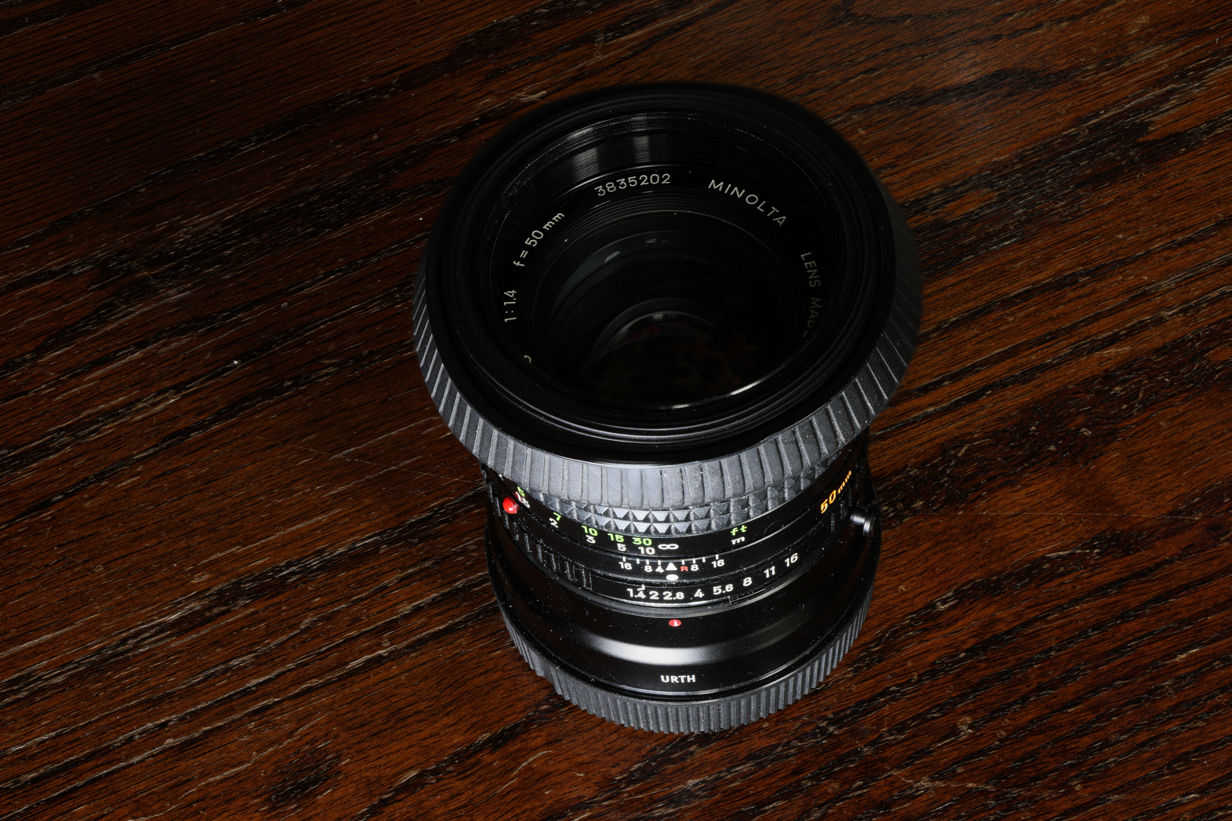

    EDIT: I got in a hurry and put the same image twice
    Thanks for pointing out focus-stack.
    Easy to build from source and easy to run and quickly see results.
    Very quick and easy with focus-stack using SOOC JPEG files
    Canon DPP edit of all of the raw CR3 files. Same recipe applied to all. Canon DPP depth compositing tool took about 45 minutes of CPU time.
    Default cropping for both programs. Camera did the focus increment. Not very good lighting. F/9.0, exposure time 1/5, ISO 320, 56 mm, EF-S18-135mm f/3.5-5.6 IS USM,
    JPG, 10.7 MB, uploaded by JohnMoyer on July 6, 2023.
    JPG, 10.2 MB, uploaded by JohnMoyer on July 6, 2023.
  • July 6, 2023, 5:56 p.m.
    Thanks - another example of a deep stack it's handled well, and pretty similar to DPP. I think it's impressive.

    Thanks again for mentioning focus-stack. I am very impressed with how quick and easy it is.
    I think that Canon DPP does a little better because it is working with the raw files. I edited my earlier post to correct my mistake of including the same image twice.

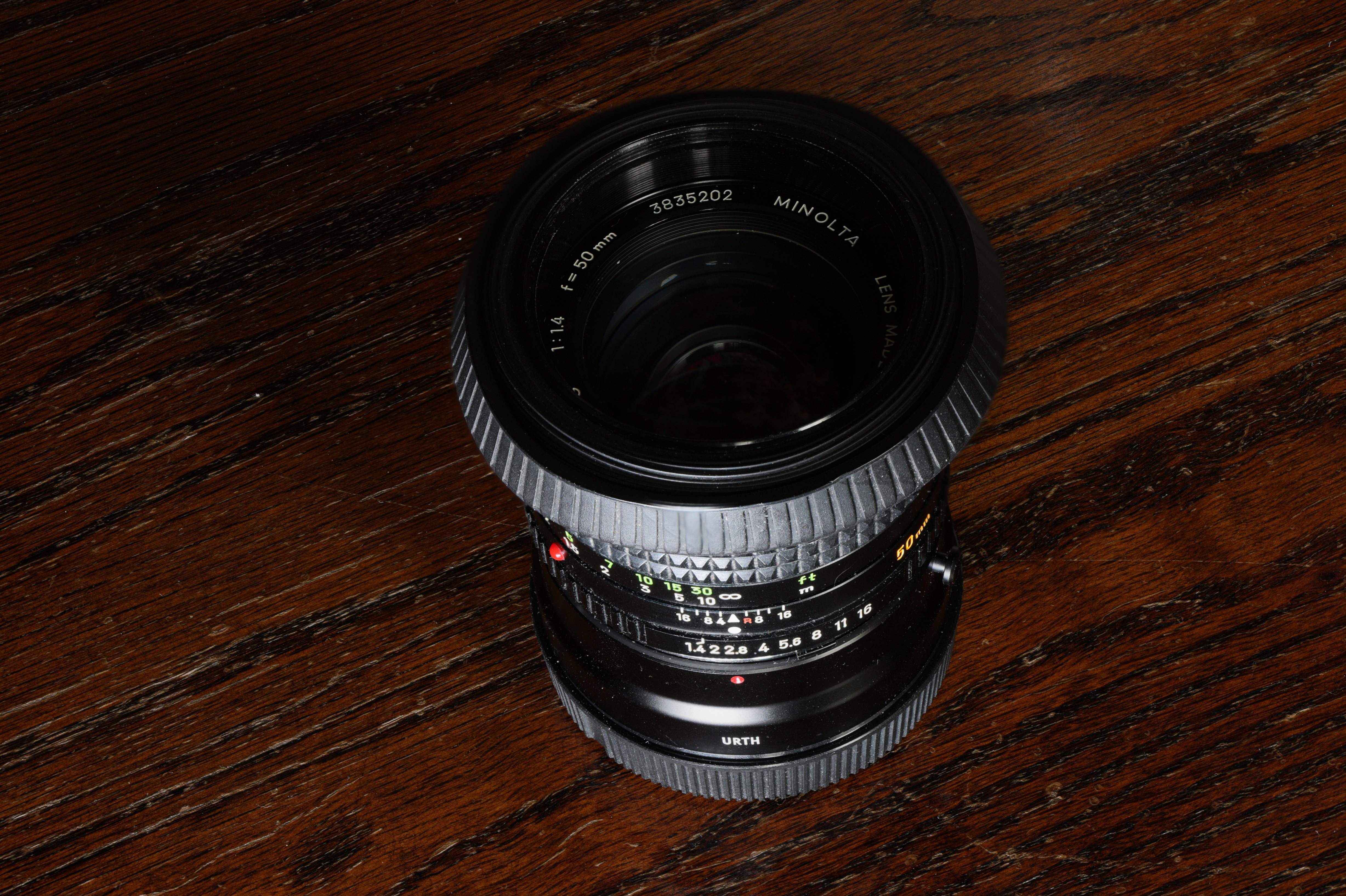

    pushd is a Korn shell function I have been using since 1987, but did not write. Let me know if you want a copy.
    The card reader is on my iMac where I run ksh as my login shell as I do on Linux.
    <pre>
    cp -i -pX  /Volumes/EOS_DIGITAL/DCIM/100CANON/IMG_459[6-9].JPG  /Volumes/jrm_photos/2023jul06_focus-stack/
    cp -i -pX  /Volumes/EOS_DIGITAL/DCIM/100CANON/IMG_46[0-3][0-9].JPG  /Volumes/jrm_photos/2023jul06_focus-stack/
    exiftool -tagsfromfile /Volumes/EOS_DIGITAL/DCIM/100CANON/IMG_4598.CR3 DC_IMG_4596-4635.JPG
    exiftool -"description=Minolta Lens made in Japan MC ROKKOR-X PG 1:1.4 f=50mm, with Urth adapter for use on Canon, depth composite made on July 6, 2023" DC_IMG_4596-4635.JPG
    </pre>

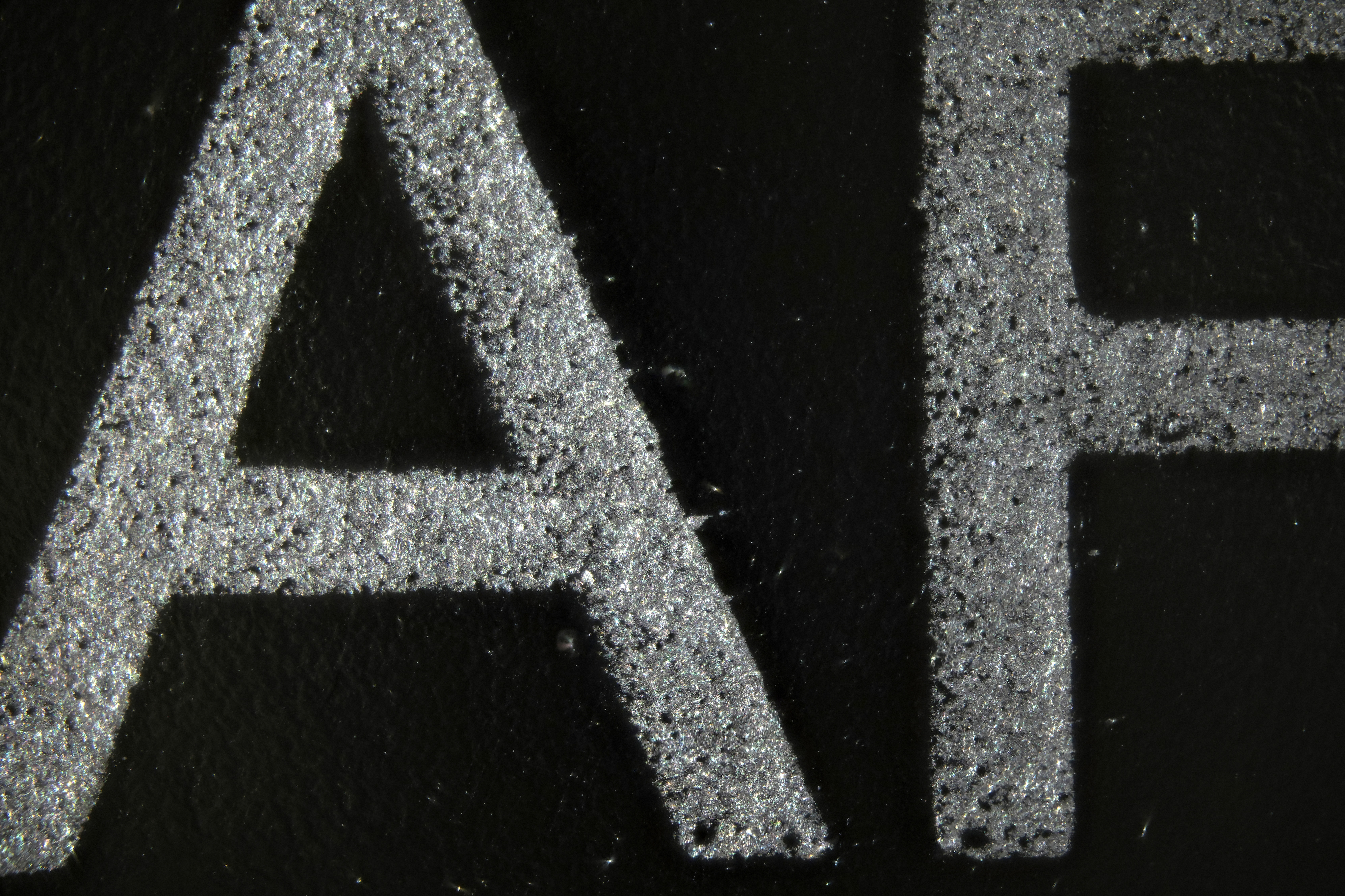

    It appears to me that focus-stack might do better with a larger F Number and a larger focus increment than does Canon DPP. Next time I use focus-stack, I plan to set the focus increment in the camera to the default instead of to the minimum and use a larger F Number.
    An advantage to focus-stack is it achieves a result in seconds which can be viewed while Canon DPP uses 45 minutes of CPU time to achieve a slightly better result.
    A mechanism to move the camera instead of changing the focus on the lens might be superior because it would eliminate some of the changes that a different focus distance introduces. Letting the Camera change the focus distance is easy but moving the camera might be better.
    For example:
