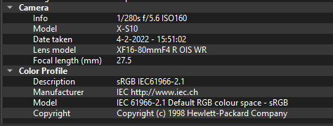

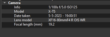

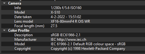

    Morris actually made a good point. The images as attached here report a camera jpeg setting at time of shooting of sRGB in the metadata (exif), but there is no sRGB profile embedded.
    Some viewers or browsers default to sRGB if no profile is attached while others don't. In some others the behaviour is configurable.
    In XnView MP when I choose this setting (do not default):
    The image looks darker and the same as how I see it in these forums viewed in Firefox. Conclusion: Firefox does not assume sRGB when no profile is embedded.
    When I choose the second option it looks lighter. The same lighter look as Windows Photos, which apparently does default to sRGB when no profile is embedded.
    This explains the difference.
    An image with profile:
    The example posted here as well as the one in the dropbox link without profile:
