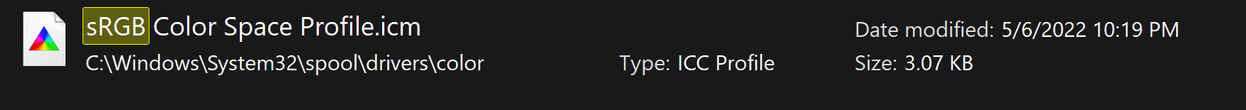

  • Members 1737 posts
    May 7, 2023, 4:25 p.m.
    Why should an RGB profile take up 100 KB?
    PNG, 24.5 KB, uploaded by JimKasson on May 7, 2023.

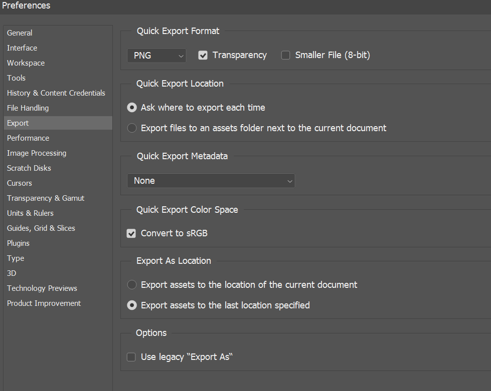

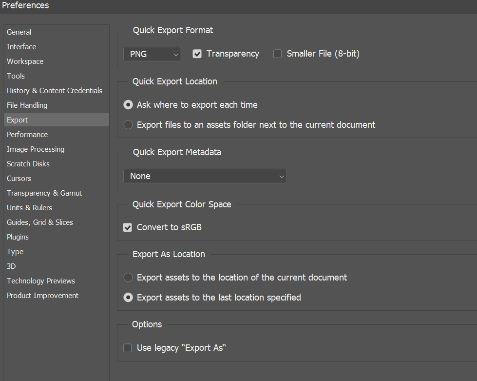

    May 7, 2023, 7:35 p.m.
    I can't figure out how not to embed a profile in Ps:
    PNG, 44.8 KB, uploaded by JimKasson on May 7, 2023.
