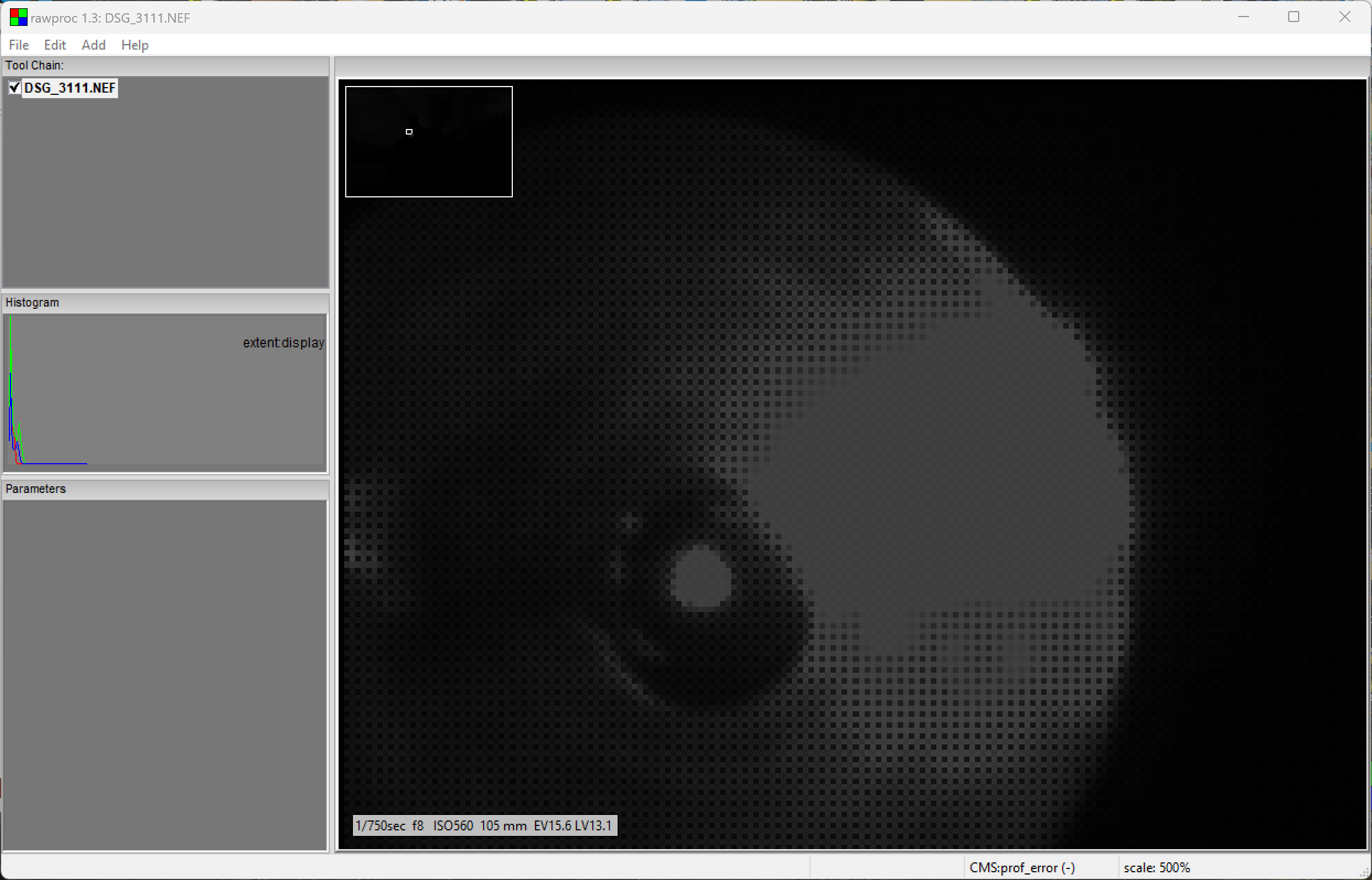

    Yep, here's what NEF raw data looks like crammed into a display:
    You can consider this to be grayscale-mapped light measurements through a bandpass mosaic, further mapped to their lens-resolved position in a scene. Disregarding camera-cooking... 😆
    The histogram effectively shows the 14-bit range from the camera mapped into the 16-bit integer containers of the computer. Bottom-right, 'CMSprof-error (-)' indicates that there is no color management going on, so the image data is being displayed in its 8-bit equivalents on my display.
    This is a 500% zoom to the brightest part of the image, so we'd have something to see. The white region is blown pixels, of a locomotive headlight doing its thing. There is actually some gradation in there, hard to tell as the R, G, and B values are so close.

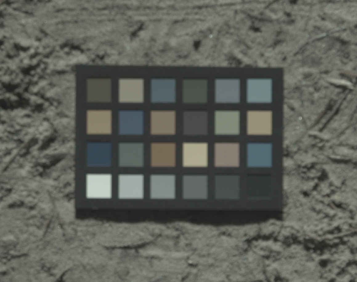

    Here's a Foveon raw composite, no transformation, auto-brightened, 2.2 gamma - courtesy of the excellent RawDigger.
