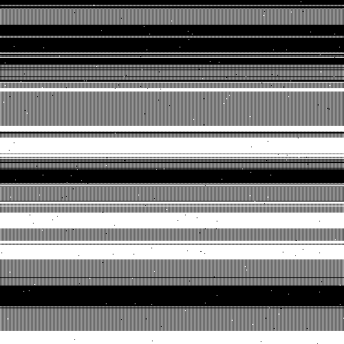

    It's been many years since I've seen a new camera with raw files that didn't have spikes and gaps in the histogram from integer math. Even on those cameras, shooting at f/1.4 probably resulted in pushes that created histogram gaps and loss of DR due to the light loss of such optics with FSI sensors, but I wasn't aware of that behavior at the time that I was seeing perfect histograms (perfect except for mapped-out pixels, of course).
    Speaking of mapped-out pixels, the Canon EOS 10D at ISO 3200 actually showed about half of the mapped-out pixels as a side effect of mapping them out after an arithmetic push, because the camera made the LSB of every horizontal line either 1-1-1-1..., 0-0-0-0..., or 0-1-0-1, so any pixel that was interpolated because it was bad had a 50% chance of falling outside of those consistent horizontal patterns.
    Here's a 100% crop of the LSB (least significant bit in 12-bit raw):
    GIF, 3.0 KB, uploaded by JohnSheehyRev on Aug. 5, 2023.
  • Members 300 posts
    Aug. 5, 2023, 4:58 p.m.
    What the *** is LSB?
  • Members 590 posts
    Aug. 5, 2023, 5:04 p.m.
    IIRC, the whole pattern of analog gain and digitization on the 10D was that ISOs 100, 200, 400, and 800 had analog gain proportional to ISO setting, and ISO 800's analog gain was used for 1600 and 3200. At 1600, it was left in the original digitization, much like later Canons sported HTP at ISO 1600, but for 3200, they did a 1-stop arithmetic push and rather than having just only even numbers, they seemed to be trying to correct some horizontal banding read noise by adding/subtracting a mean of 0.5 or 1.0DN to some lines. Apparently, the mapped-out pixels were interpolated after the extra 2x "digital" gain, and that's why half of them leave those artifacts (the other half not falling outside the pattern).

    As I already wrote in the post you replied to, it stands for "least significant bit". We count to 7 digitally, like so:
    0 = 000
    1 = 001
    2 = 010
    3 = 011
    4 = 100
    5 = 101
    6 = 110
    7 = 111
          L
          S
          B
    The LSB is the digit on the right, which determines if the number is odd or even in base 10.
    So, I made an image that is one-bit from the least significant bit in the 10D ISO 3200 raw. Zero stayed zero or black, and "one" became white or 255.
    I don't recall exactly why I decided to visualize a single bit from a 12-bit file; maybe I wanted to see how much pixel-level variance there was, but found this total artifice instead. I was shocked when it appeared on the screen, having expected to see an LSB shaped almost completely by noise.
