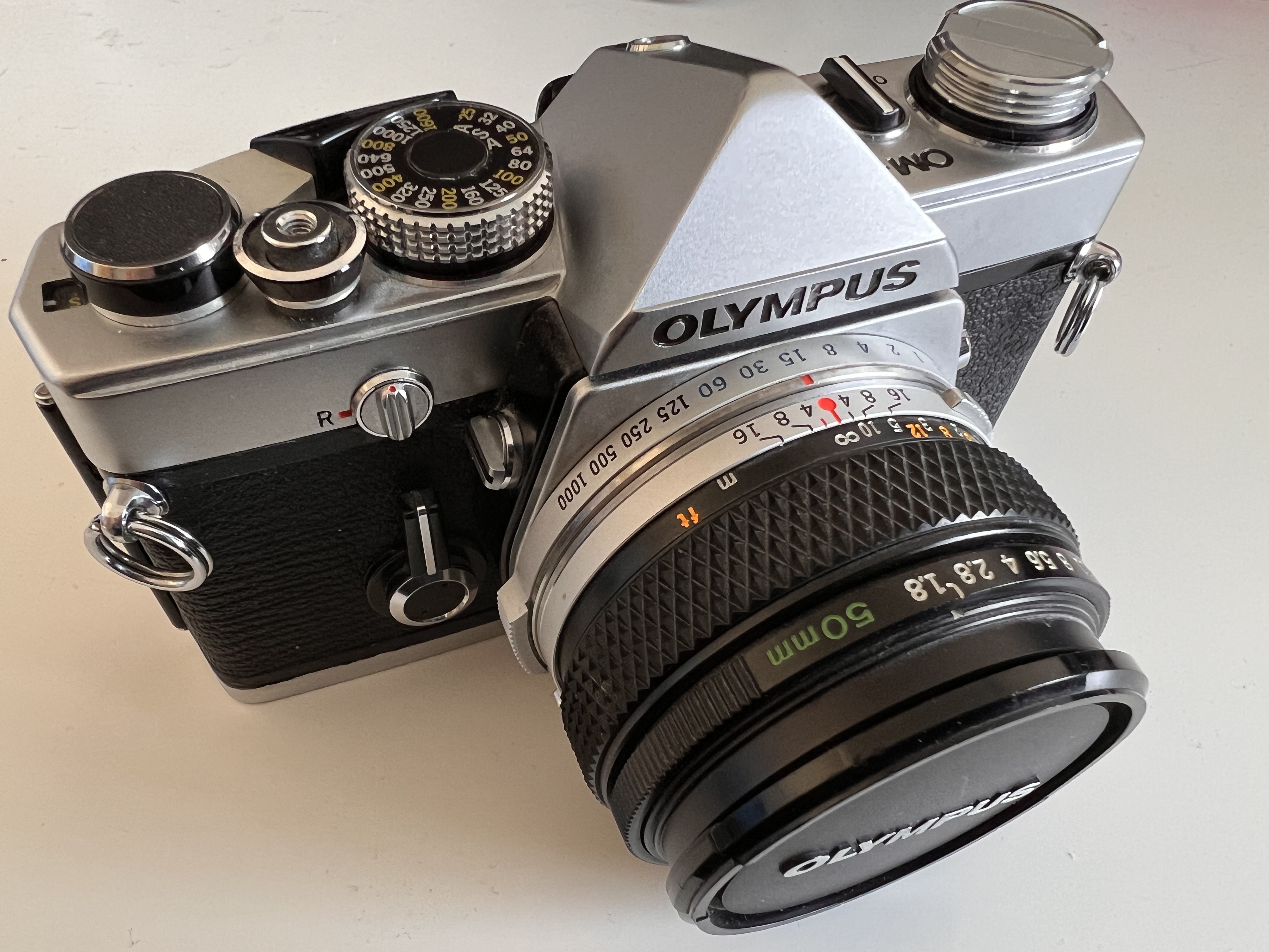

    On mine the shutter control is around the lens 🤷‍♂️
    JPG, 2.1 MB, uploaded by Threaded on April 1, 2023.
    ChrisRUK likes this.
