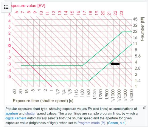

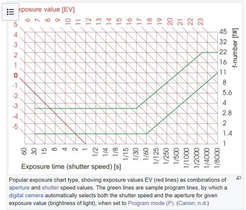

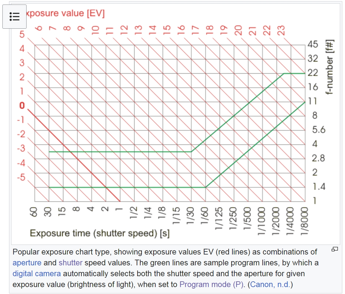

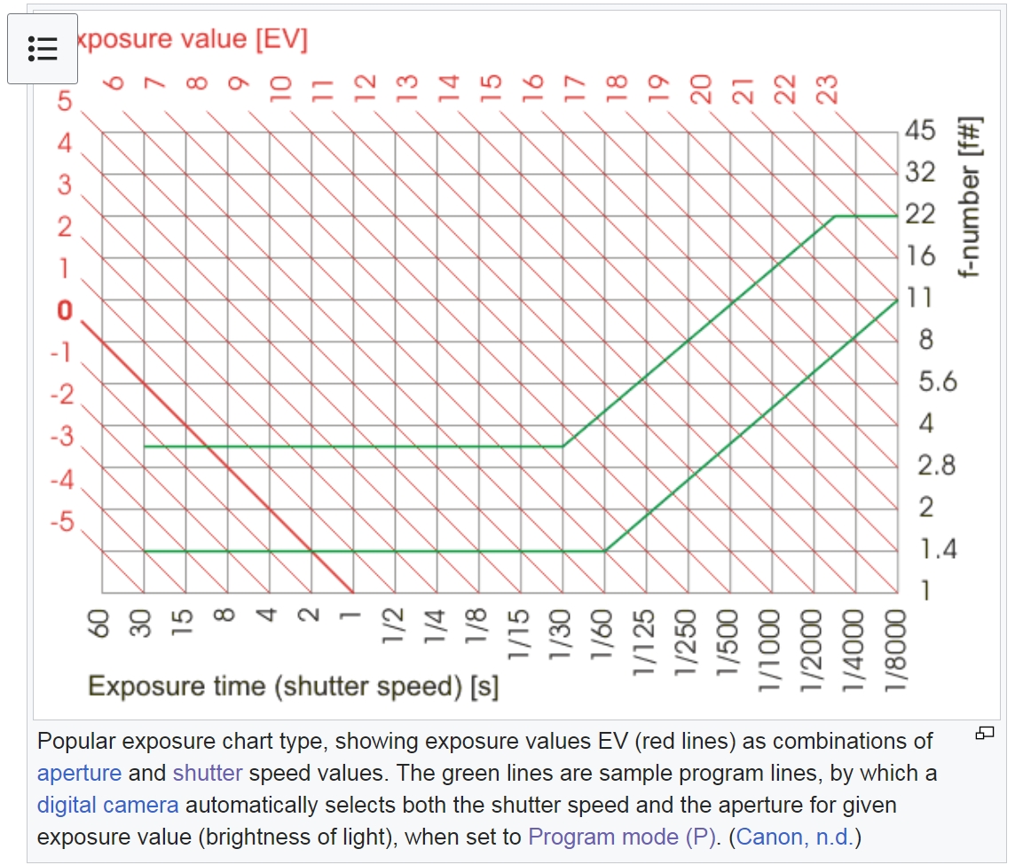

    In the Wiki on Exposure Value there is this chart which I've never really understood ...
    ... until I read "Program mode" in the text! I still don't quite get it but at least it offers a clue as to where the default numbers might come from!
    Maybe the green lines represent two different lenses, in which case my prior 13 EV would default in P-mode to about f/4 1/1000 with the expensive lens ??
    Hogan's numbers match the upper green line very well !!
    It does introduce lens characteristics into the fray. :wink:
    JPG, 541.0 KB, uploaded by xpatUSA on May 6, 2025.

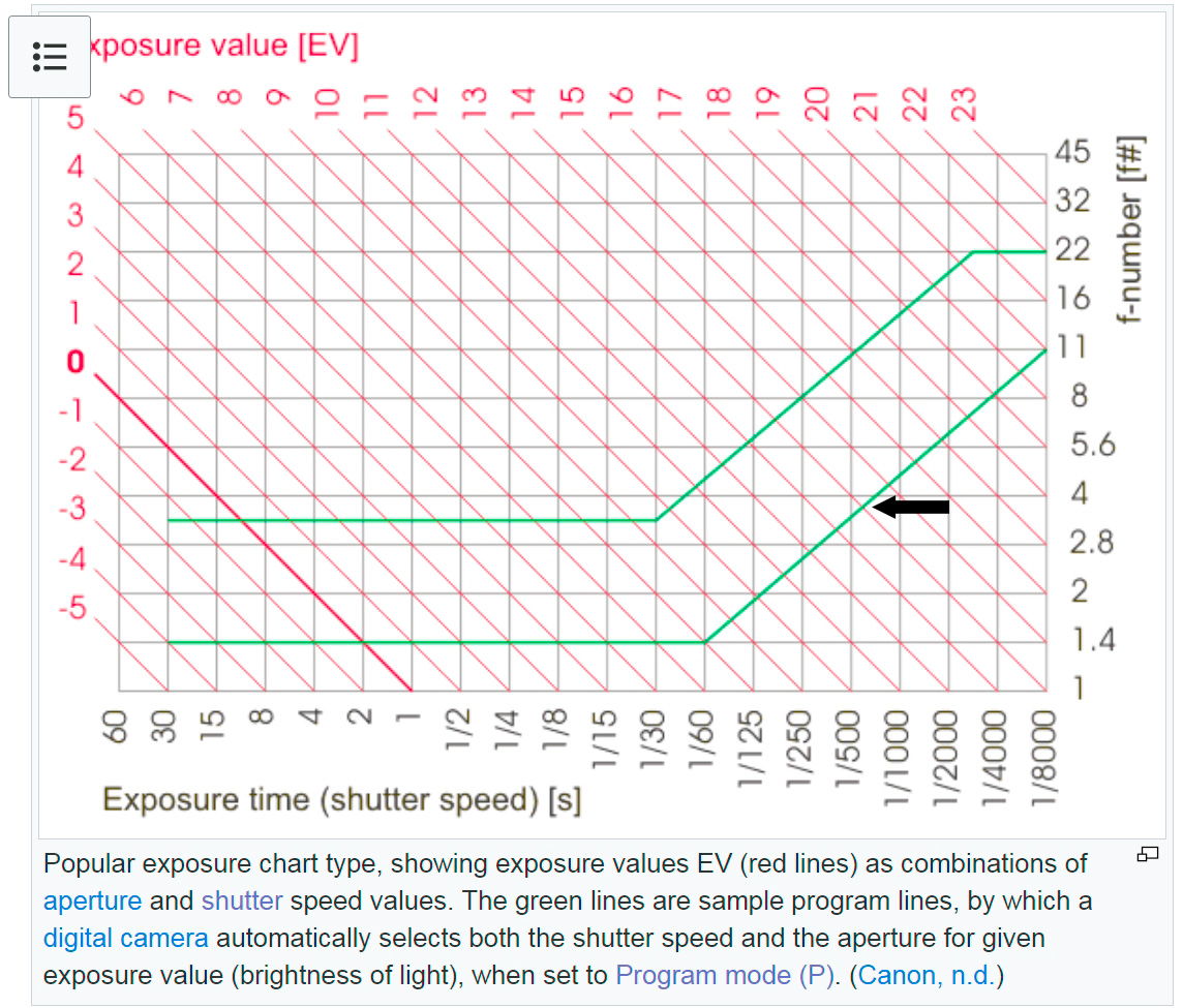

  • Members 359 posts
    May 6, 2025, 7:37 a.m.

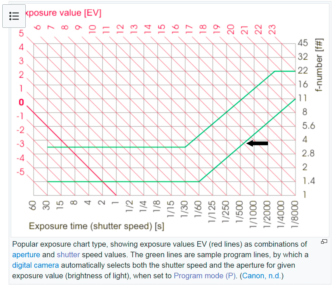

    The way I read it is that the red lines are the "possible" shutter/aperture combinations for that specific EV value at a fixed ISO, or programmed values. The two green lines are two different examples of how the "P" mode selects the aperture/shutter combinatio. What it doesn't show is ISO, also not shown is focal length so expect that to be a factor with the f3.5 lens probably being wider. So yes, a f1.4 lens would be wide open adjusting ISO until 1/60 sec and then ISO would be a constant value. The other line is a f3.5 lens which varies ISO until 1/30 sec then holds it constant until f22 where presumably it hits the smallest aperture and defaults to changing ISO again. I read the selection of aperture/shutter at EV 13 for the faster lens to be here:
    JPG, 371.5 KB, uploaded by Andrew546 on May 6, 2025.

    May 6, 2025, 2:12 p.m.
    Thanks. Good point about ISO for modern cameras.
    P.S. Looks too like maybe the same camera is also illustrated by the green lines since there is the same maximum shutter time applicable to both lenses. For example, my Sigma SD9 camera can not go longer than 15 sec at 100 ISO, so that's where the horizontal green lines would stop at the left of this chart.
