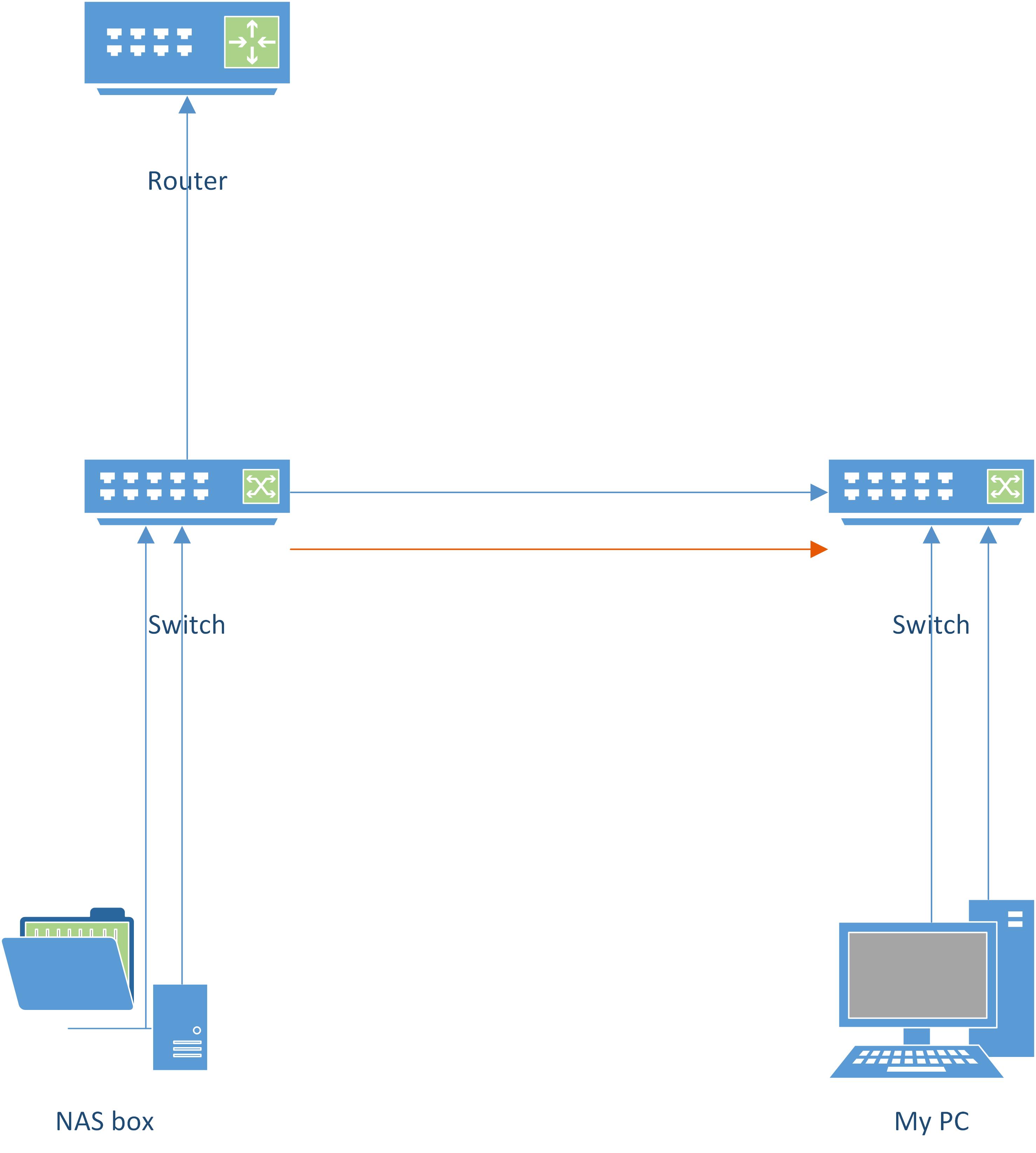

    So, I tried what you suggested, FP33, but it did not work. As soon as i connected two wires between the two switches, I lost all connectivitiy from my PC - that was without connecting anything else. So, I removed the second one and it all sprang into life.
    I persevered and put the second network card in and connected a second cable. My PC picked another IP address. No issues. So, I connected the second switch-switch cable again. Lost connection.
    These are netgear 8 port unmanaged switches.
    So, that didn't work!!!
  • Aug. 9, 2024, 2:58 p.m.
    This is a diagram of the relevant bits of my network. The red line connected causes the PC to not see anything (and think there is no network connected).

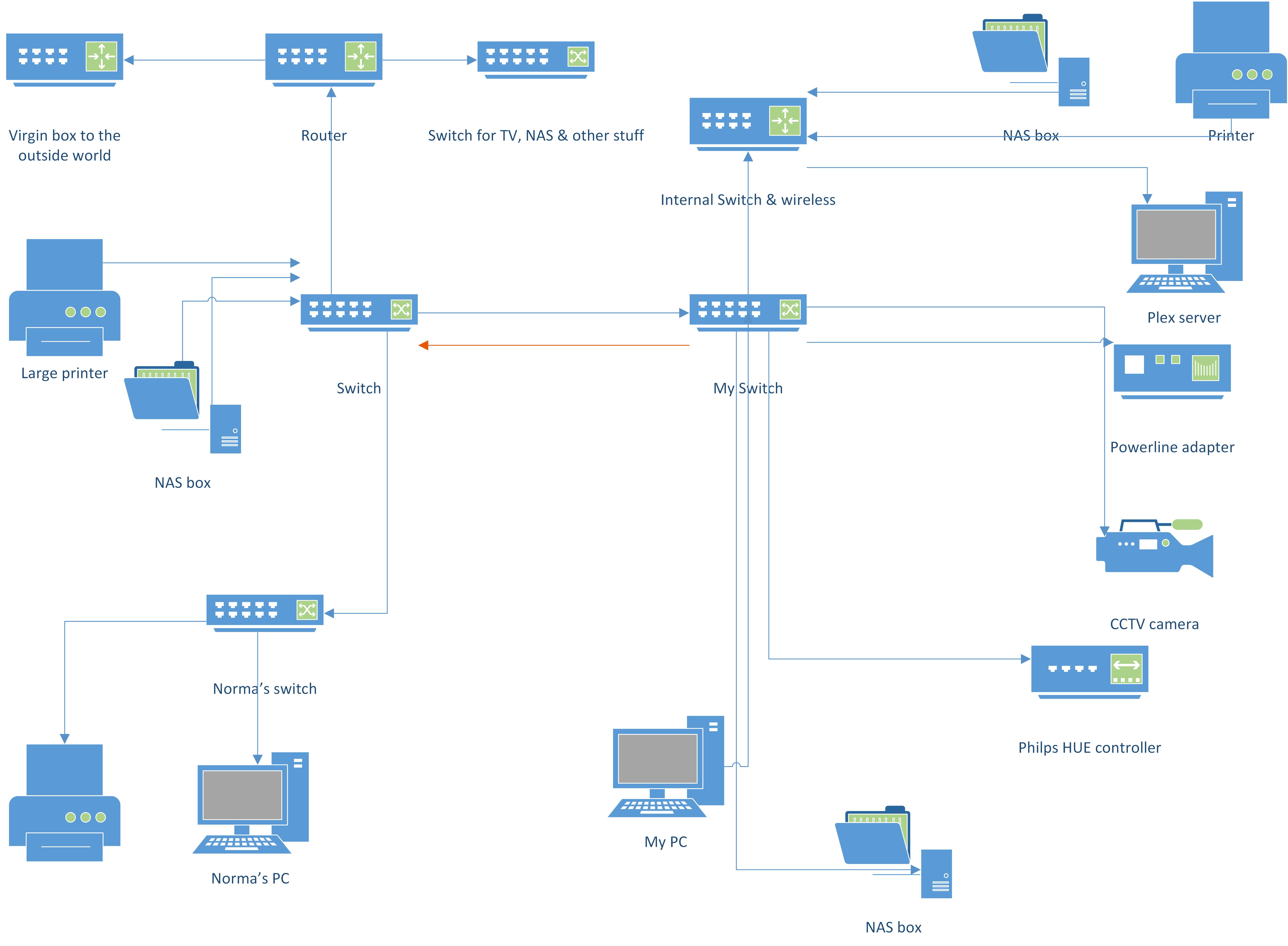

  • Aug. 9, 2024, 4:35 p.m.
    There is a lot more connected than I am showing you, plus the two switches are in two different rooms.
    I don't think that has anything to do with it. I lost connection from my PC to all network services. But I did go back to one link, enable SMB3 on the NAS and then put the second cable back in - same results.
    I ddn't have that - but I don't have that many spare ports (like only 1 in the switch connected to my PC) and I am loathe to start pulling cables as I have things (like cameras) accessing a second NAS all the time. But I may try it sometime.
    No, I didn't. But I don't see why that should make a difference. But once again, I may try it out.
    Here's a better diagram of what's around. Still not complete (it doesn't cover stuff in the lounge, kitchen or garage or any devices connected by wireless)

    What netgear model exactly? If they are truly unmanaged (no external access), then most likely you can't link them by more than one cable.
  • Aug. 9, 2024, 5:47 p.m.
    I'm not sure, but they are just basic switches. No external access at all.

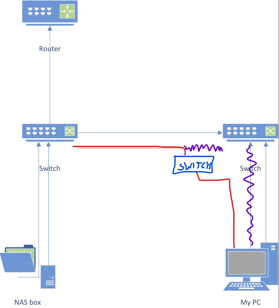

    Thinking a bit more about this,... for SMB multichannel to work you need two (or more) separate paths for the data from the NAS to the PC. Your situation is complicated because there are 2 switches on route. The suggestion to connect two cables bewteen them seemed clear but that obviously doesn't work :-( ... apparently it creates data loops and the switches can't handle that.
    A nicer solution would be to use only one switch with longer cables, but there are good reasons why that soloution is not doable in your case, which leads to a third alternative, if you haven't sent the NIC back already.
    ---> adding a small third switch to provide those 2 needed data paths like this:
    You have the cables already installed, the new switch avoids any data "looping" problems and you'd then have two equal paths for the multi channel connection.
    Maybe you even have an old 1G swicth laying around ?

    Oops - too late. And yes, I do have a third switch (I have 3 spares in case one dies). But not the dual port NIC -that went back about an hour ago.
