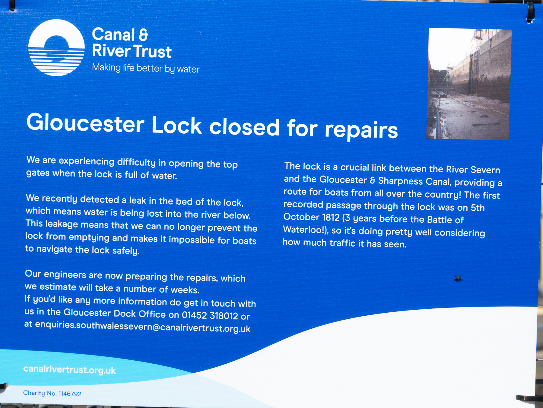

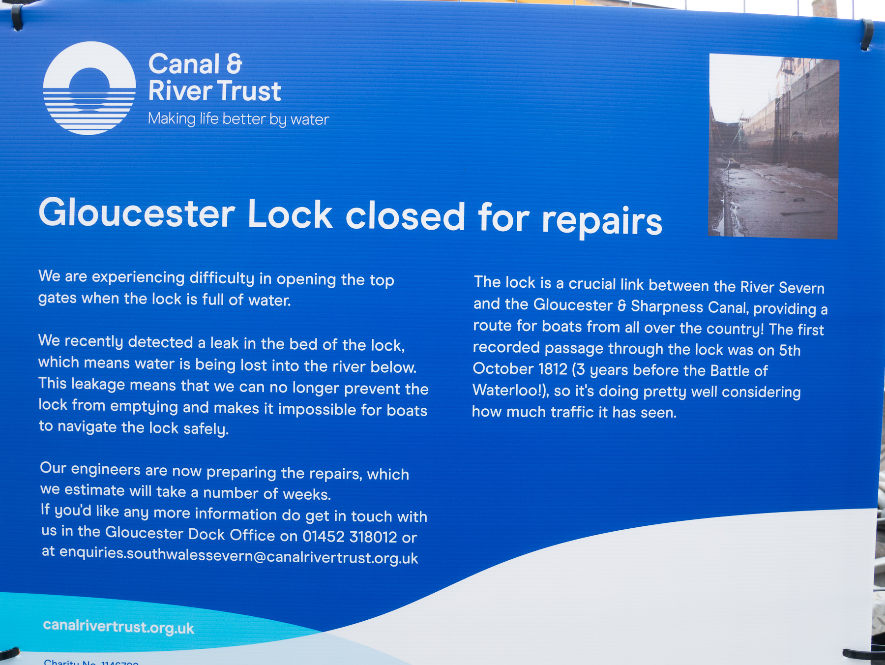

    We all know that zooming with your lens and zooming with your feet do not produce the same results in general. However, there are important exceptions.
    Consider the two photos below. The first was taken by zooming with the lens and the second by zooming with my feet. It is obvious that the two images are more or less identical after allowing for (i) small errors in alignment (both shots were handheld), and (ii) slight barrel distortion in the second image, caused by the lens. Both are the full size, uncropped images. The only processing was for brightness and colour balance.
    The subject is an information poster attached to a fence around the restoration work on the lock. The first image was taken with a 100mm lens at some distance from the poster. The second image was taken with a 12mm lens at a distance that was approximately 0.12 times the subject distance for the first image.
    This is quite a good illustration of the basic principles of perspective. Going closer to your subject increases the image size (which is inversely proportional to the distance). But the image size is also proportional to the focal length of the lens. So, the image size may be kept constant if the subject distance and focal length are changed simultaneously by the same factor.
    This works if the subject is 2-D and in a plane parallel to the sensor in the camera. For a 3-D scene where different parts of the scene are at different distances from the camera, the second image will look the same as the first only if everything in the scene can be moved to 0.12 times its original distance from the camera. In other words, the whole scene would have to be compressed by the factor 0.12.
    JPG, 1.1 MB, uploaded by TomAxford on July 2, 2024.
    JPG, 1.3 MB, uploaded by TomAxford on July 2, 2024.

    This thread makes no sense. For a flat 2D subject, it is pretty obvious that there are no pictorial perspective effects. Just, like when I used to print with an enlarger, I just moved the head up or down, or could change lens FL to fit the negative image onto the variable paper size.

    What may be obvious to you and me is, unfortunately, not so obvious to many others. Most modern photographers haven't thought much about the perspective effects in using a camera to copy documents or about using an enlarger to make prints.

    So you take two images where there is no perspective present (only magnification of a 2D plane), formulate a relationship between subject distance and image size (on sensor) and extrapolate that to explain perspective effects in the 3D world?
    There is a lot of assumption in there.
    There is no case where you can move the camera and record the same scene, it never happens. Perspective is the unique distortion of shape caused by viewing from a singular point. There are no two different points that give the same view. The 0.12 times hypothesis is thus impossible and therefore must also be incorrect.
    I wouldn't call a 2D image parallel to the sensor plane an important exception, in fact it is explained perfectly by the same geometry of image formation. The principal is simple enough, take a portrait of your loved one from 2m away with the backdrop of a snowy mountain range say 5 miles (8km) distant. Move back to 10m for a whole body shot, because you love them completely and entirely. Now your distance from your loved one has increased by a factor of 5 and so their relative size has changed quite noticeably. The mountains in the distance however are now 8008m away and as your relative distance is roughly the same as it was before they appear relatively the same size. Use a zoom lens and it is essentially just a magnification as your position (or distance to either subject) has not changed.

    Example: The first scene with the 100mm lens is in a warehouse with the camera 50 feet from a painted mural on a wall and oriented perpendicular to it. 25 feet from the camera is small flat sign (let's say one foot square) with almost no thickness, suspended by wires from the ceiling, which is out of the frame. It's oriented parallel to the wall and positioned in the exact center of the frame. Those two objects comprise everything that is seen by the camera. To shoot the same scene with the 12mm lens, move the camera to 6 feet from the wall and move the sign to 3 feet from the wall. That should work, correcting for barrel/pincushion distortion and such things. You'll want to avoid including 3D objects because the 12mm lens will render them with a higher degree of volume deformation, so the result won't be the same.
