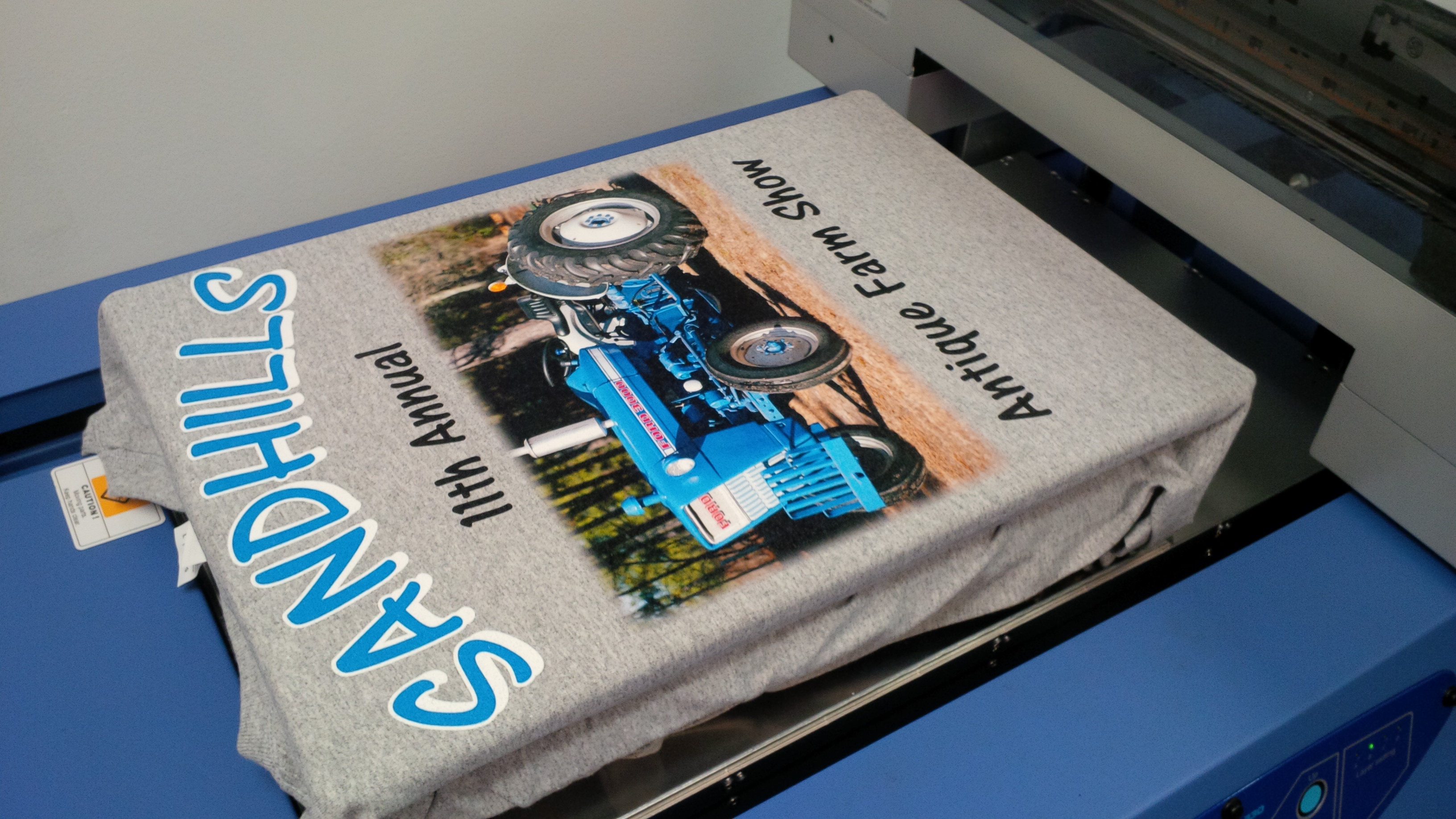

    This is a shot from the Df. Being as it's intended for this shirt, the photo is fairly small and so 16 MP is plenty. So the photo itself is done in Photoshop with ACR and then moved to Illustrator and all the rest is done there. Then, the final output is as a PSD to the RIP.
    The printer is a Direct To Garment which uses four channels of titanium white for an underbase and then CYMK on top of the white. The ink is DuPont Artistri textile inks. It is an entirely different workflow than for paper printing.
    However, for either textile or paper, the initial processing is done in Photoshop and ACR. I never did give the Lightroom product a try as I was already comfortable with my workflow in Photoshop and ACR before Lightroom came out.
