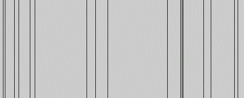

  • Members 589 posts
    May 21, 2023, 6:02 p.m.

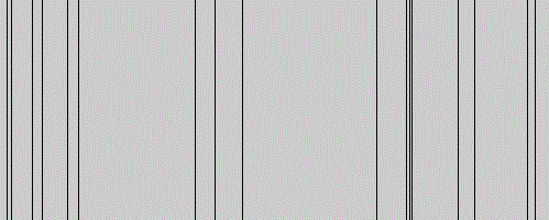

    In another thread on this forum, I made a coarse demonstration of the random arrival times, but used block code instead of a graphic, so I was stuck with low resolution, which gives a general idea, but with unrealistic spacing that is more consistent than the real thing:
                 TIME->
    Ideal:  0     1     2     3     4     5     6     7     8     9
    Real-A: 0 1     2  3  4           5            6 7          8
    Real-B: 0   1    2 3             4     5        6    7  8 9  10
    Running some actual code in Processing, though, we get much more variety in spacing, which, in a car model, might indicate a lot of "tailgating":
      size(500,200);
      for(int x=0;x<width;x++)
        if(random(1)<0.03) line(x,0,x,height);
    GIF, 13.5 KB, uploaded by JohnSheehyRev on May 21, 2023.

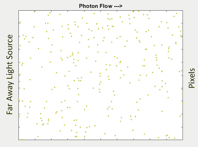

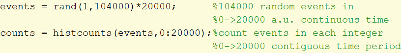

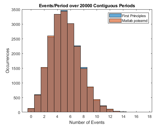

  • Members 78 posts
    May 22, 2023, 3:49 p.m.

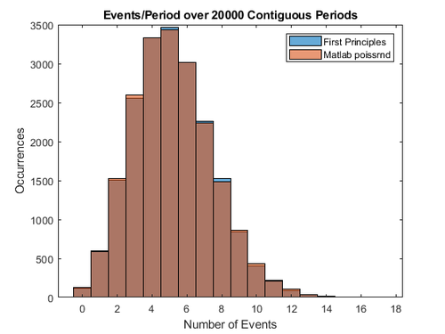

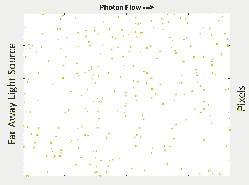

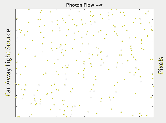

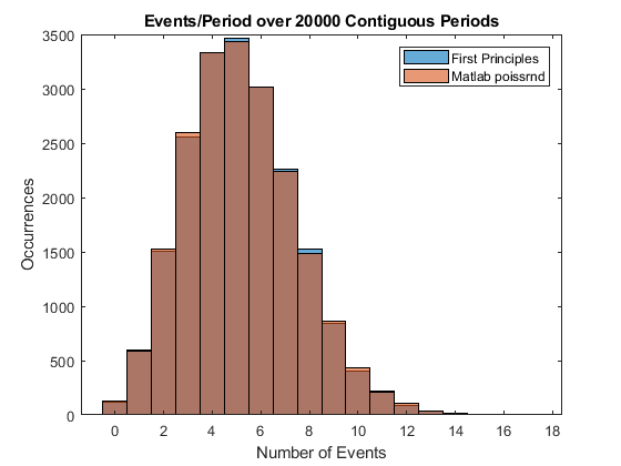

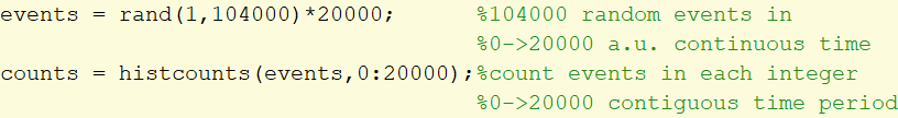

    Good one John. This is what I came up with for photons in 2D (it's a GIF, so click on it to see the simulation)
    And this is the histogram for a constant mean rate of 5.2 random events per unit of time or space
    generated with this self evident code in Matlab: 104,000 events over 20,000 slots
    Full code for the figures above in the notes of the relative article.
    Jack
    PNG, 13.8 KB, uploaded by JackHogan on May 22, 2023.
    PNG, 14.5 KB, uploaded by JackHogan on May 22, 2023.
    GIF, 287.9 KB, uploaded by JackHogan on May 22, 2023.
  • Members 878 posts
    May 23, 2023, 12:40 a.m.
    I am not very good at reading pseudo codes or even actual ones. What is the code doing here? Throwing away integers in random, and then you count how many are left in an interval of length n, like in [1, n], [n+1,2n], etc.? If so, this is not Poisson.
  • Members 128 posts
    May 23, 2023, 4:02 p.m.
    It looks like he's doing 500 Bernoulli trials with p=0.03. So it's an approximation to Poisson. Seems good enough.
