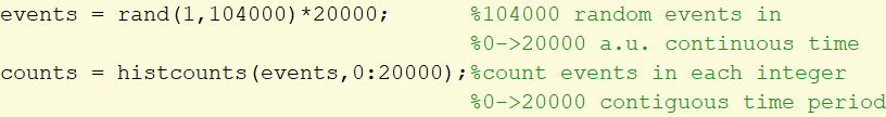

    Thank you for that JohnV, you seem to be really on top of this stuff so here are a couple of questions from a curious amateur without any formal training in the subject. Apologies in advance if this is completely off to left field.
    I agree that John Sheehy's solution, though technically a Binomial process rather than straight Poisson, is a good approximation for Poisson especially with a good number of events at the low rates we are talking about.
    Speaking about rates I'd prefer something with a low mean, say around 5, so that a histogram will clearly show the Poisson distribution. In his previous example with 500 'tosses' I'd prefer a probability of 1% for instance, the process repeated many times to make it statistically significant.
    Your solution is less intuitive to me. For instance this line:
    last_arrival_time = last_arrival_time + wait;
    Aren't arrivals in a Poisson process supposed to be statistically independent?
    Which brings me to another question, isn't time really optional in this discussion? I mean, if the photons are really statistically independent they could have been generated at any time, the process does not need for them to come one after another. In fact they could all have been generated completely randomly, thus out of sequence, sort of like I did with the two-line script earlier. If JohnS's lines represented photons striking silicon during Exposure, we would not expect them to arrive left to right, right?
    Jack

  • Members 128 posts
    June 6, 2023, 9:53 a.m.
    John Sheehy's approach does generate independent binomial approximations to Poisson.
    Jack's code doesn't generate independent, identically distributed, variates:
    If we choose a particular slot - say slot 0 - before looking at any of the other slots, the distribution of the histogram count for that slot is B(104000,1/20000) ~ Poisson(5.2) , which, I guess, is what you are trying to achieve.
    If we get a count of m in slot 0, that leaves 104000-m counts to put in the other slots.
    So if we now choose a second slot - say slot 1 - the distribution of the histogram count for that slot is B(104000-m,1/19999)
    After we've looked at 19999 slots, we don't need to look at the 20000th slot to see what the count is there - we can just add up the counts for the 19999 slots that we've already looked at, and take the sum away from 104000.
    By fixing the total number of raindrops, the number of raindrops in each bucket becomes dependent on the number of raindrops in the other buckets.
  • Members 78 posts
    June 6, 2023, 12:38 p.m.
    Well, this is where all those degrees with 'mathematics' in them come in handy, so here are more questions. The first Matlab line above generates 104k 64-bit floating point random values between zero and one (then scaled to match the desired experimental range). The interval between zero and one can represent the normalized continuous-time duration of the experiment for a single detector; or the normalized continuous-width of the sensor during a single exposure. Therefore for our purposes the generated random values are specific points in continuous time or space. Aren't these 104k values considered independent, identically distributed variates, assuming a well behaved random number generator?
    The second line above simply divides the time/space into a discrete number of contiguous intervals and counts the number of events that happen to fall within each.
    Jack
  • Members 78 posts
    June 6, 2023, 12:52 p.m.
    Fixing the total number of arrivals is indeed a limitation of my approach (shades of the earlier Expected Value vs Mean discussion), which however I believe becomes irrelevant with a large enough number of intervals (the dual of JohnS's n and np rule of thumb). What if I told you that I started with a known constant rate of 5.200 arrivals and that I wanted to check 20k such intervals (say a uniformly illuminated 200x100 pixel patch captured in the raw data)?
