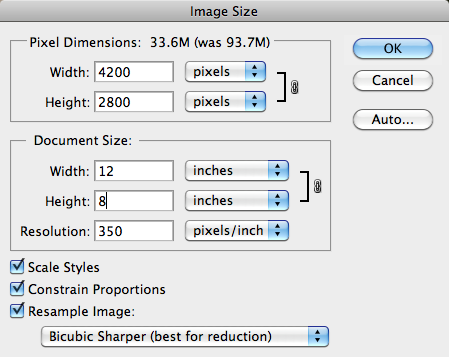

    This is how we do it: we know that the optimal ppi (XResolution / YResolution) for a given printer / imagesetter / media (paper, film, ...) is N; we resize the image by scaling - changing pixel count along both axes (pixel dimensions, ImageWidth & ImageLength) so that for the necessary output dimensions N ppi are submitted to the driver/RIP. Thus, we don't use ppis to set the image size, ppis are fixed.
    Why I mentioned Dolev: Dolev RIPs allowed to do the resizing on the RIP itself, based on the desired image dimensions, image ppis, and output dpis, and even to select the resizing algorithm / pattern (up to stochastic raster). Resizing was done at the rasterization step, theoretically the best point to do it. It was rather fast, but Photoshop worked better.

    The bottom line of my understanding is that to change the physical output print size for a given image file, the ppi value must be adjusted either directly or indirectly by inputing the print size dimensions, length and width, and the app then calculates the ppi value for that image size.
    Is this not correct?

    Depends on the app. Ps does it that way (sort of: you can't independently specify the print size in both directions if you want square pixels) if you tell it not to resample, but why wouldn't you let it resample if you're going to all the trouble of opening up the resizing dialog? Then you have to enter the ppi value.

    Actually, what you described is the reverse: You set the output size, and the editor picks the ppi meadata.
    The way I do it, the ppi metadata number is set by the printer driver's native resolution. It doesn't affect the print size, since in Ps, I specify that, and Ps resamples the image.

    Under the "Document Size": enter the target ppi ("Resolution"), next enter the target dimensions ("Width" & "Height", locked together to avoid distortion) in length units (inches/mm/picas/...), like this:
    PNG, 52.7 KB, uploaded by IliahBorg on June 2, 2023.
