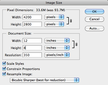

    Yes, the dialogue box in Photoshop Elements is the same and so you can choose whether or not to resample to the printer's native print resolution.
    But in this case you are limited to the resampling type options in PS/PSE.
    I wonder if the modern AI driven resampling apps are even better than the PS/PSE algorithms. If they are then the resampling process is not as simple as simply checking/unchecking the "Resample Image" checkbox.

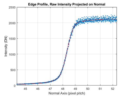

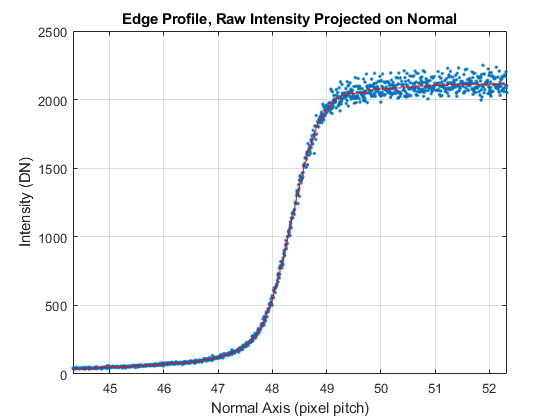

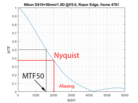

  • Members 78 posts
    June 2, 2023, 8:10 a.m.
    Yes and in fact the Slanted Edge Method does exactly that: it effectively reconstitutes the average 'continuous' profile of the edge, shot noise and all, keeping in mind that the 'continuous' signal is quantized to begin with per Planck and Einstein:

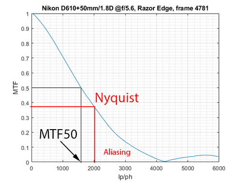

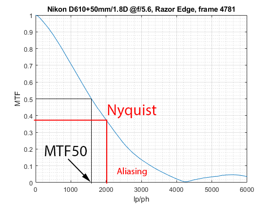

    The quantized signal can be turned into a 'continuous' one in many ways. I like monotonic regression per Kruscal (step) or de Leeuw (spline), I can't remember which of the two was used to generate the thin orange line that can be seen under the blue dots in the figure above. That's the Edge Spread Function, which as we know is a 1D projection of the cumulative mean 2D PSF onto the edge normal. If desired, it can then be transformed into a Modulation Transfer Function, which is a convenient interpretation of the ESF in certain applications.
    Such an MTF represents the average loss of contrast at various spatial frequencies for the hardware tested as setup, in the center of the edge and in the direction perpendicular to it. Pick a threshold loss of contrast (e.g. 50%, 9% or whatever works for your application) and you have a single figure 'working resolution'.
    So the key job of the Slanted Edge Method is to estimate the continuous ESF, which it performs admirably. So well in fact that the resulting continuous ESF has lost all information about the original sampling interval (pixel pitch), hence aliasing. It contains all other relevant spatial frequency information though, including the impact of the lens, the filter stack, microlenses and pixel aperture.
    It leaves it up to the operator to estimate beyond what frequency the MTF curve could become less relevant as a result of aliasing. For instance, CPIQ Acutance, a sharpness measure used by smartphone camera manufacturers, takes into consideration a weighted average of the curve up to monochrome H/V Nyquist (Nyquist changes with the color of the detail and its angle to the sampling grid). Others tend to be more stringent.
    It would be interesting to see some work quantifying the perception of aliasing in various common conditions.
    Jack
    PS More detail in this article: www.strollswithmydog.com/the-slanted-edge-method/
    PNG, 39.1 KB, uploaded by JackHogan on June 2, 2023.
