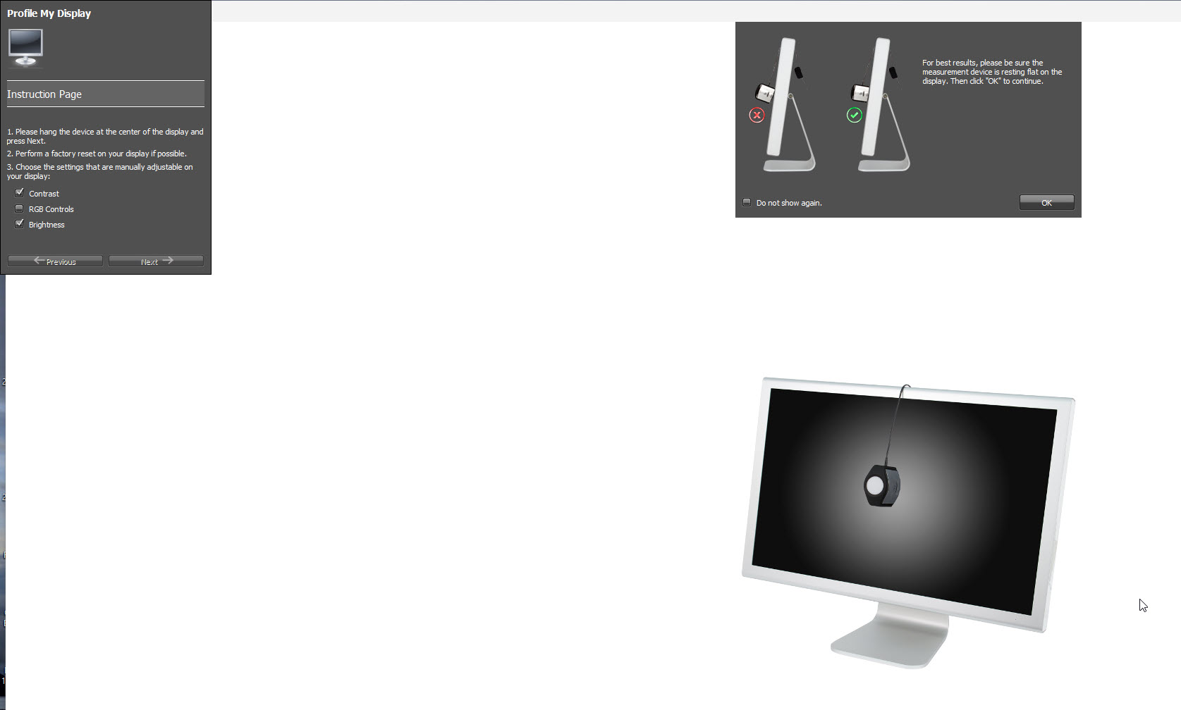

    Thanks. I tried switching off the BenQ monitor and launching i1Proiler, but it launched on the BenQ monitor and I could not think how to bring it over to the Dell.

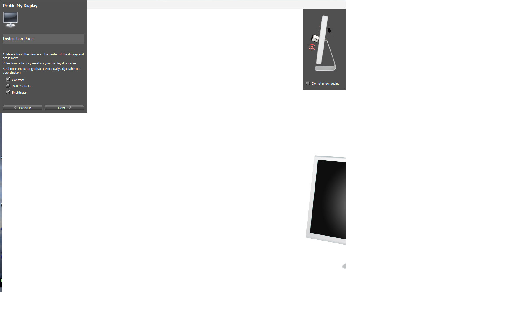

    Here is whet the screen looks like on the BenQ. (first image).
    And here is what I see on the Dell. (second image)
    AND I apparently don't know how to paste images into this thread, either.

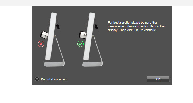

    I can't reach the OK button. (third image)
    Images list in reverse order.

  • Members 31 posts
    April 30, 2023, 5:17 p.m.
    I have managed to run the profiler for the Dell monitor. I realized that all I needed to get past was the OK button, which was off the side of the screen. I tried a (somewhat) random sequence of TAB keys and RETURN keys, hoping that the TAB key would advance to the next Windows field or button and RETURN would select that button, and it worked.
