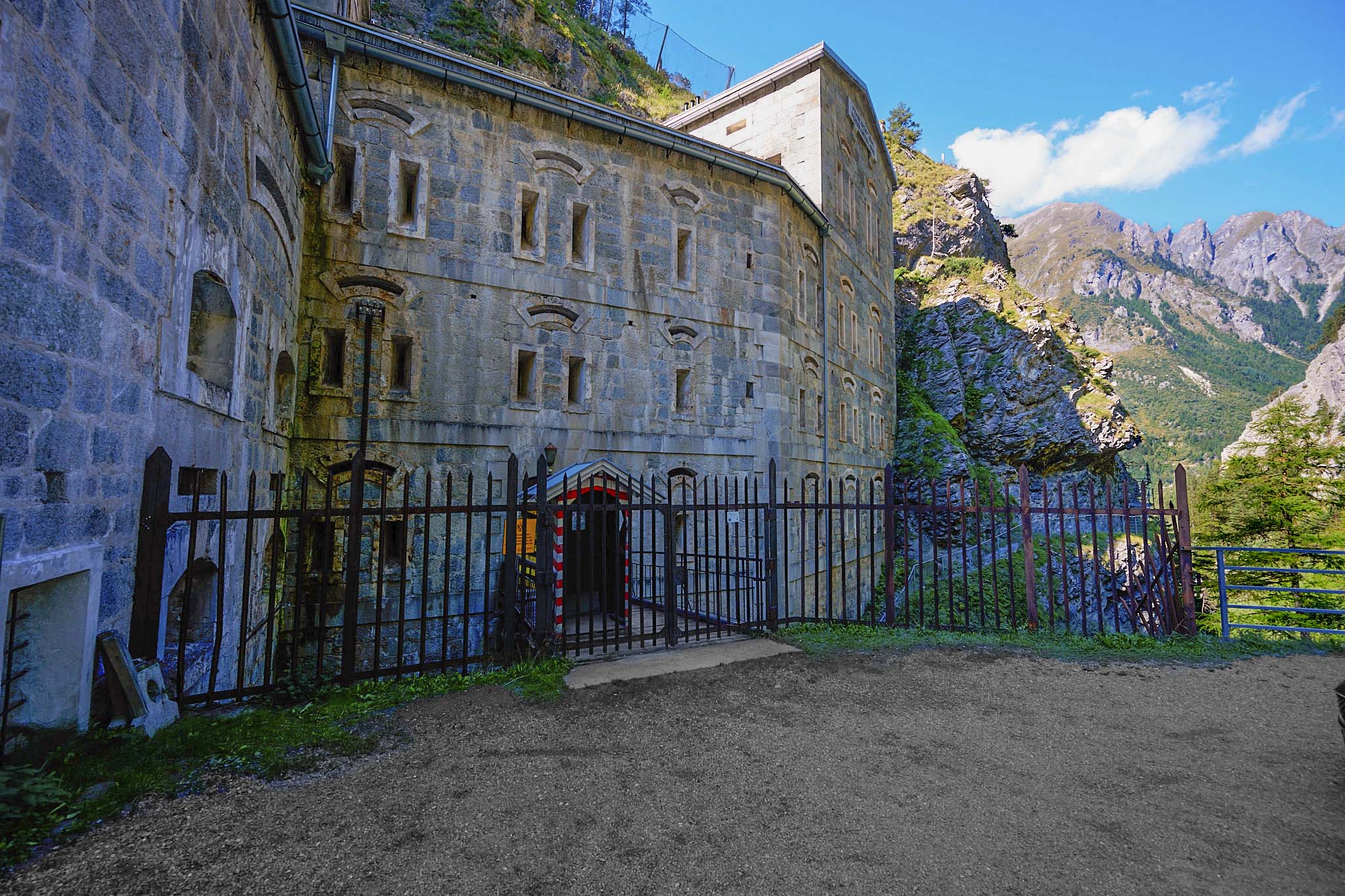

    Oct. 19, 2024, 3:40 a.m.
    And the same applies with the 1/50s shot in your other HDR sequence. You don't necessarily need HDR processing for these types of scenes.
    The dynamic range is not so high that most cameras cannot handle it.
    Even with the 1/50s jpeg you can get a very usable final image as shown below.
    If the 16 bit raw file was available I'm sure an even better final image could be made.
    dprevived.com/media/attachments/c5/e3/ZBHLHxcrrgoe8pNrm5NtkrzYLT6Y50jLnryYNl7jHZuBtNapp5IPa5vuiCCfJCZq/backlitbuilding.jpg

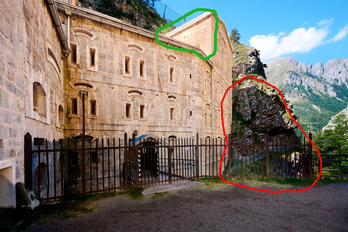

    In your HDR image the shadow circled in red does not match the "lighting" on the building at all. The sun is clearly in the distance in the direction of near the top left corner of the frame as indicated by the area circled in green.
    The large building wall facing towards the right needs to be in shadow to a large extent to match the shadow circled in red.

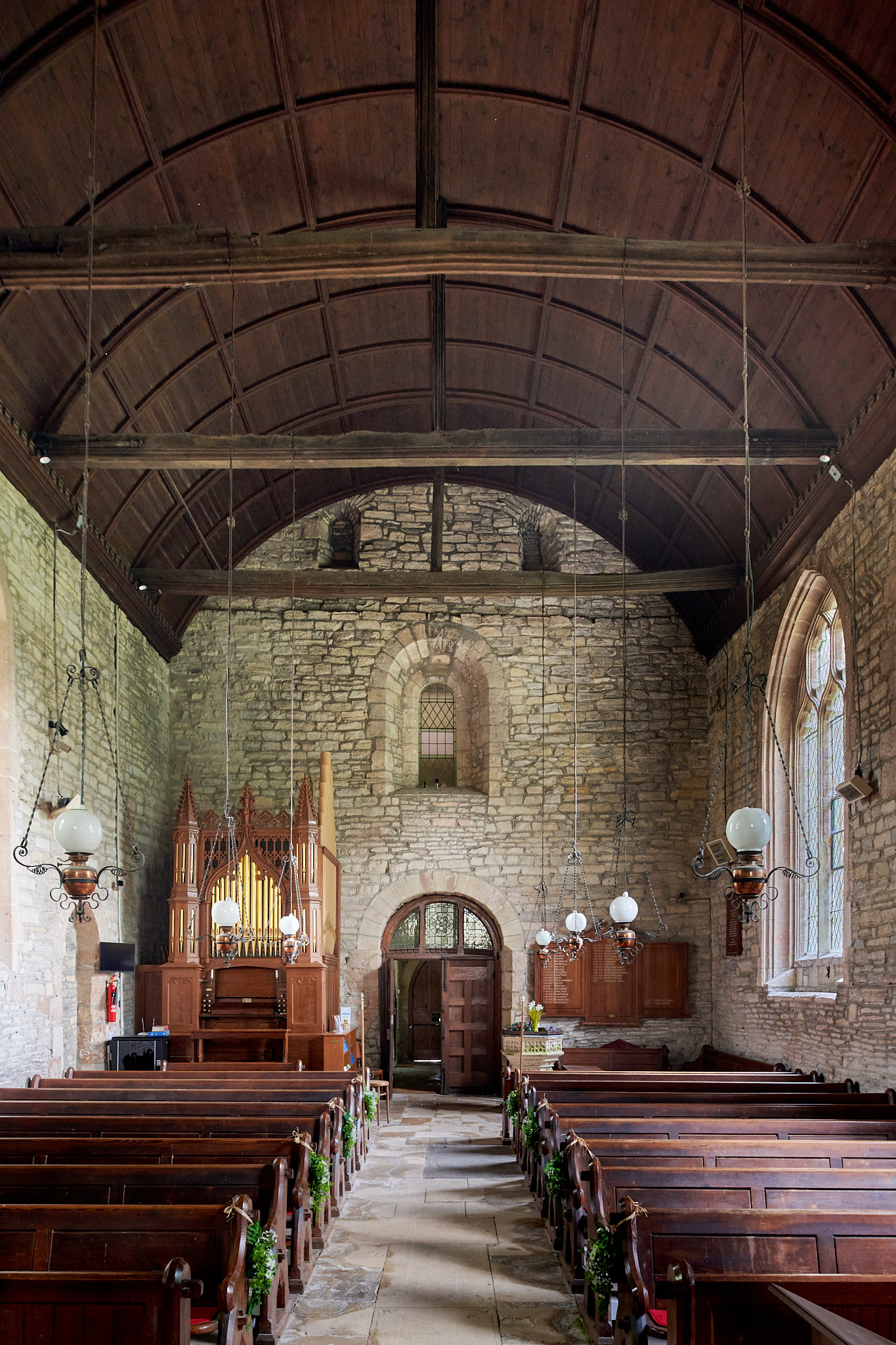

    This thread was just about a technique I found to be useful. The progress in picture processing software is enormous. The fact I can easily create hand held HDR sets, opens a lot of doors. Dealing with burnt out skies becomes easier to deal with. I can just set my Z7 to a short delay an it will fire off a 3 or 5 frame sequence with just one shutter actuation.
    Hand holding in interiors can produce better images, as I can get detail into the window areas, that are usually burnt out, with a single frame, like the shot below.

    Think you misread the photo, if we glance we tend to jump to assumptions that support our viewpoint more easily than we see where the photo doesn't.
    The sun is over the photogs left shoulder and the shadow circled in red is the shadow of the building where the light hits it circled in green, and to me the front of the building looks to be in shadow, not sunlit. Processing choice, each to their own?

    No-one is saying it is sunlit.
    I said the lighting on the wall in the HDR image does not match the shadow circled red. In the HDR image the lighting on the wall is way too light in comparison to the shadow in red.
    Even in the HDR bracket shot in the op (see below) shows the level of lighting on the wall and the shadow in red match much more closely than in the op's final HDR image.
    dprevived.com/media/attachments/68/06/z9YxnSkakTu77v4innvyvO8G1F8WK8mHO9iJSmtDZGhuFAt5Ww6eB8pkpmZdXuKZ/ads-3891.jpg
    And this is a quick and basic edit of the 1/50s shot in the op's HDR bracket.
    For me, the lighting on the large wall and shadow in red are closely consistent with each other.

    The building was in fact in the shadows, very deep shadow in fact.
    This was an experiment, to explore the possibilities of HDR. I wanted the building to be readable with a mid tone level for the stonework, as if I had been using a huge fill in flash. Yes, I should have lifted the rock shadows too.
