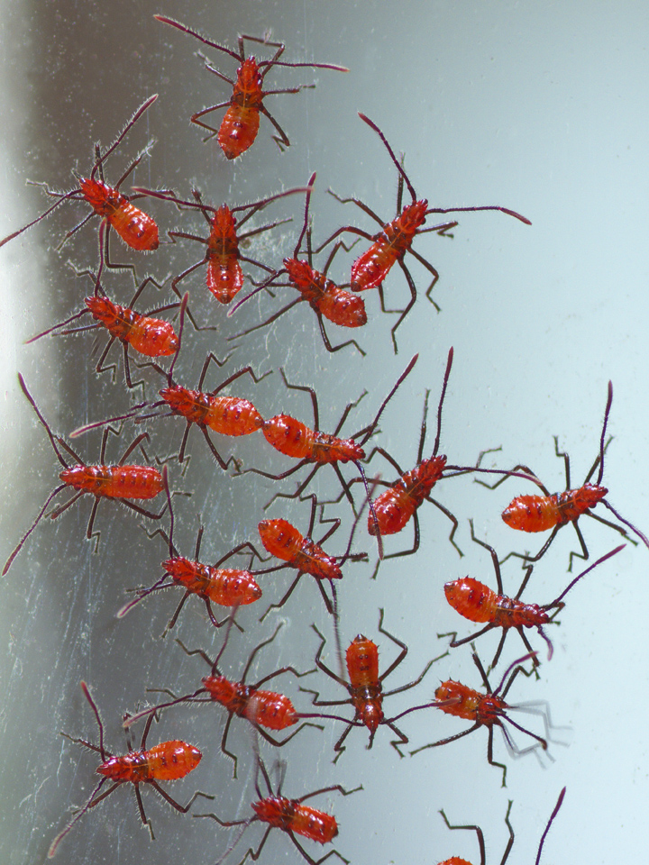

    I have the older metal body EL-Nikkor 50 F2.8. Bought it years ago for the darkroom. Repurposed it for macro. Was considering getting the newer version and found out it wasn't as good for UV. So I haven't picked one up - yet. I was posting this to show the lens reversed on a bellows at 1:1 or greater. Looking at the info, I'm not sure it counts. The bugs were on the front window. The whole colony was the size of a nickel and this isn't the whole colony. So on a full frame it is more than lifesize. This was an experiment using the Pentax Q7 with reversed EL-Nikkor. Q7 has a 4.6X crop factor. So the sensor is probably smaller than the image. On the other hand a 4.6x crop works the lens very hard with 12mp focused in a very small area.
    Wish the window could have been cleaned before the shot :).
    Thanks for looking,

    A great shot!😍
    Your EL-Nikkor looks very good in this. My newer EL-Nikkor N version is slightly soft and has an awful Chromatic Aberration at 1:1. Unfortunately I can't mount it reversed (yet).

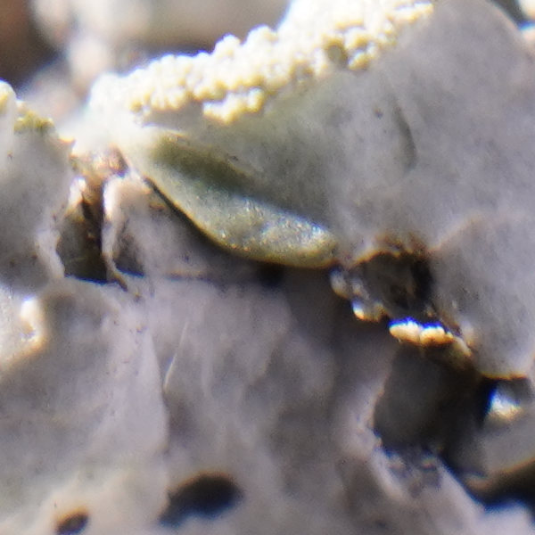

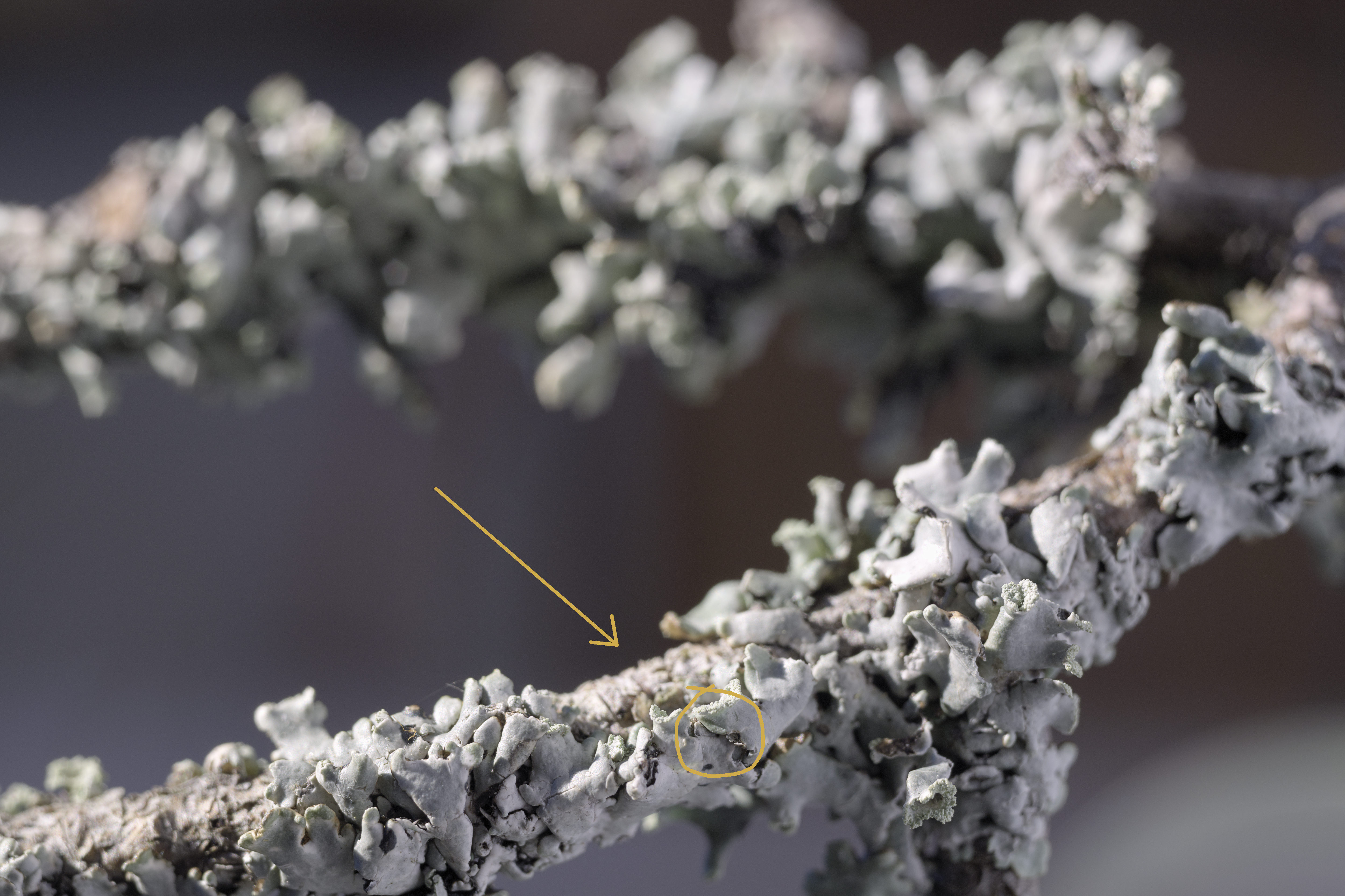

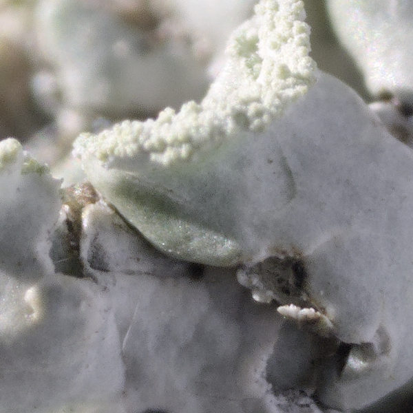

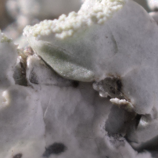

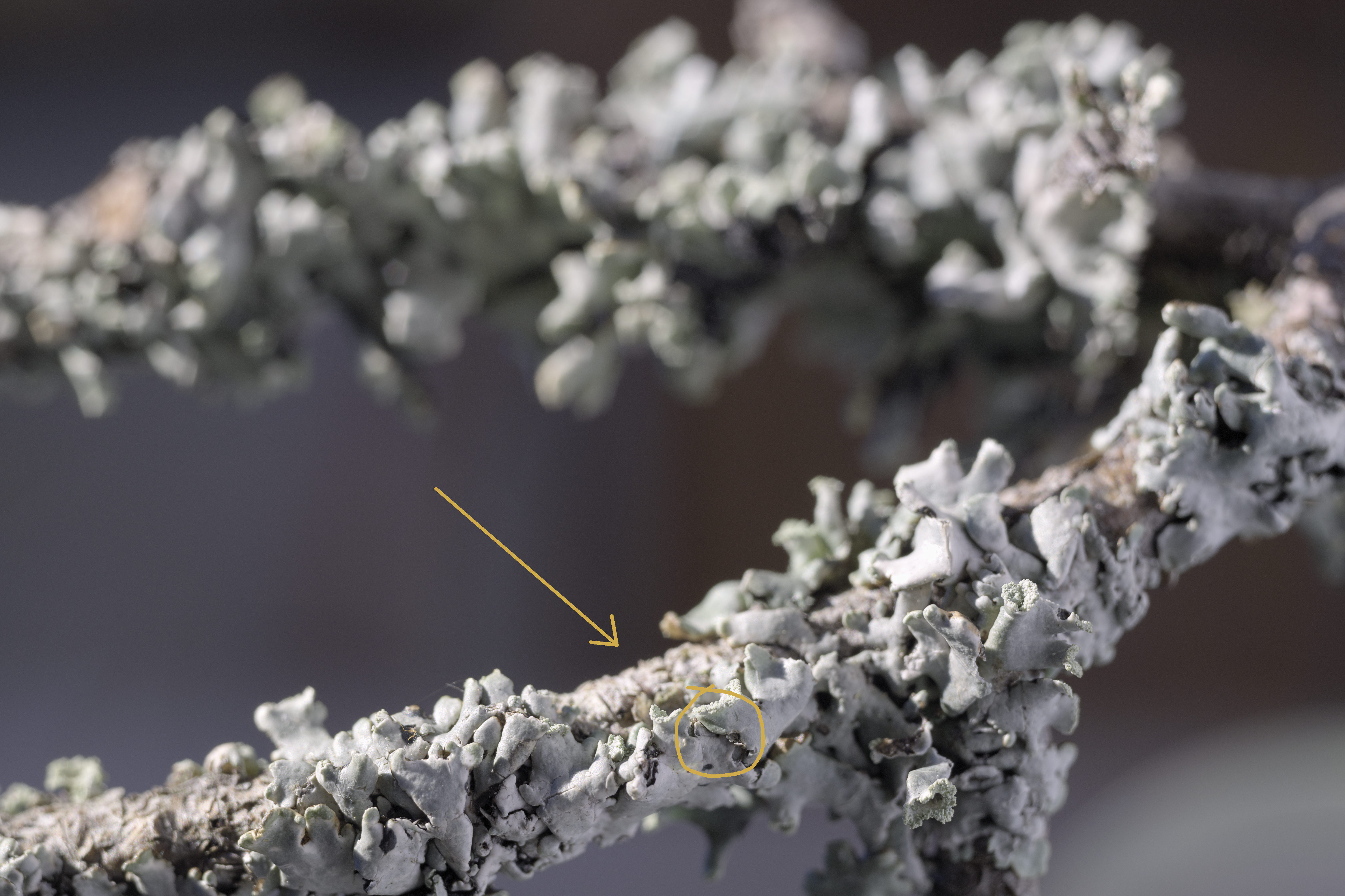

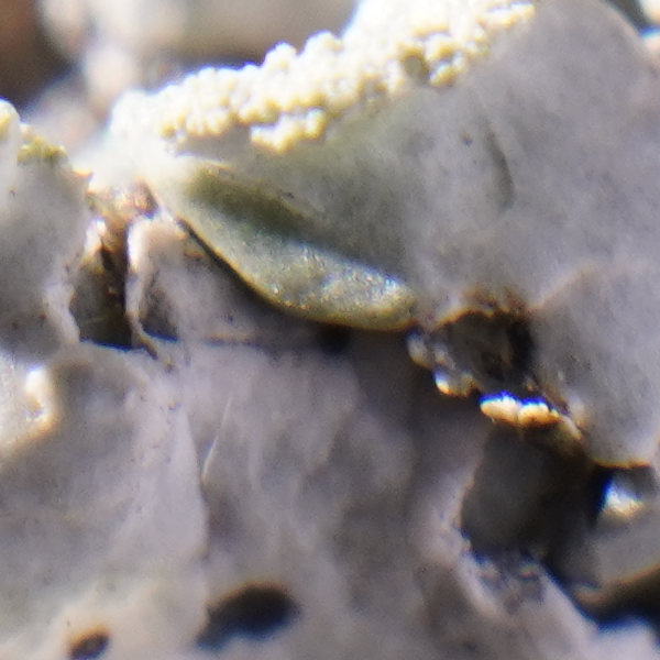

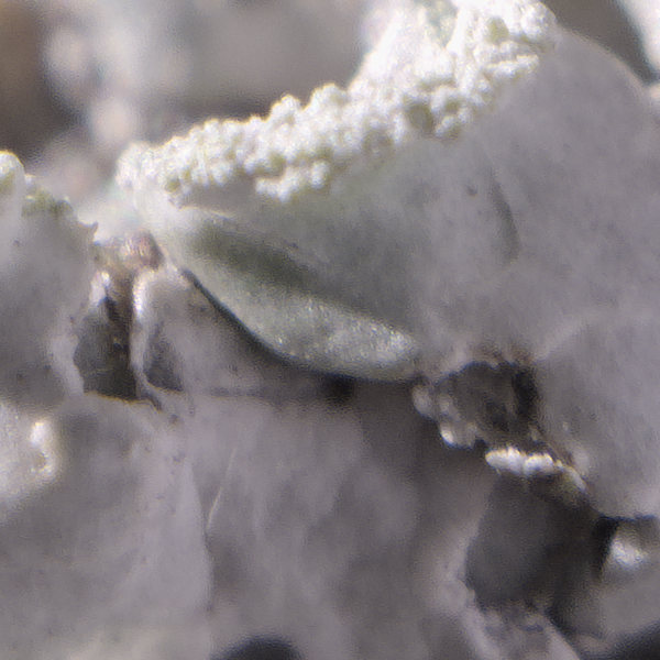

    I made a comparison with three enlarging lenses EL-Nikkor N 50mm f/2.8, Focotar 50mm f/4.5 and Rodagon 50mm f/2.8. Mounted normally, non-reversed.
    The subject was some lichen on a small branch. Magnification around 1:1 with small variation coming from my different DIY lens mountings. I tried to focus at the greenish area in the yellow circle.
    There's small variation in brightnes too although the exposure time was the same - camera at M mode - and aperture was set to the same number 8 with every lense's aperture ring. Nikkor was almost 1/3 stop brighter than the two others.
    I thought to compare the Straight Out off Camera Jpegs but due to that exposure difference and CA problems in Nikkor I used RAWs processed them in my usual way in RawTherapee.
    Here EL-Nikkor SOOC
    EL-Nikkor converted from raw
    Focotar from raw
    Rodagon from raw
    There's RT's automatic CA correction in every pic and the same amount of sharpening; in EL-Nikkor picture I manually added CA correction until it looked good. CA correction made it also a little sharper than the jpeg from camera; still not as sharp as the others.

    Thanks a lot fore the comparisons - it seems to confirm the findings of some of the macro experts I follow, that many El-Nikkors don't hold up quite as well for macro work. It's interesting and somewhat surprising, but probably can be explained in part by their optimization. After all they were not intended as taking lenses. It's similar for the Computar DL line of lenses btw. They're pretty good close-up lenses but not nearly as good at high magnification macro and (interestingly) also infinity...

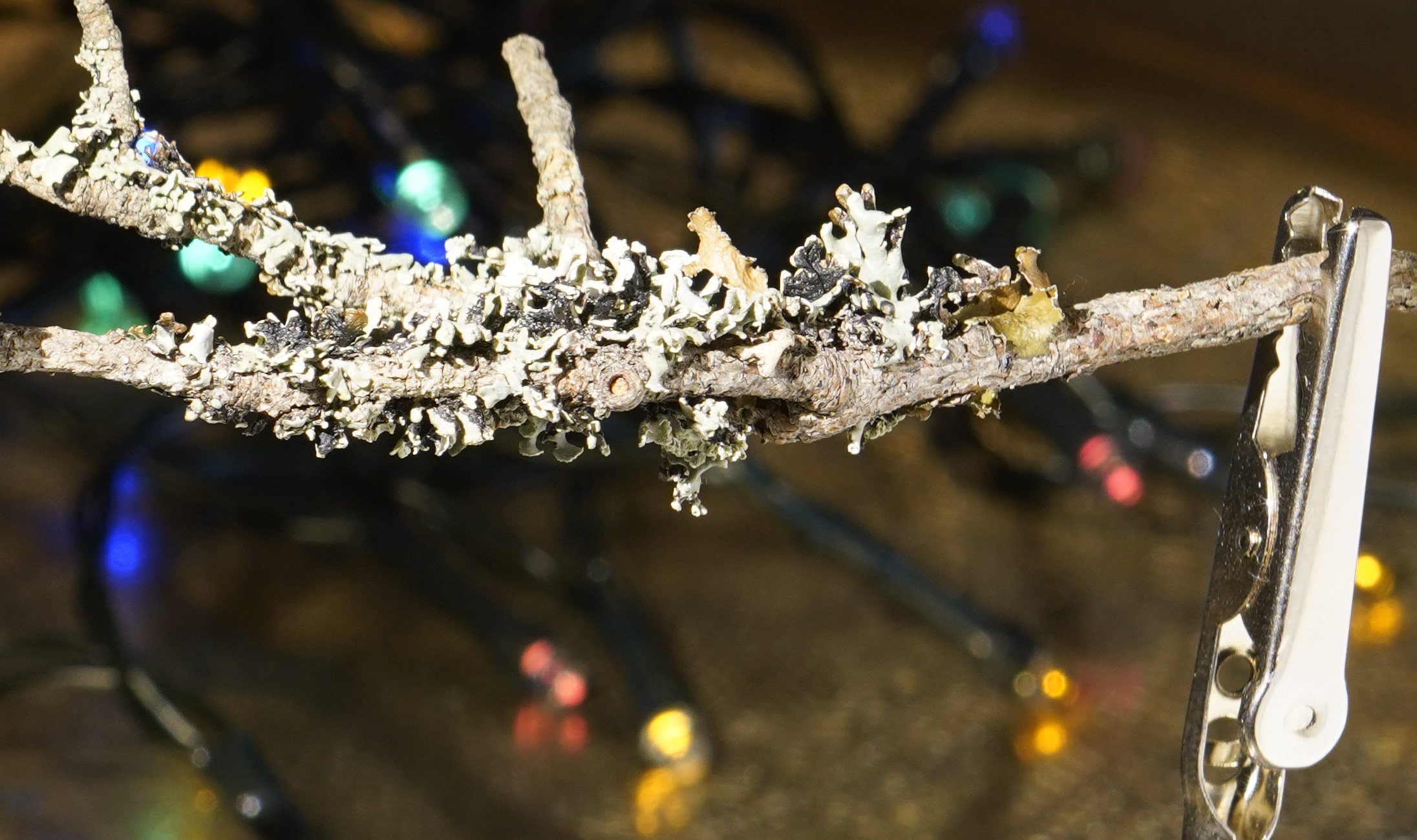

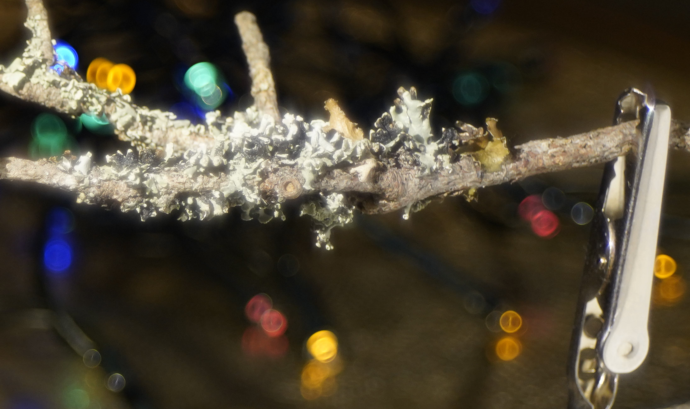

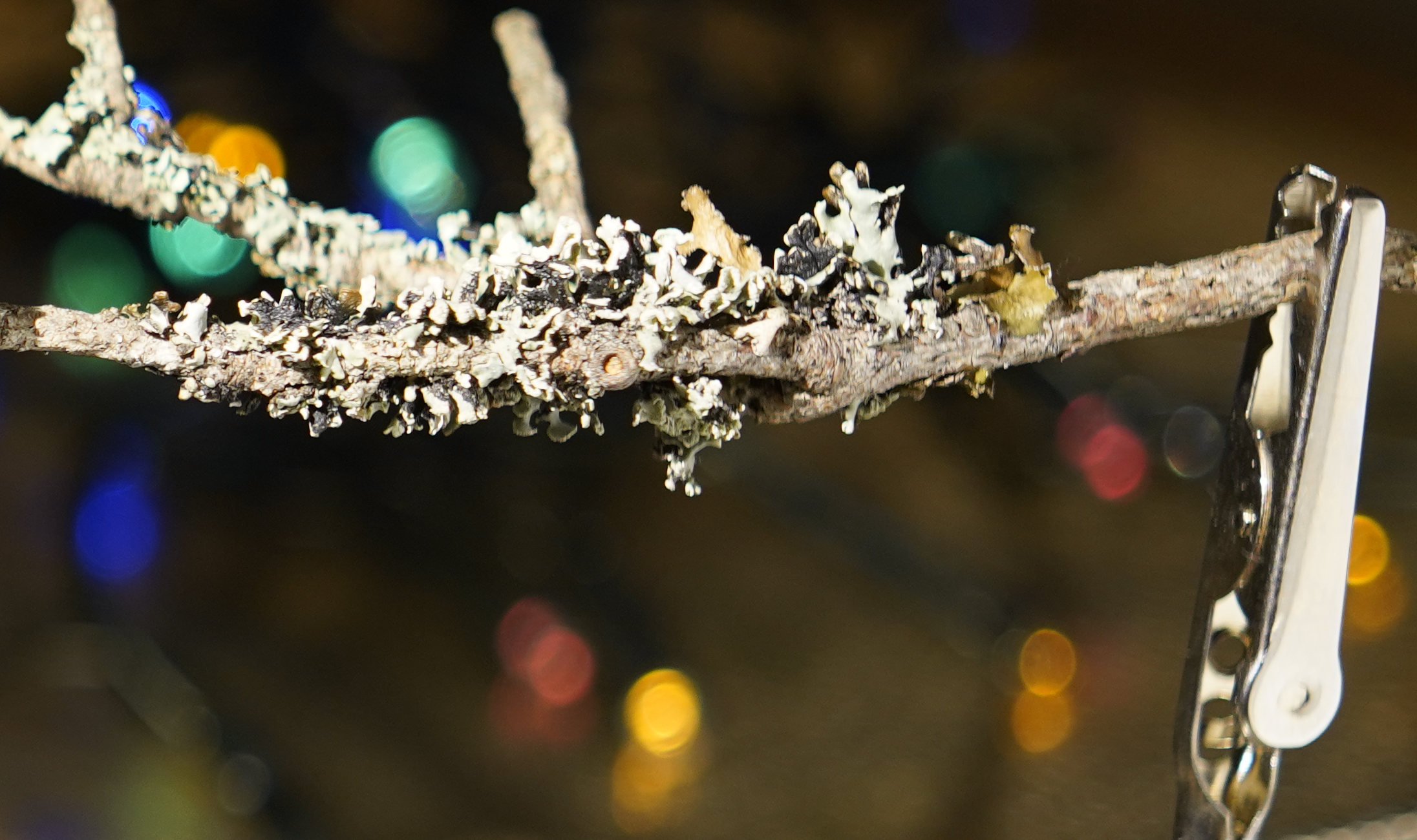

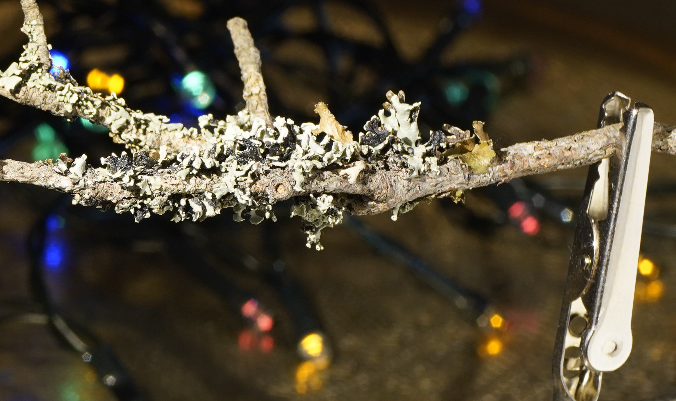

    Because I was a little disappointed with my EL-Nikkor I made some shots at their optimal focus distance around 1:10. These pictures are cropped from OOCjpgs. I used quite hard led spotlight.
    EL-Nikkor at f/2.8 very little CAs visible at the unsharp area left
    Rodagon 50mm at f/2.8 I like this flare as an effect but it was almost impossible to focus.
    EL-Nikkor at f/8 looks good, usable quality.
    Rodagon 50mm at f/8 This was the sharpest, no flare

    Super comparison. Have you ever tested the EL-Nikkor at F4-5.6? I've heard they are optimized 1-2 stops down.
