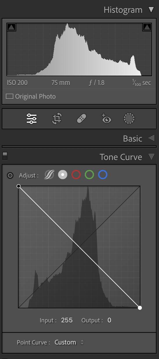

    You can do a simple inversion in LR using the Tone Curve. Click on the grey circle at the top of the Tone Curve panel and then drag the bottom-left point of the curve to the top-left, and the top-right point to the bottom-right.
    After that, the image is inverted (white parts are now black and black parts are now white).
    PNG, 510.7 KB, uploaded by TomAxford on April 6, 2023.

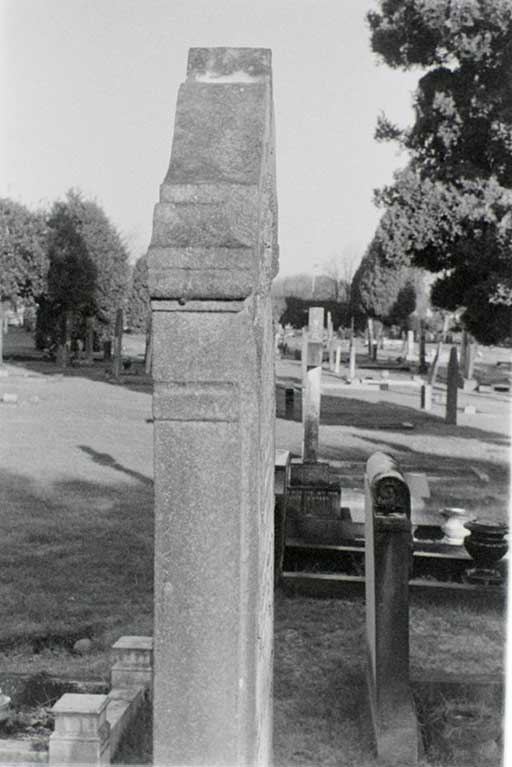

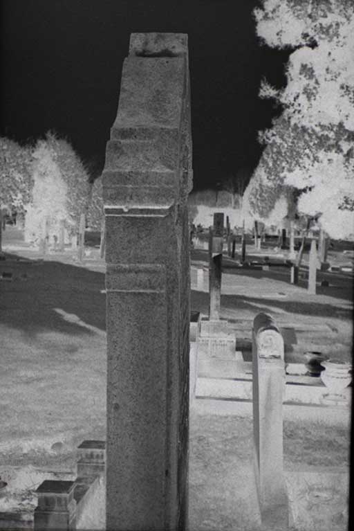

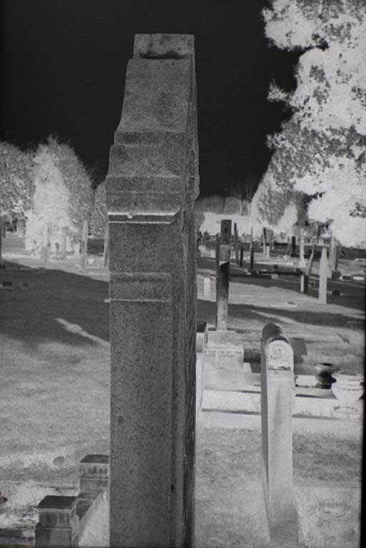

    If you have nothing (no Photoshop, Lightroom etc) and a lot of photos then you could always knock something up in Python (it sort of works for colour images too if you remove the ".convert('L')" ). The script takes all the ".NEF" files in the current directory, inverts them, does a simple contrast adjustment and writes them out as ".TIF" files. It will overwrite any existing files in the current directory so you may want to run this in a scratch space (or add in error checking).
    The original NEF file
    Converted in PhotoShop
    Converted using the Python script below
