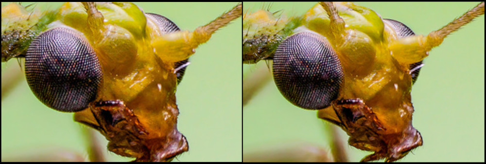

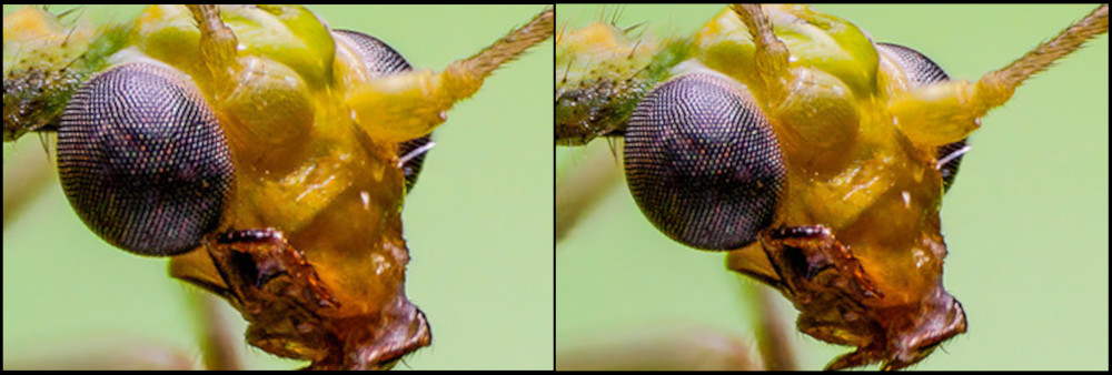

    From my calculations it turns out that using the OM System OM-1, you will get an image content with a slightly larger FoV (~1.09x) horizontally, compared to the Fujifilm X-T5. Larger FoV means lower magnification for the area of interest.
    I hope I didn't miscalculate! 😎
    I made a simulation: X-T5/left - OM-1/right
    JPG, 105.5 KB, uploaded by 3DGunner on April 1, 2023.

  • Members 1747 posts
    April 1, 2023, 3:44 p.m.
  • Members 15 posts
    April 1, 2023, 5:02 p.m.
    Thanks Maoby for the comparison pictures.
    I did a rough measurement and find the linear (horizontal) dimension of the 100% crop from the X-T5 is about 1.09X that from the OM-1. This matches perfectly with the figure 3DGunner quoted in his original reply. Excellent, Mr 3DGunner sir!!
