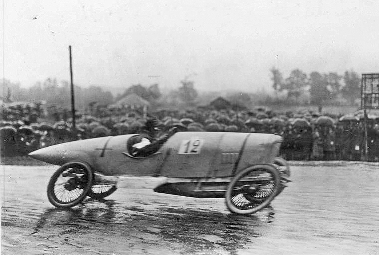

    Both MS and ES are forms of focal plane shutters, although they don't both actually operate in the focal plane -- the MS operates in front of it. When the scan times of the two are the same, they have similar distortion (but not quite the same distortion) when capturing fast moving objects. But most mechanical shutters scan faster than most electronic shutters.
    en.wikipedia.org/wiki/Focal-plane_shutter
    Here's distortion with a mechanical shutter:
    By Bundesarchiv, Bild 183-1991-1209-503 / CC-BY-SA 3.0, CC BY-SA 3.0 de, commons.wikimedia.org/w/index.php?curid=5348237
