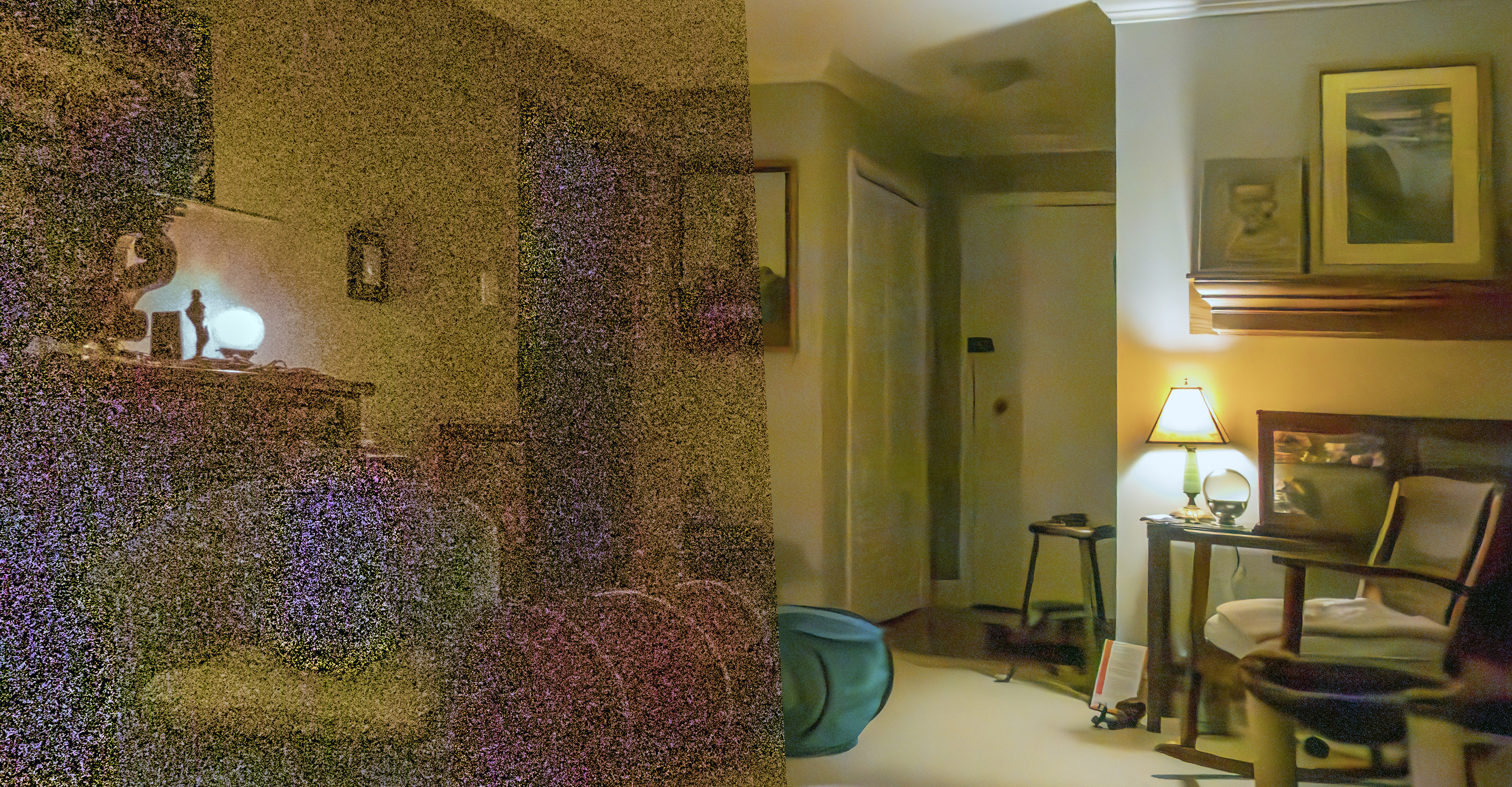

    Nikon P950 at ISO 6400
    On the left the original RAW - on the right the denoised version.
    JPG, 3.8 MB, uploaded by gordo on April 20, 2023.

    Interesting. A question: as I understand it, the output is a DNG, which then can be exported as a JPG. Is that correct? And if there is a DNG is that linear?
  • Members 55 posts
    April 20, 2023, 3:01 p.m.
    The output is a DNG which can be saved as a JPG. I don't know if it's linear or not.
  • Members 65 posts
    April 20, 2023, 3:03 p.m.
    I can confirm the denoised version is saved as a second DNG file, saved next to the original RAW file.
    In LRC most know a DNG file can be exported in jpg form.
    My preliminary testing indicates it works quite well – though I cannot confirm it is the equal of the best other brand denoise programs
  • Members 457 posts
    April 20, 2023, 4:05 p.m.
    The output file seems to be a linear DNG as it is still scene-referred (colors not assigned) but large (demosaiced).
  • Members 1030 posts
    April 20, 2023, 4:17 p.m.
    My .NEF files also show no color profile assigned to them.
  • Members 457 posts
    April 20, 2023, 4:51 p.m.
    .NEF files are raw, which are not demosaiced yet and are scene-referred (color assigned only in post-processor, not in raw file).
    BTW, you can check whether the file is output-referred (color assigned) by looking at the white balance slider. If it shows an absolute number for temperature (2000K to 50000K), then it is scene-referred. Otherwise, it shows an offset (-100 to +100) and is output-referred, and the colors have already been assigned.
    For most purposes, a scene-referred file (e.g., linear-DNG) has the same post-processing possibilities as a raw file.

    I am sorry - I missed your point about Adobe ACR/LR UI - yes it does change slider's scale ... moral - do not read postings while doing a day job :-) !

  • Members 67 posts
    April 28, 2023, 7 p.m.
    Mmmm....AI is obviously at work here, and the results are...questionnable for me. Yes, noise is gone. But the image looks completely unreal.
    I prefer some remaining noise and more true to life results. YMMV
    André
  • Members 457 posts
    April 28, 2023, 7:09 p.m.
    What you see is the OP's personal choice of settings.
    Adobe's Denoise has a slider to tune the amount of remaining noise. Adobe also suggests adding grain if the image looks too smooth.

  • Members 360 posts
    May 6, 2023, 11:35 a.m.
    Yes, rather unusable photo still, but the difference is in order of magnitude "better" to what we had before.
    Unrecoverable is unrecoverable, but either for sentiment, or understanding or human eye recognition, it is valuable tool to have.
    And while unusable by my metrics, It is greatest transformation of denoised image I have seen to date. I would not even consider such image for anything. As is, it has very close to zero information except for understanding it ś a room. So much much more is visible and understandable after AI efforts.
    I was wondering about going FF, because anything over ISO800 was not liked by me from APS-C sensors. But with AI, I get usable 4k output between ISO3200-6400. That´s another three stops of "performance", and at times, it absolutely changes things or decides if shot is taken/shown. Less demanding pictures can go up to ISO12800, no problem. Yes, FF can go stop or two higher, but the real life threshold is not at that place often, if ever. APS format got relevant to me again. No need for high res FF and consequences of such choice.
