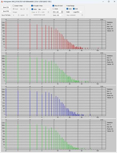

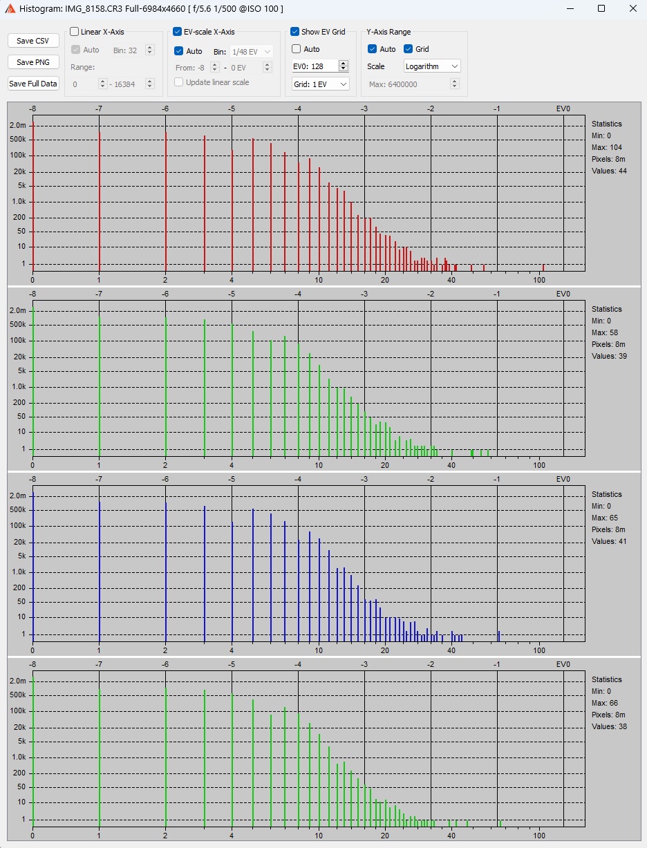

  • Members 360 posts
    April 15, 2023, 2:24 p.m.
    Great stuff. What should I take from this reading?
    My deduction only comes to "Three bits rather unusable, drown in the noise", fourth bith pokes out, therefore something over 10bits of usable DR. :-)

  • Members 1738 posts
    April 15, 2023, 2:37 p.m.
    Is that a dark field histogram? If so, crop to 600x600, turn off black point subtraction, set the x-axis to linear and the bin size to one, and repost. The standard deviation is the rms value of the noise.

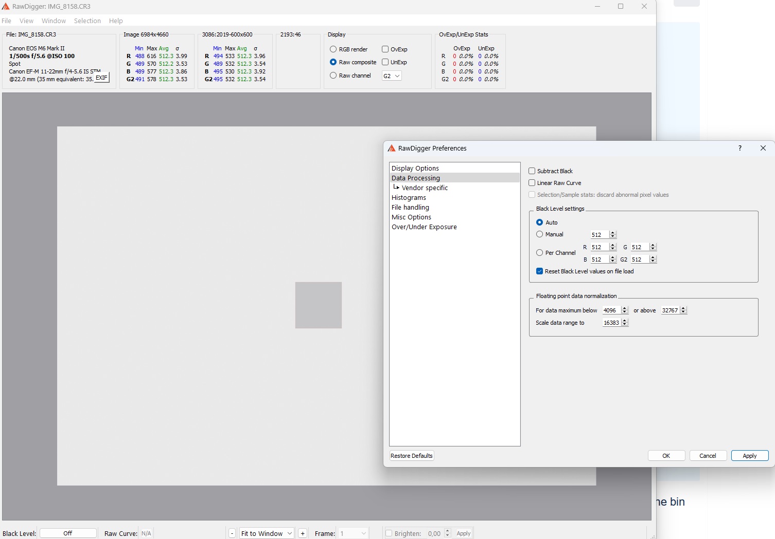

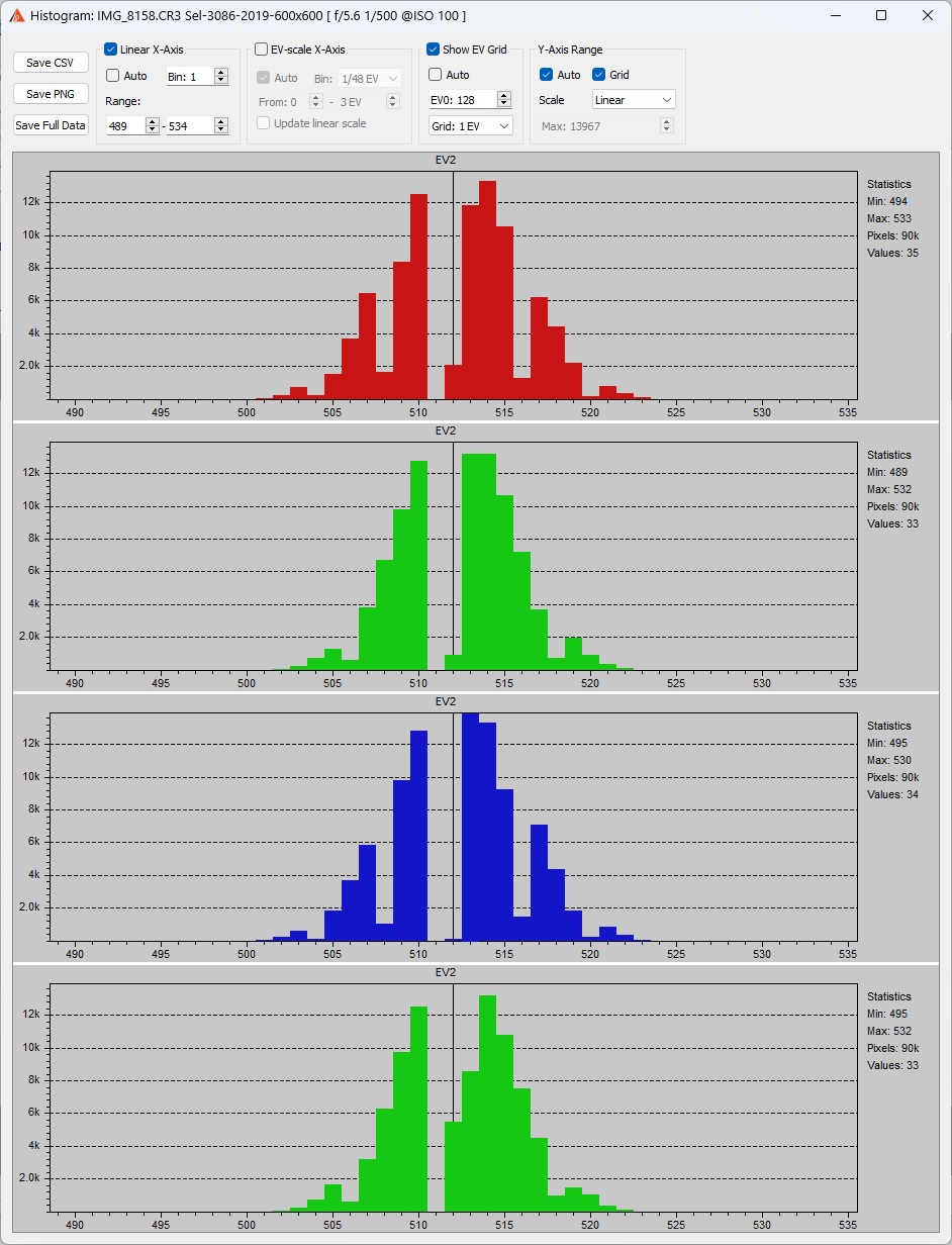

  • Members 360 posts
    April 15, 2023, 2:46 p.m.
    Yes.
    Well, before this instruction, I thought I understood something. Now, not so...
    //Edit, right picture reposted.
    April 15, 2023, 3:14 p.m.
    Looks to me me like the rms read noise is about 3 least significant bits, or maybe a bit more. I don't know your camera, but that kind of read noise is not unusual at base ISO for Canon cameras. Sonys and Fujis are better, in my limited experience with Canons.
    www.photonstophotos.net/Charts/RN_ADU.htm#Canon%20EOS%20R7_14,FujiFilm%20GFX%20100_14,Sony%20ILCE-7M4_14
    Note that Bill is using a log2 y-axis for those plots.
    But for all I know, there are Canons that are right up there with Sony.
    The combing is a bit strange.
