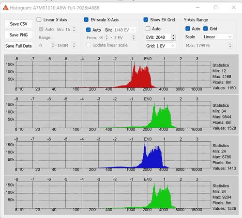

    What does it tell you?
    It tells me that your green channel is over a stop from clipping
    and your red is nearly 2 stops

    The raw histogram should be telling you why, looking at the raw histogram it shows that for that raw file you are underexposing by 1 stop half the amount of light your camera can store, while your cameras histogram does not shot this and that your red and blue channel captured the same amount of light when they did not

    If that is the case then your white background is a stop below the clipping, and you could easily add a stop to the exposure does your cameras histogram tell you this?

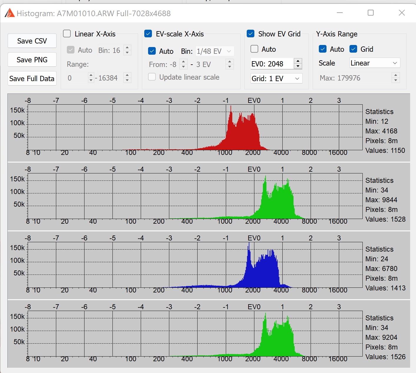

    Go into the menu in rawdigger under selection- pick selection grid- pick
    photos.smugmug.com/Temp/Temp/i-5MqCCnC/0/d9e19484/O/rd.jpg
    Place what you think is the most brightest section of your image select - selection to sample
    photos.smugmug.com/Temp/Temp/i-rHgsMSN/0/929a3fba/O/rd1.jpg
    In the samples highlight your sample the same as above and select histogram
  • Members 229 posts
    April 13, 2023, 6:24 a.m.
    The funny thing is that rawdigger did not miss the near clipping highlights because there was none close to clipping in the raw file, and that it was your raw conversion that caused the clipping
