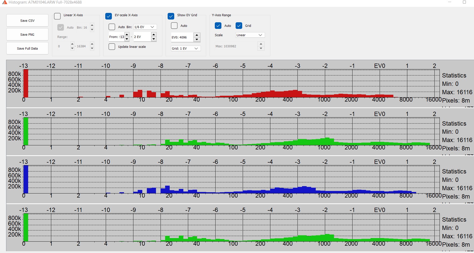

    it can measure DR

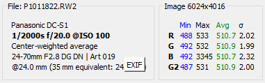

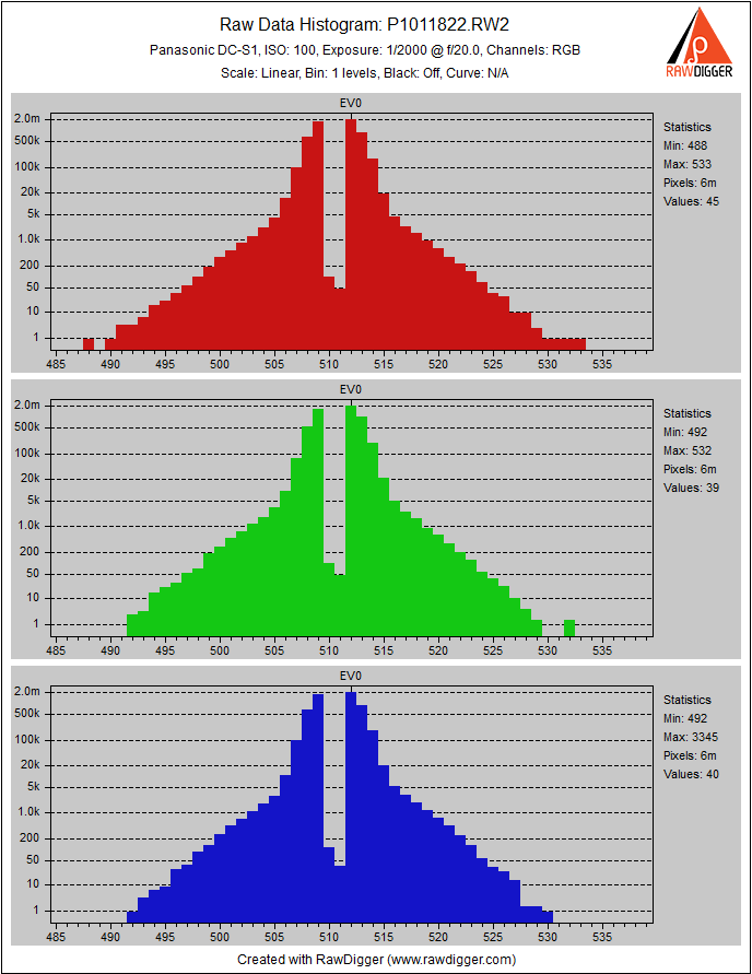

    Here's a black frame from a Panasonic S1:
    Which shows similar weird "anti-coring" around black. I posted this - or a very similar image - on DPReview a while ago. There was some thought that the notch was caused by some kind of rounding error, but I have trouble imagining a mechanism.
    Another weird thing is the exp(-abs(x)) distribution in the flanks.
    I tried looking at the red channel with the central half-dozen levels stretched from black to white, and looking at a real FFT of the same thing, but couldn't see anything obvious.
    I wondered if something was going wrong at the level of the ADCs.
    Were there some way of fixing the "anti-coring", the noise would look quite good.
    A (Read-noise * gain + conversion-noise) model doesn't work here, or for CrashpcCZ's camera.
    PNG, 32.5 KB, uploaded by JohnVickers on April 16, 2023.
    PNG, 6.3 KB, uploaded by JohnVickers on April 16, 2023.
  • April 16, 2023, 9:49 a.m.
    Did you get a copy of that photo, Jim?
  • Members 128 posts
    April 16, 2023, 10:14 a.m.
    Thanks. The log scale makes it clearer that the "anti-coring" notch doesn't go all the way dowm, in any channel, for any of the values close to black.
    The rest of the distribution is a bit different to what I get on Panasonic S1 - your noise distribution is less symmetric, with a bit of a tail at the high end.
    I don't know what that means.
  • Members 360 posts
    April 16, 2023, 11:03 a.m.
    I have no other explanation that the noise is not random. There can be many underlying reasons for that.
    Anyways I have neither reason nor tools to diagnose and do anything with such output. 😅
