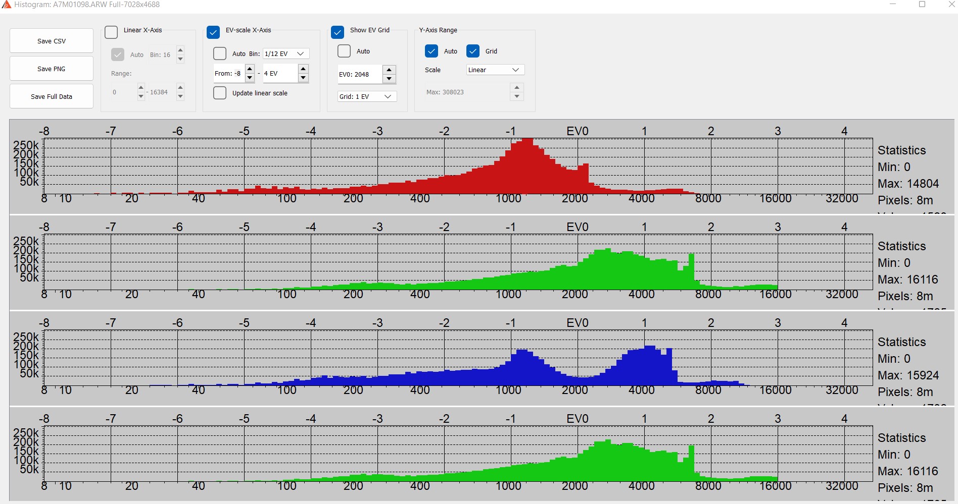

    PNG, 1.3 MB, uploaded by IliahBorg on April 16, 2023.
  • Members 1738 posts
    April 16, 2023, 11:31 p.m.
    You are paying attention to the wrong thing. Forget the EV scale. You don't need to understand it to understand how to use RD to check exposure, and you are drawing the wrong conclusions from it.

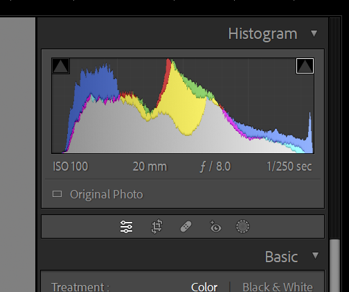

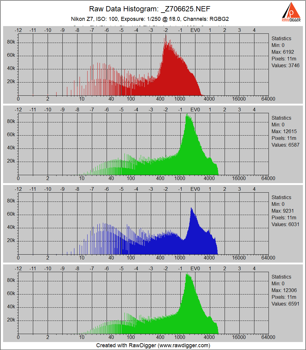

    April 16, 2023, 11:45 p.m.

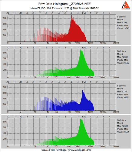

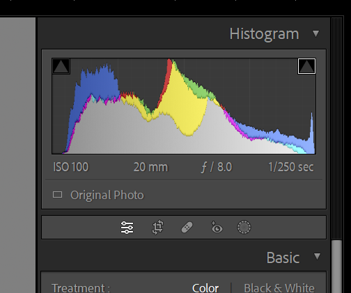

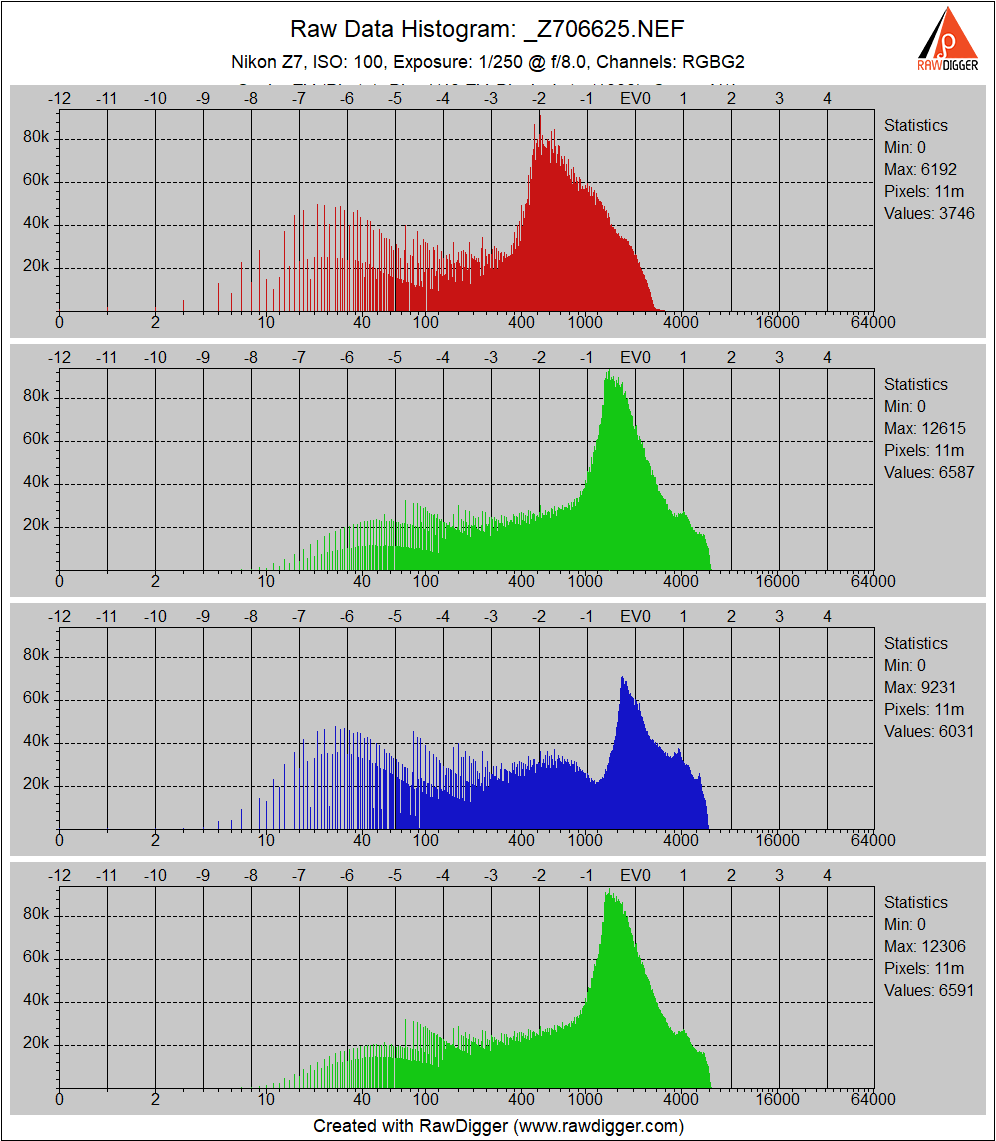

    Scene with Z7:
    Lr histo with default settings:
    [nef default lr.png]
    (/a/MWhw0zpzWY6Zx5EZm8QB0DEaIz8vg35EGvX133DMN5Ns7eecyWSp62O9j9HjUc5x/3791/?shva=1)
    RawDigger Histo:
    Lr histo looks like the exposure is blown. RD histo show that it's a long way from being blown. The Z7 is among the worst cameras I've dealt with recently in this regard.
    PNG, 54.8 KB, uploaded by JimKasson on April 16, 2023.
    PNG, 71.7 KB, uploaded by JimKasson on April 16, 2023.
    JPG, 228.3 KB, uploaded by JimKasson on April 16, 2023.
  • Members 2663 posts

    the lightroom histogram is not blown at all. and what EV values were set on the RD histogram ?
  • Members 976 posts
    April 16, 2023, 11:55 p.m.
    Neither is.

  • Members 256 posts
    April 17, 2023, 12:15 a.m.
    That's right, EV 0 is not relevant, the clipping threshold is normally 3 stops to the right of where"EV 0" on the scale is normally positioned. Look at any extremely overexposed image with RawDigger, wherever the line piles up on the right is the clipping threshold - anything at that line is toast.. With a not-overexposed image, the distance (in EVs) from the right side of the rightmost histogram to that same clipping point is how much more you could have exposed without clipping highlight detail.It's really not that complicated

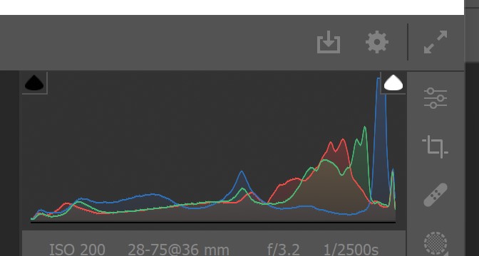

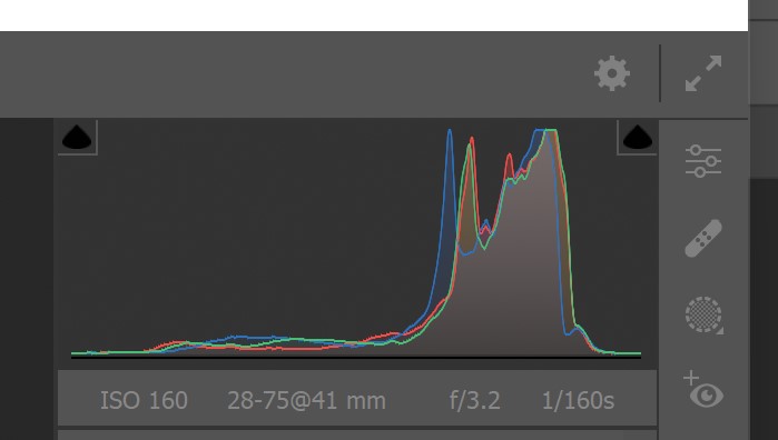

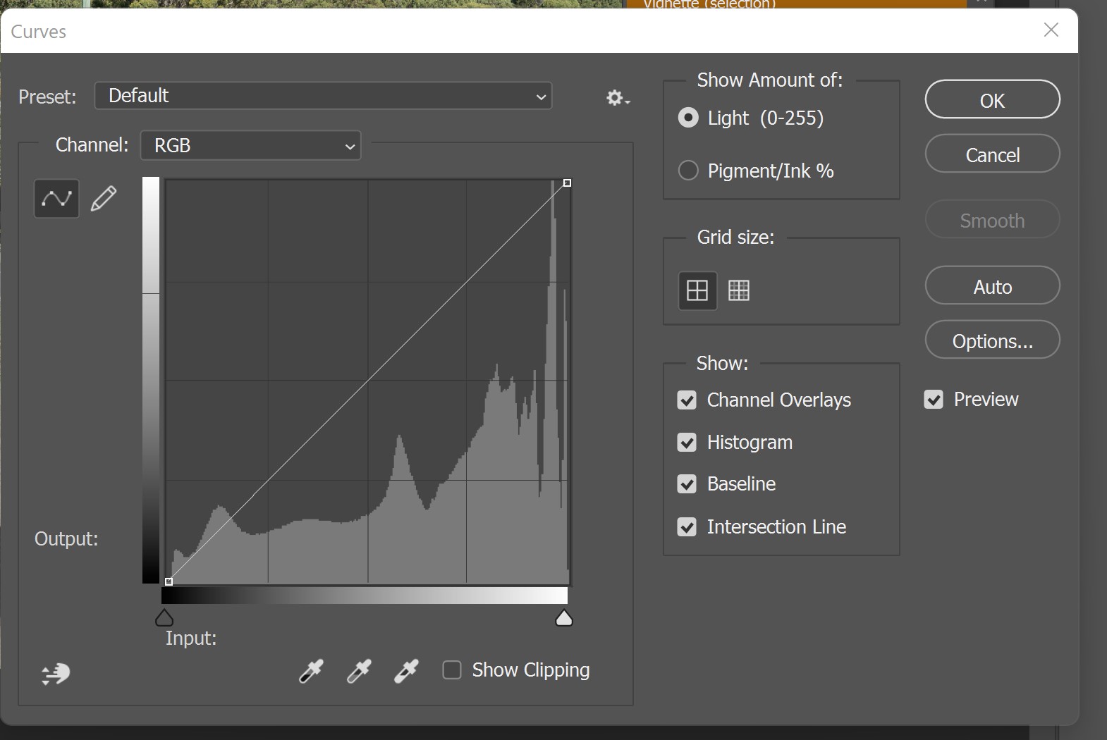

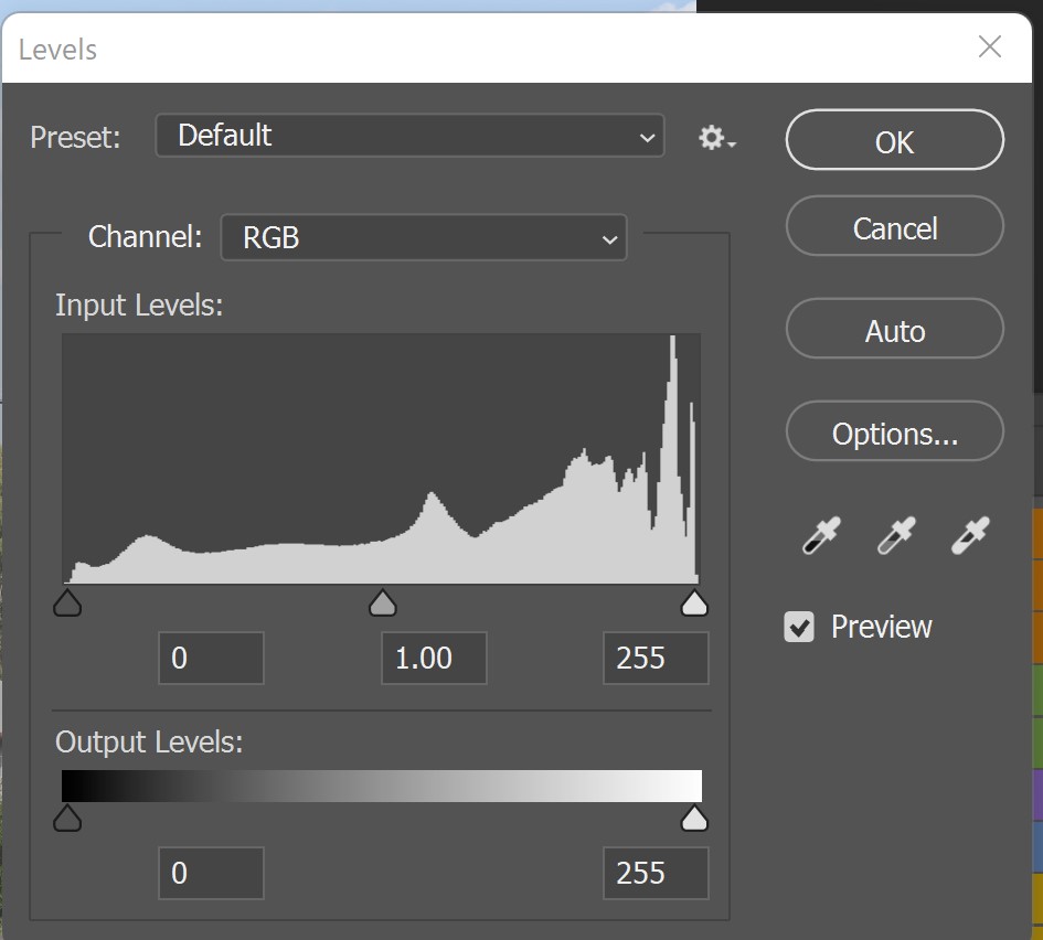

    April 17, 2023, 12:16 a.m.
    checkmate. in camera settings from a guy that has been deleted from these forums.

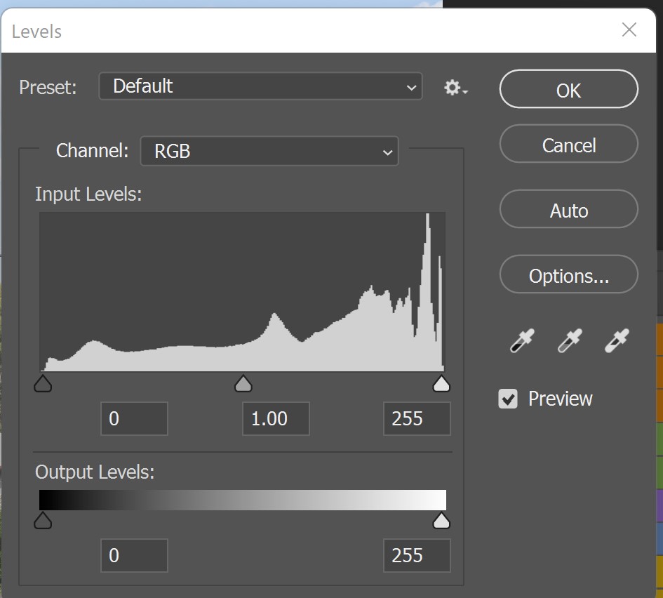

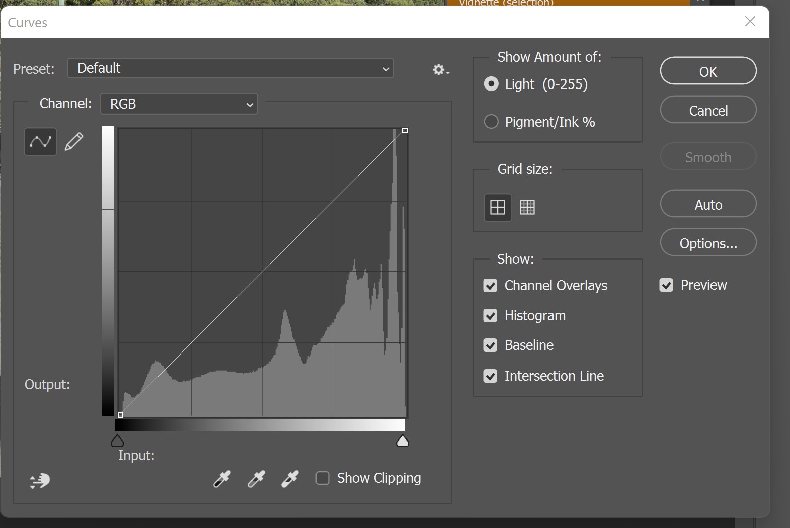

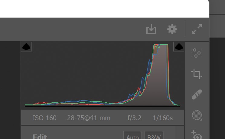

    image i just took.
    JPG, 69.6 KB, uploaded by DonaldB on April 17, 2023.
    JPG, 133.7 KB, uploaded by DonaldB on April 17, 2023.
    JPG, 26.4 KB, uploaded by DonaldB on April 17, 2023.
    JPG, 424.9 KB, uploaded by DonaldB on April 17, 2023.

    April 17, 2023, 1:11 a.m.
    Again, you’re not looking at RAW histograms here.This is the RAW file AFTER your editor has processed it. This histogram here doesn’t tell you anything about RAW exposure. It might very well look similar to what you see in RawDigger, but it could easily appear to be under or overexposed as well. That’s the point, it’s not representative of the RAW file and never will be.
    Frankly, if your images are clean enough, the highlights look good with some adjustment, and they generally look good overall (from what I’ve seen, they do), I would say that enough is going right with your exposures and maybe you might want consider taking a pass on some of the finer points of RAW exposure. Folks have producing great images for nearly 200 years without ever seeing a RAW histogram.
