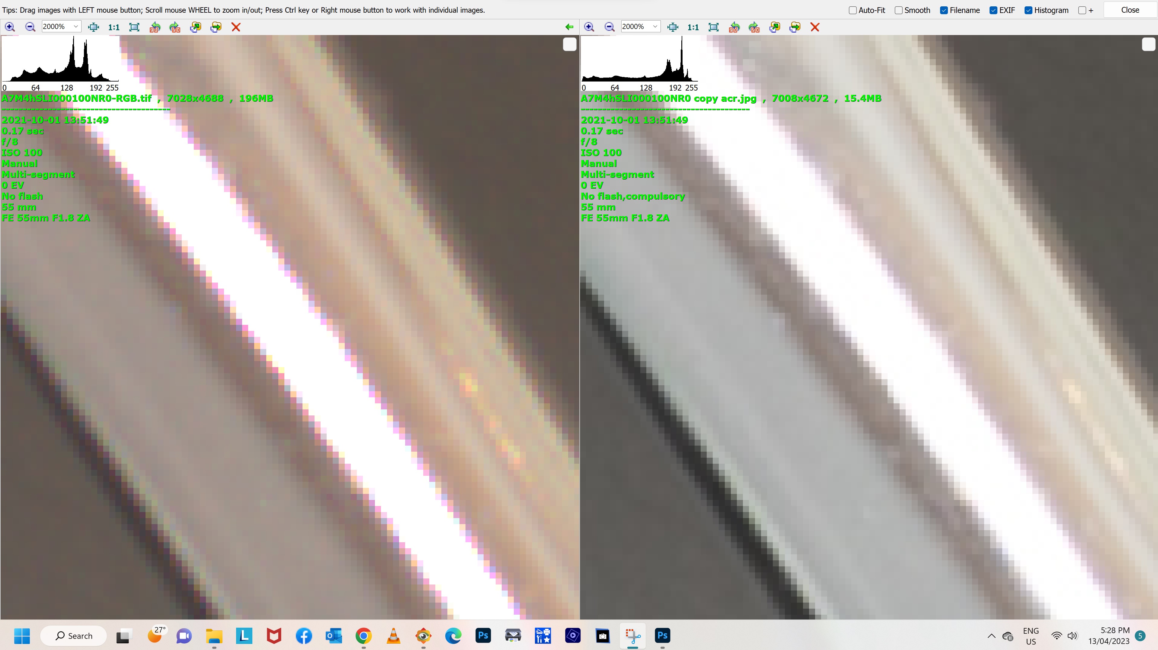

    To me the "Fiddlers" bottle reflextions look like clipping, while the RAW data shows none. What am I missing?
    And the brush also.

    This file is about one stop underexposed from ETTR, assuming a 14 bit ADC.

    Yes, there are a few small things to know when interpreting a raw histogram. You want to know what raw level data actually starts clipping at (which is often not the max value of a bit depth), and also, what raw level data becomes non-linear at, if a camera offers part of the non-linear range. My first DSLR (and my first camera with raw files), the Canon 10D, went non-linear in the highest raw values at ISO 100. ISO 200 clipped at about 22K electrons, but ISO 100 clipped at about 55K, 25% more than expected based on ISO 200. Some people had stated the FWC of the 10D at about 44K, but apparently they looked at SNR well below clipping and just extrapolated the FWC from that without checking for non-linearity.

    It isn't just a difference in level, either. Some raw "colors" explode when converted to display RGB, like red tulips, which can easily flood the top of a display RGB histogram and detail-less magenta areas in the image, but show little "energy" in the raw histogram from the red tulips.

    It is useful, but not as useful as a raw histogram when you want raw ETTR without unwanted clipping.
    If you are only interested in an actual ISO 100 exposure index when the camera is set to ISO 100, then by all means, look only at the histogram of the in-camera display image; it won't steer you wrong.
