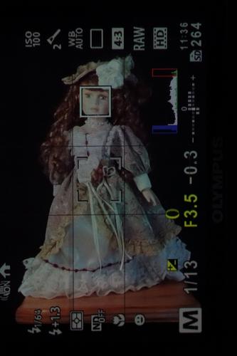

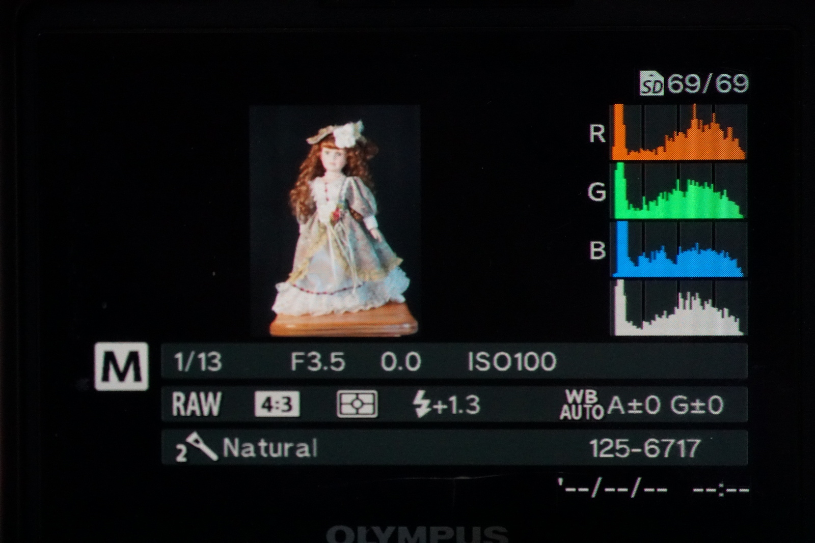

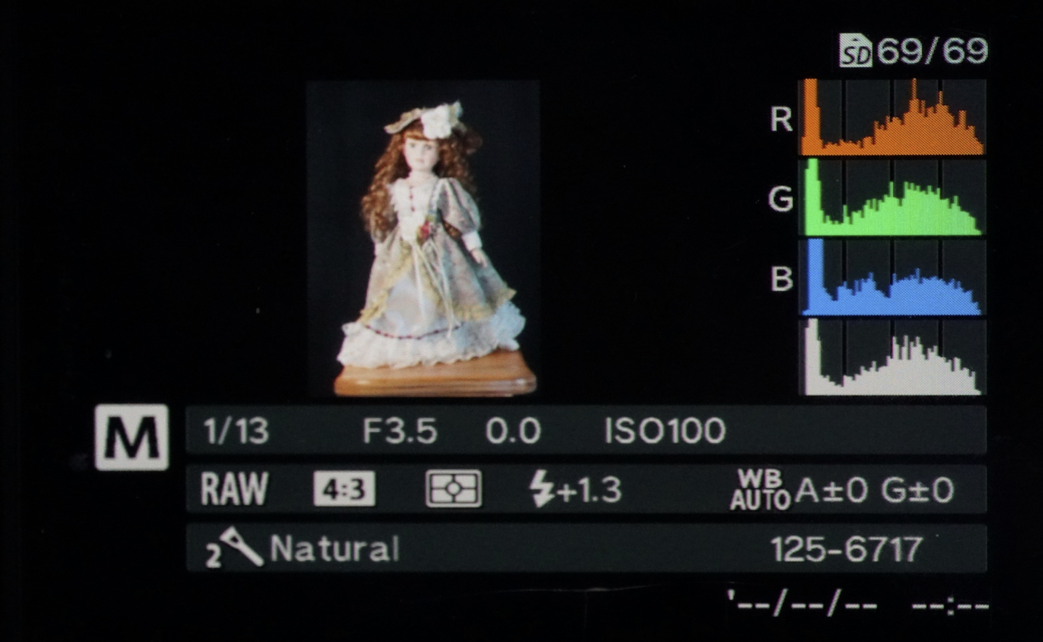

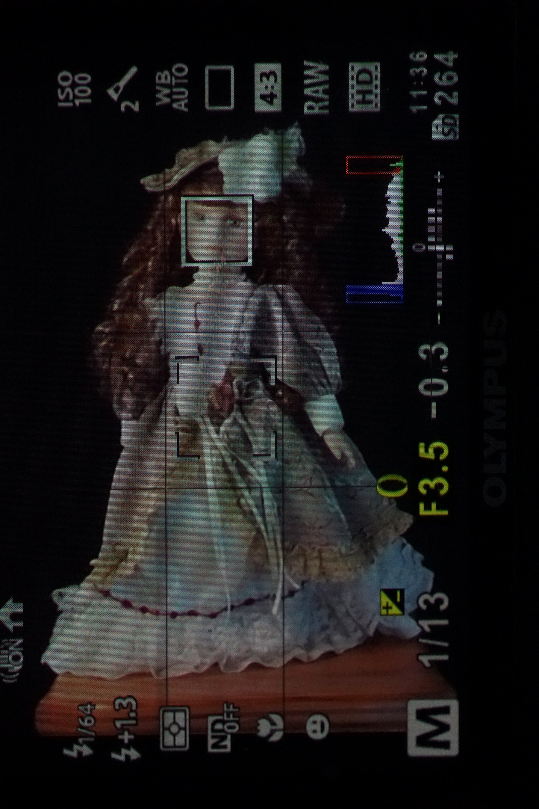

    @IliahBorg has written:
    @DonaldB has written:
    preview histogram
    6717 xz1 ph.JPGCamera: ILCE-6300/SONY ISO 8000 159mm(106mm) 1/1000.0 sec f/6.30
    Live histogram
    What happens with those histograms when you start gradually lowering the exposure?
    they change acordingly, same as my other cameras

    heres the file have a look how acurate it is.
    1drv.ms/i/s!ArStsPjQ301PmUbgamkMYtyrG0ou?e=Tf8Wr1
    here is the olympus xz1 i axcidently posted the wrong file.

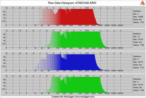

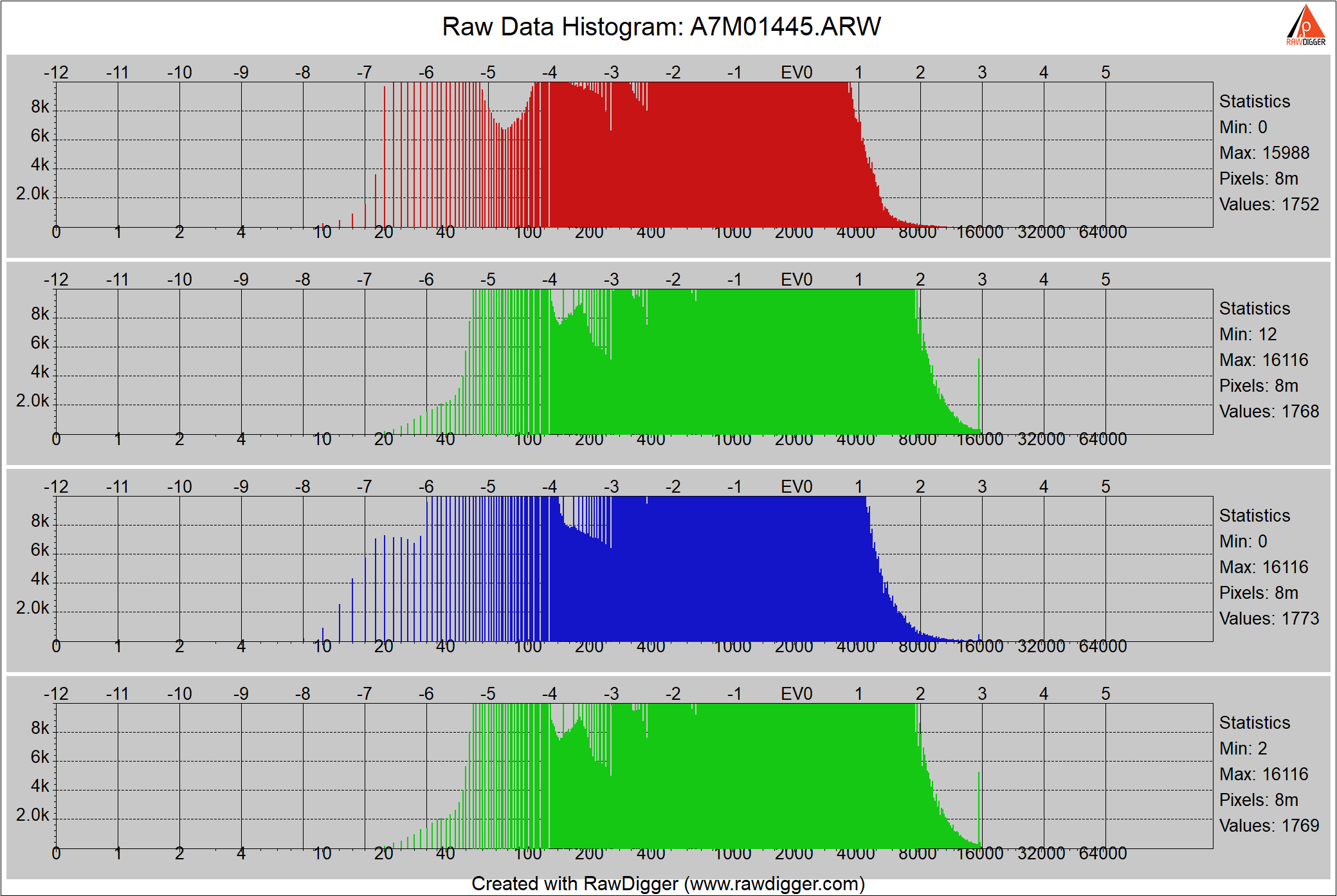

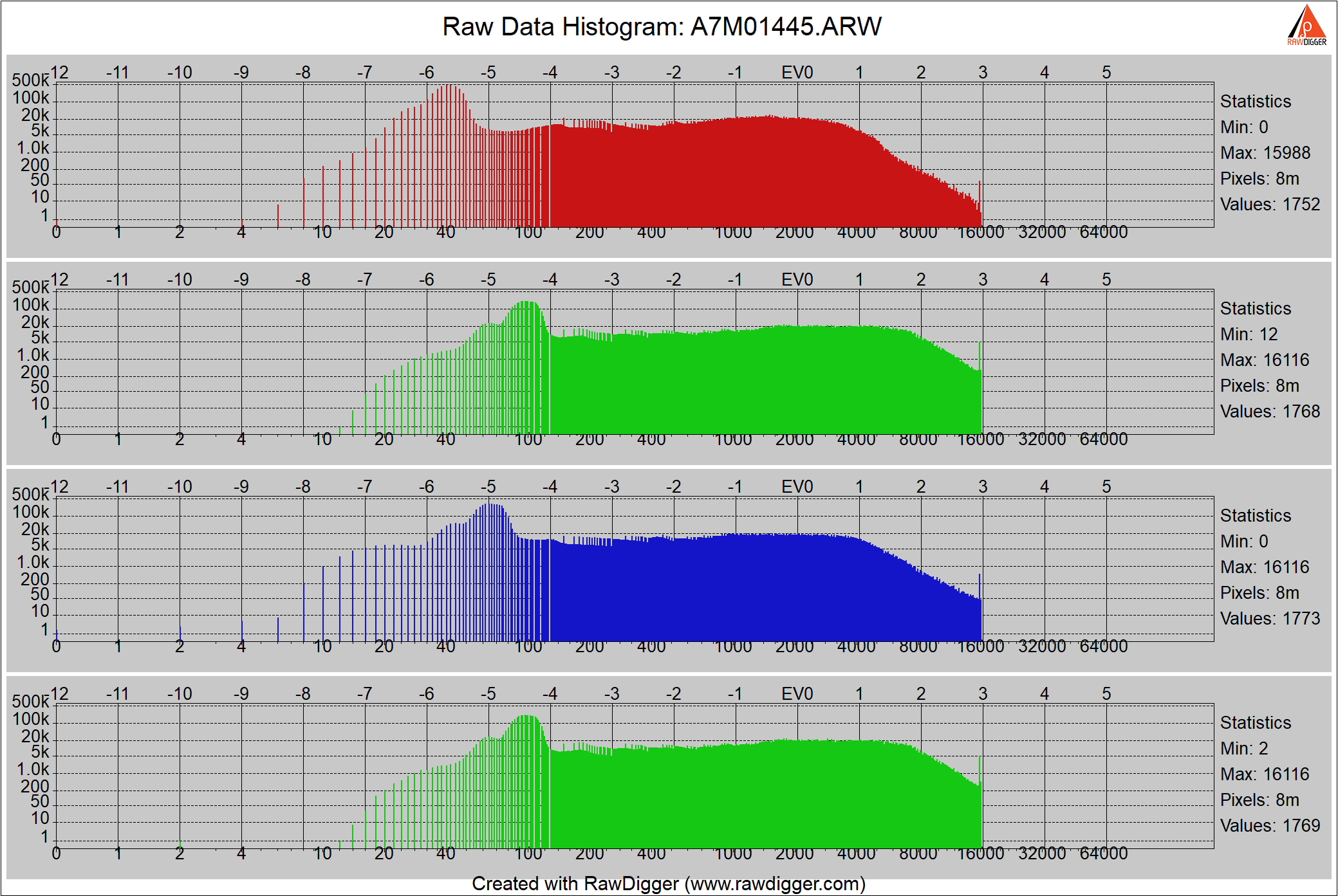

    There are specular reflections in the image.
    PNG, 89.5 KB, uploaded by JimKasson on May 20, 2023.
    PNG, 101.8 KB, uploaded by JimKasson on May 20, 2023.

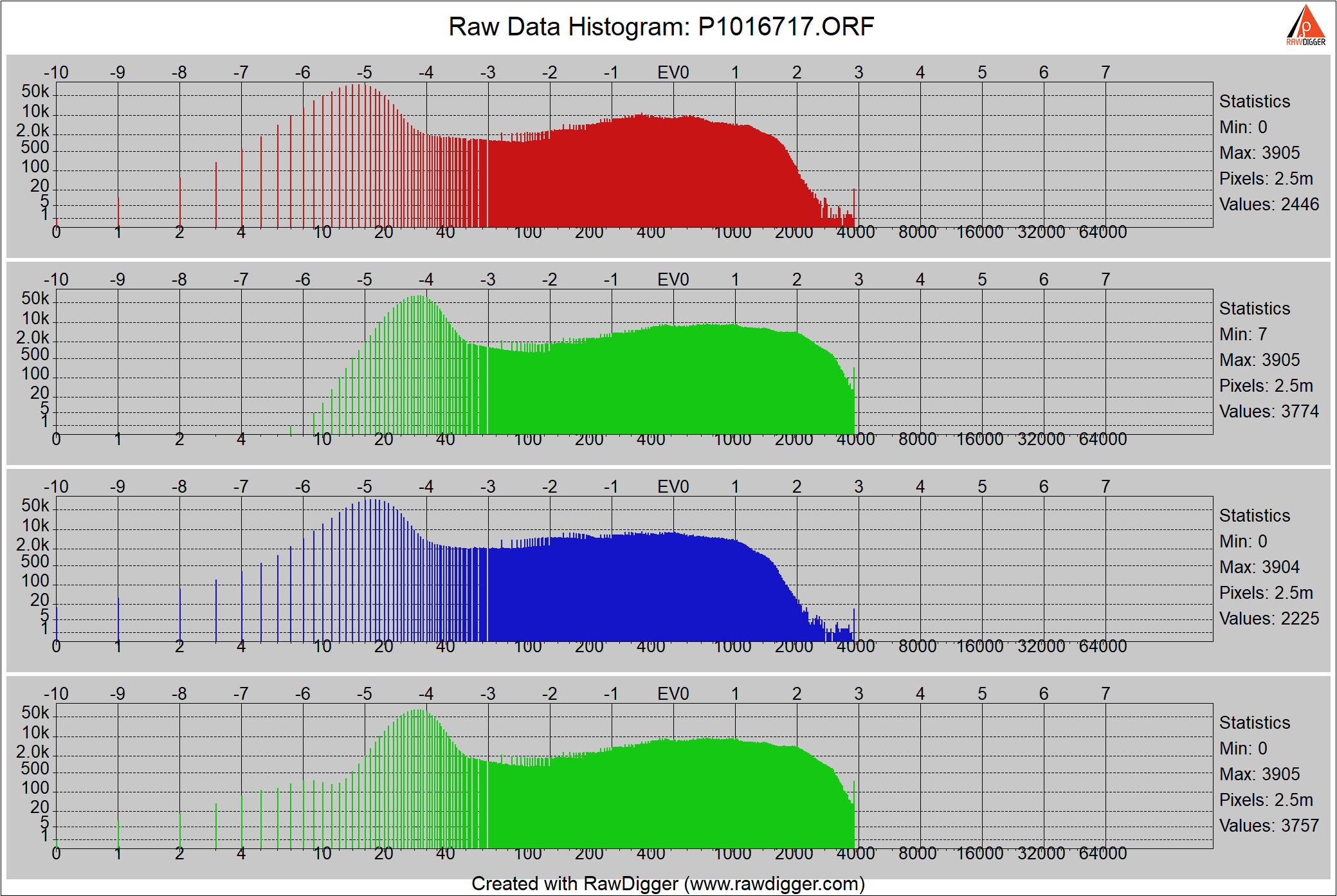

    sorry Jim here is the XZ1 posted the wrong link.
    PNG, 92.3 KB, uploaded by JimKasson on May 20, 2023.
    PNG, 99.5 KB, uploaded by JimKasson on May 20, 2023.

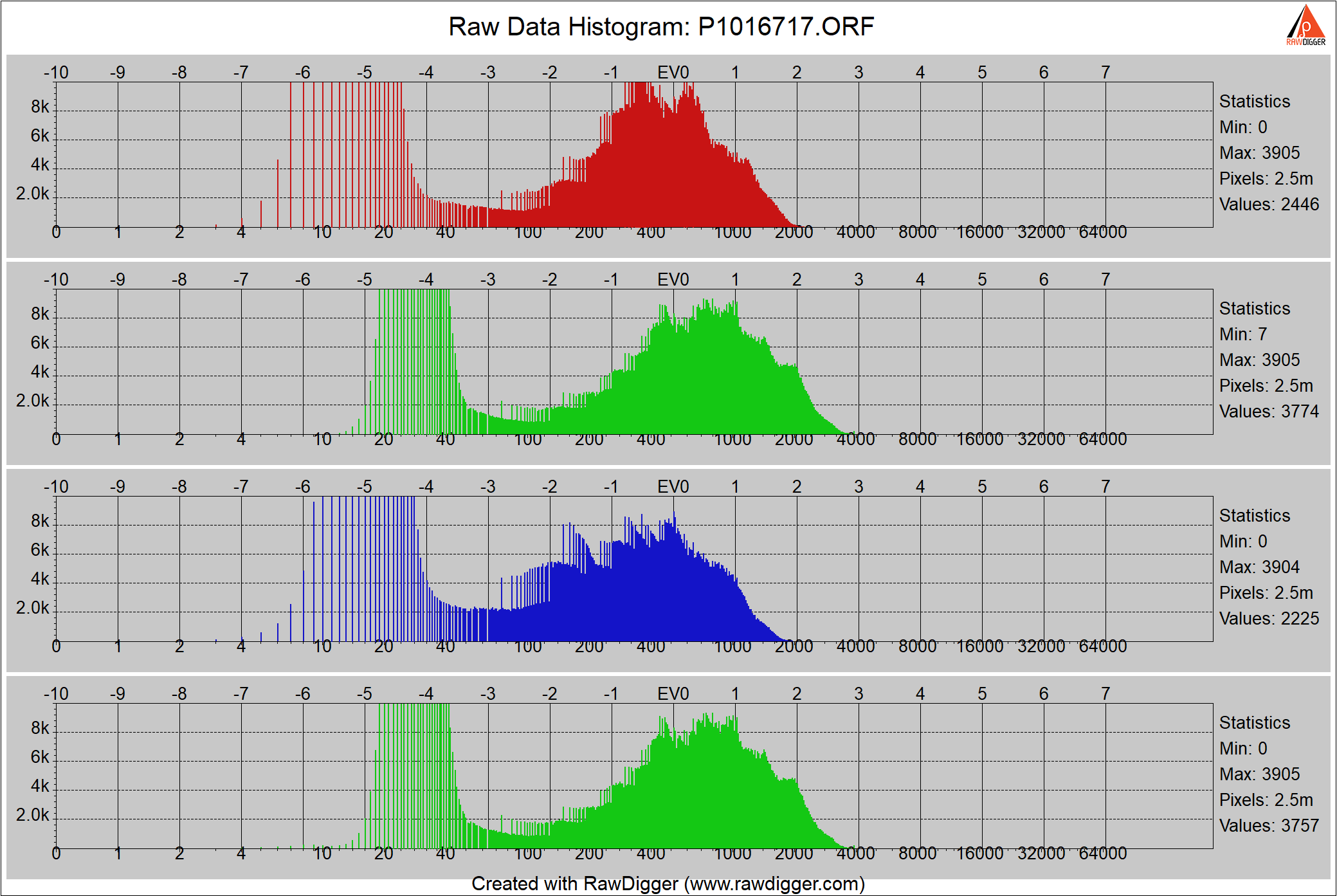

    @JimKasson has written:
    The back of camera histogram has the red channel hotter than the green. But in the raw file, the red channel is significantly down from the green channels. So is the blue raw channel, which looks on the back of camera image to be close to the green.
    PNG, 2.4 MB, uploaded by JimKasson on May 20, 2023.

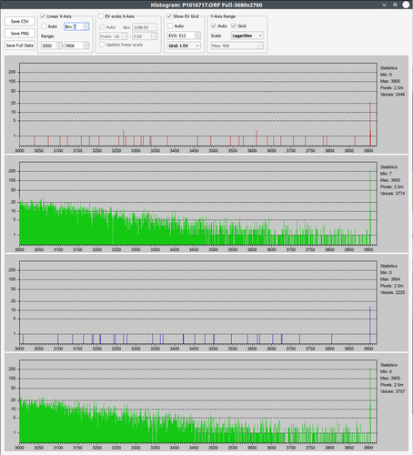

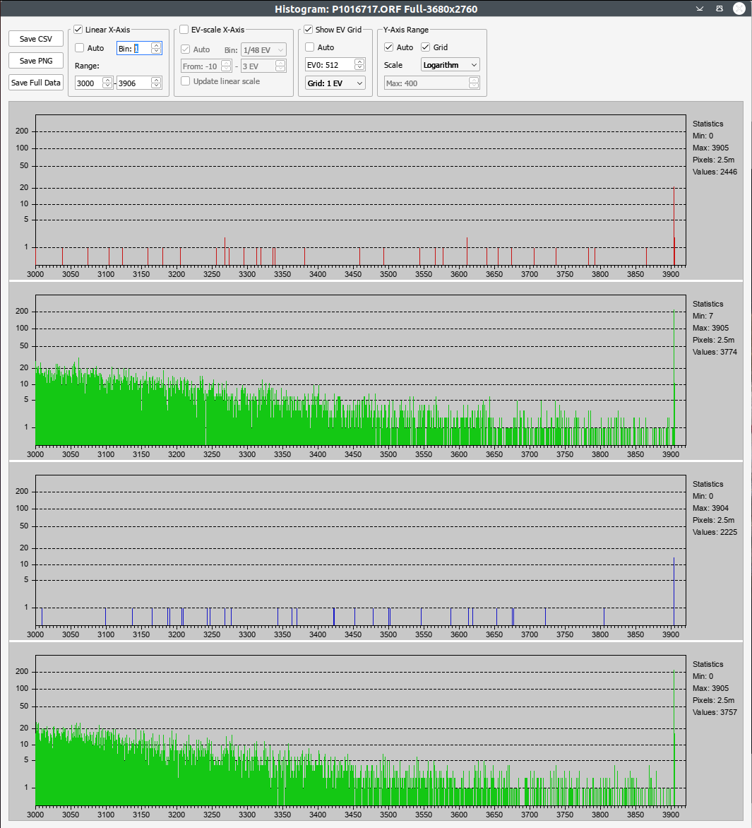

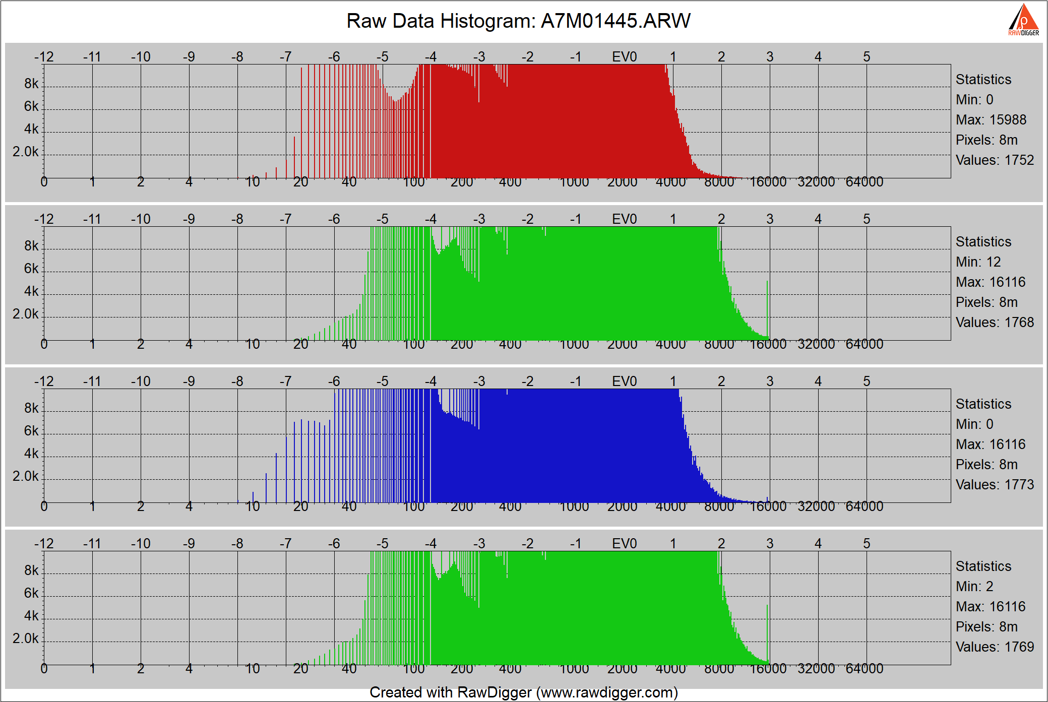

    IliahBorg
    Members 976 posts
    May 20, 2023, 10:10 p.m. May 20, 2023, 10:10 p.m.
    that would only confuse me
    Here is the histogram of the highlights:
    - all channels are clipped in raw
    - there are specular reflections
    In-camera histograms didn't tell you that.
    This may be irrelevant for the purpose of this shot, but it isn't universally irrelevant, far from it.
    Have you checked what's going with red flowers?
    PNG, 79.2 KB, uploaded by IliahBorg on May 20, 2023.
