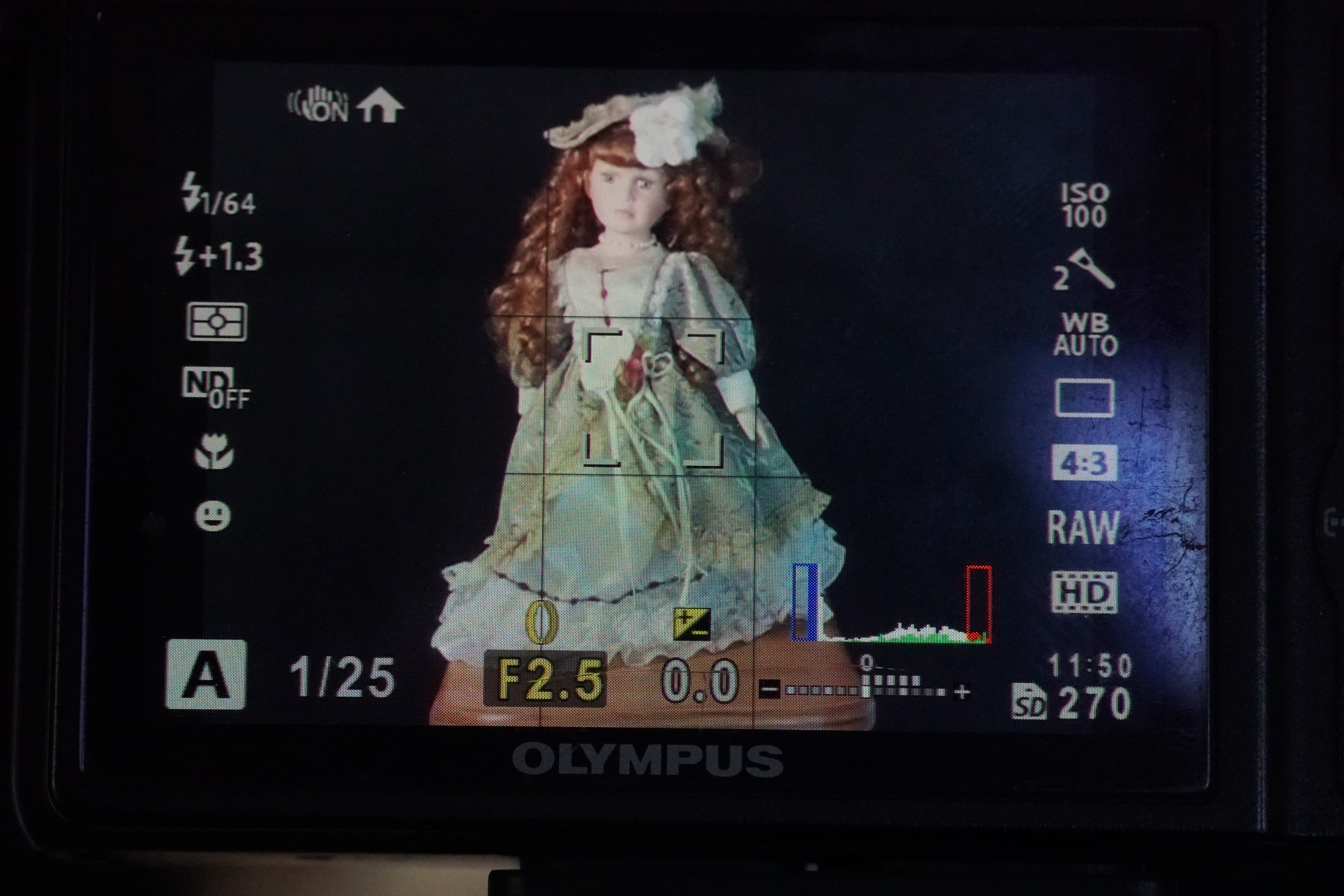

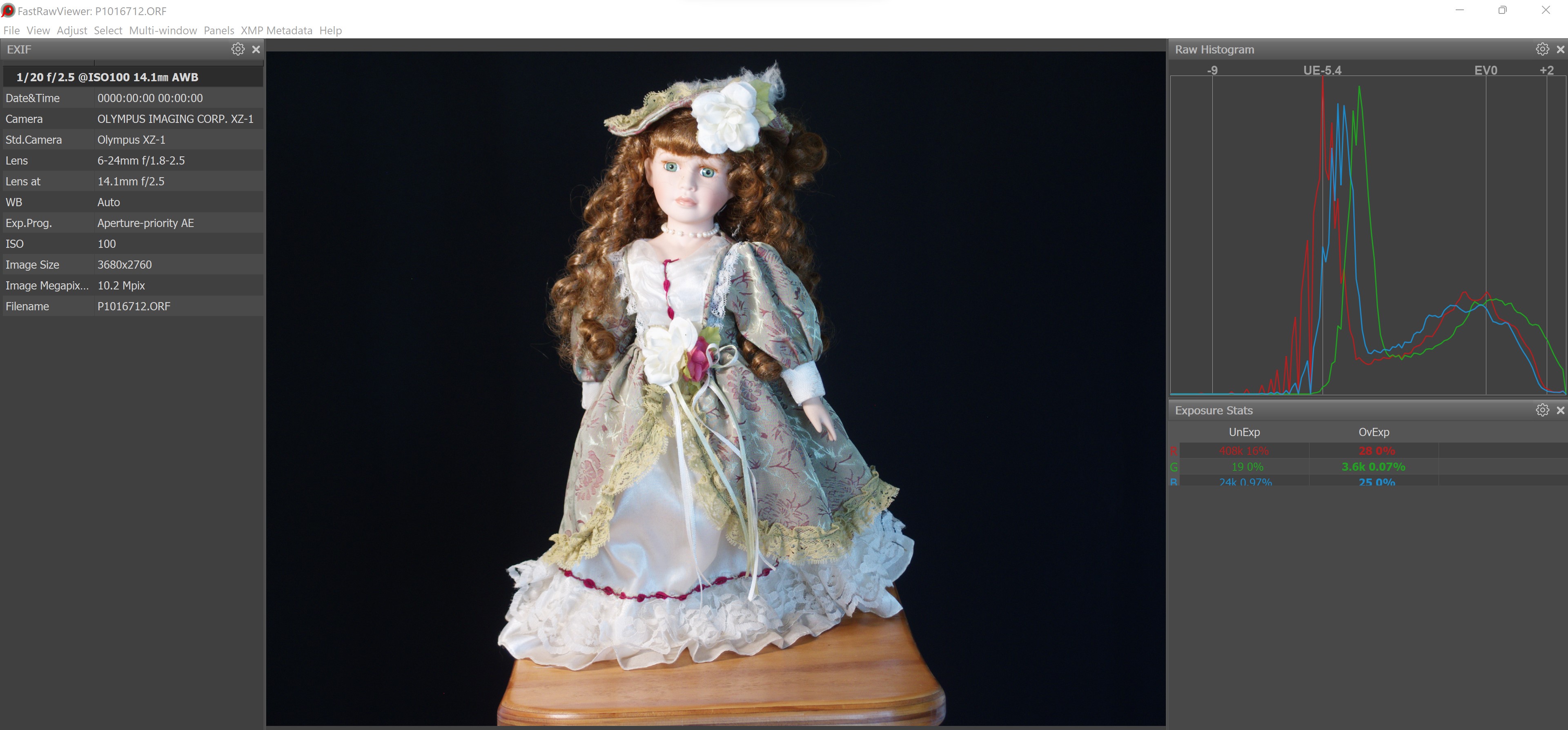

    seriously Jim, i think you need to rework those tests.
    JPG, 692.2 KB, uploaded by DonaldB on May 20, 2023.
    JPG, 7.9 MB, uploaded by DonaldB on May 20, 2023.

  • Members 2665 posts
    May 20, 2023, 12:15 a.m.
    Funny that you should say that. because the exposure settings on that camera were always different than any other camera i owned. now i will compare it to my a74.
