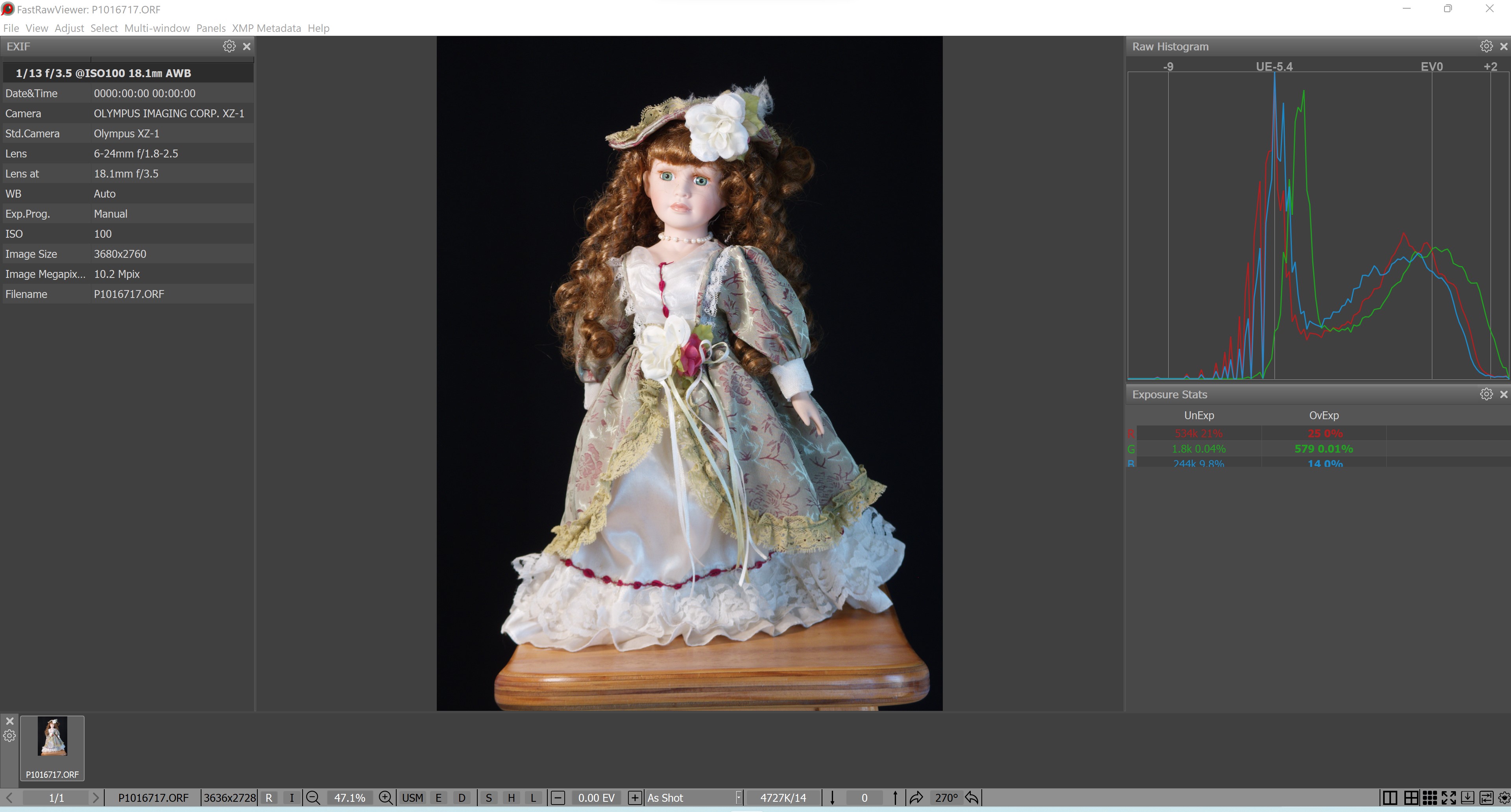

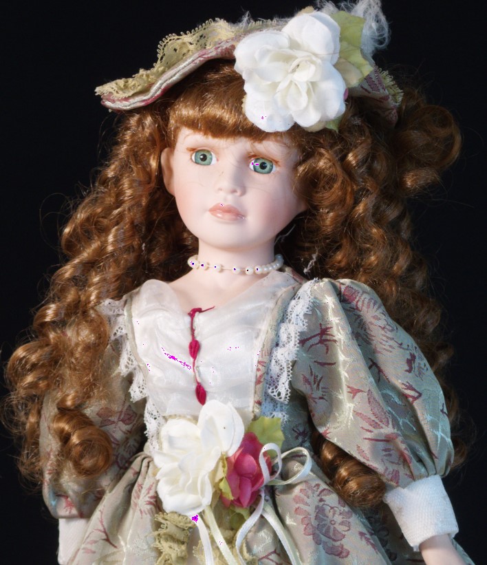

    Another set
    had to klean up my desktop theres that many images .

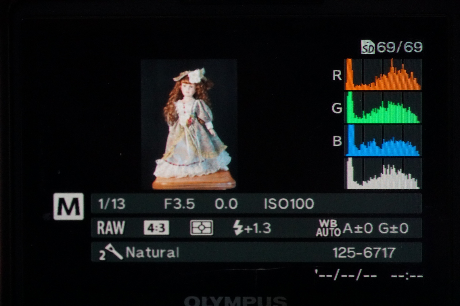

    preview histogram

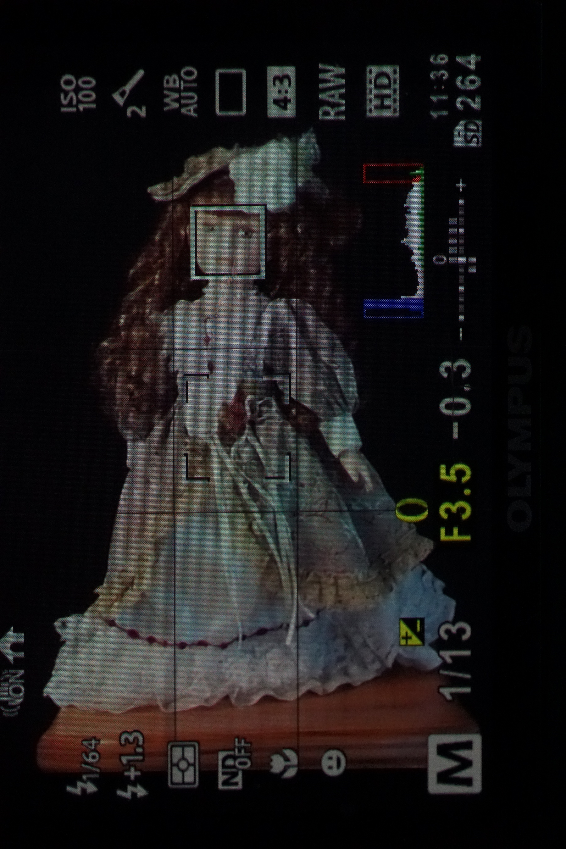

    Live histogram
    this is showing clipping
    JPG, 144.8 KB, uploaded by DonaldB on May 20, 2023.
    JPG, 1.5 MB, uploaded by DonaldB on May 20, 2023.
    JPG, 402.8 KB, uploaded by DonaldB on May 20, 2023.
    JPG, 644.2 KB, uploaded by DonaldB on May 20, 2023.

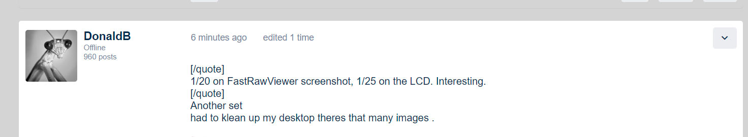

    @DonaldB
    On a side note:
    BBcode, like HTML tags, have no forward slash "/" in the opening tags. The closing tags have a forward slash.
    Also, opening/closing tag pairs need to match otherwise you end up with "ugly" looking posts with messed up code being displayed.
    In your above post, all you need to do is delete the forward slash in the opening quote tag.
    JPG, 39.7 KB, uploaded by DannoLeftForums on May 20, 2023.
  • Members 2654 posts
    May 20, 2023, 4:06 a.m.
    awesome thanks for that, i hope i can remember for the next time.

    The raw histogram tells you how far your channels are from clipping in the raw data. If there is at least 1.33 stops of unused headroom, then you know that you could have exposed 1.33 stops more, and pulled the conversion down 1.33 stops.
    There are more or less 3 points at which clipping can occur. The first is when the photosites are being read out; any photosite that has too much charge will be recorded as the highest number in the bit depth, by the ADC. Cameras rarely give you that real, initial raw data anymore, although many early digital cameras with raw did. Many cameras will multiply the original raw numbers and do additional clipping before writing the raw file. Then finally, the converter may cause clipping where there was none in the raw file.

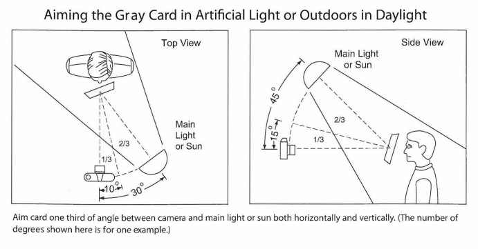

    May 20, 2023, 12:55 p.m.

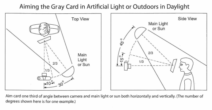

    "Meter readings of the gray card should be adjusted as follows:
    - For subjects of normal reflectance, increase the indicated exposure by 1/2 stop."
    "ln use, the Gray Card is placed in the same illumination as the main subject, and angled slightly toward the primary light source. An exposure reading is then taken off the 18% gray surface of the Gray Card ."
    "The gray side of the card reflects precisely 18% of the incident light, while the white side reflects 90%. The KODAK Gray Card is manufactured to extremely tight tolerances. Allowable deviation in reflectance is 1%, an insignificant variation for any photographic process."
    Kodak, "How to Use KODAK Gray Card"
    PNG, 125.8 KB, uploaded by IliahBorg on May 20, 2023.
