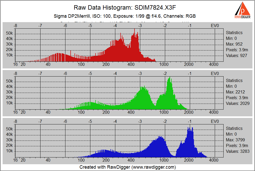

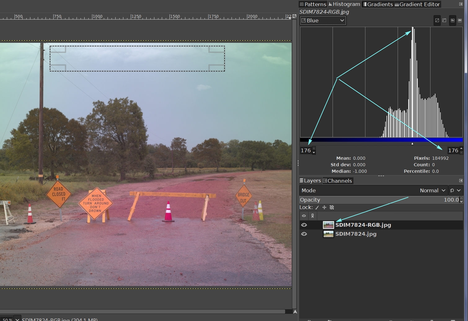

    March 1, 2024, 10:58 p.m.
    I found a suitable Sigma DP2 Merrill shot and examined it's raw histogram:
    Looks like the blue peaked at -1 stops (EV).
    Then I converted the raw to an sRGB JPEG:
    The blue peaked at 176/255 = 0.6902. Accounting for gamma that would be about -1.2 stops in the raw.
    So next to no "exposure latititude" in the raw for the afore-mentioned camera model according to that test and certainly nowhere near the claimed 4-5 stops.

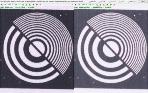

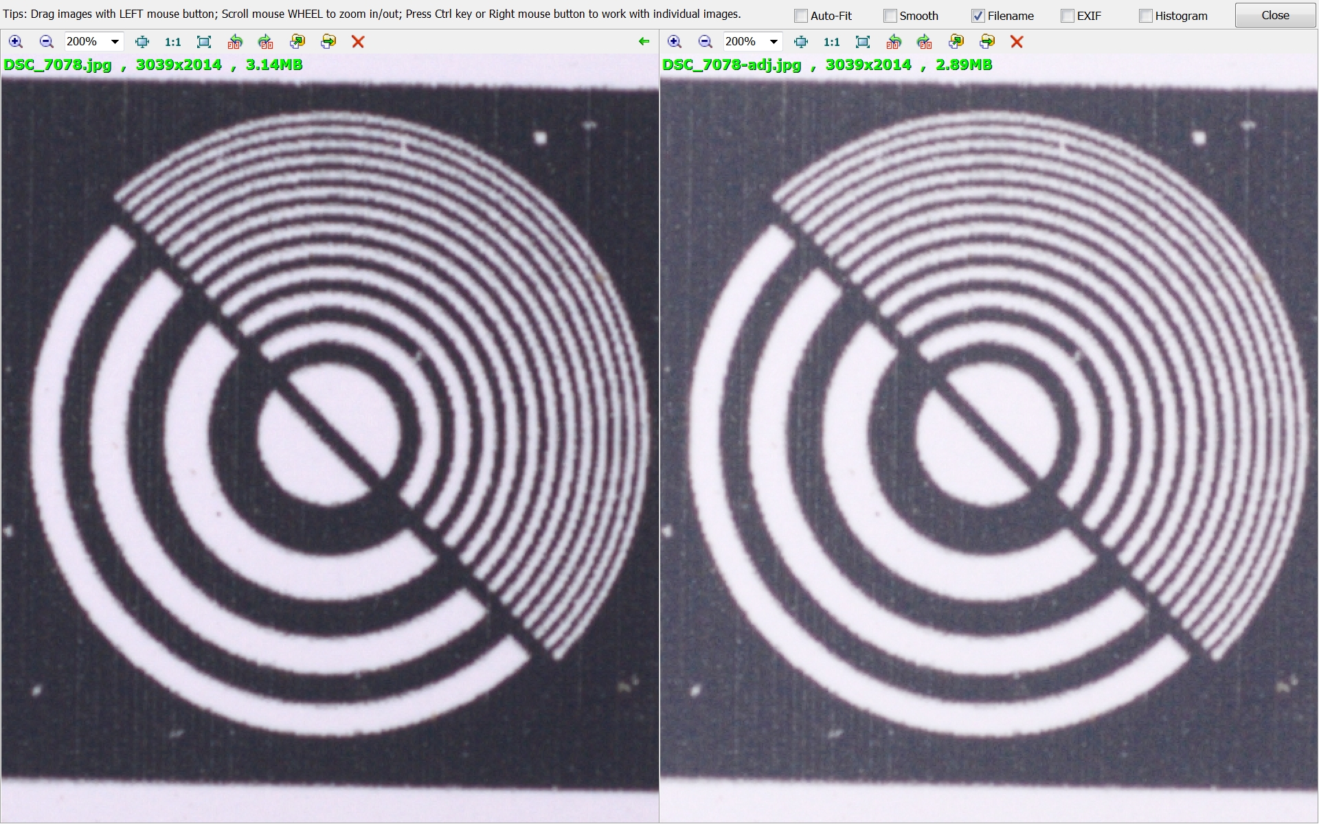

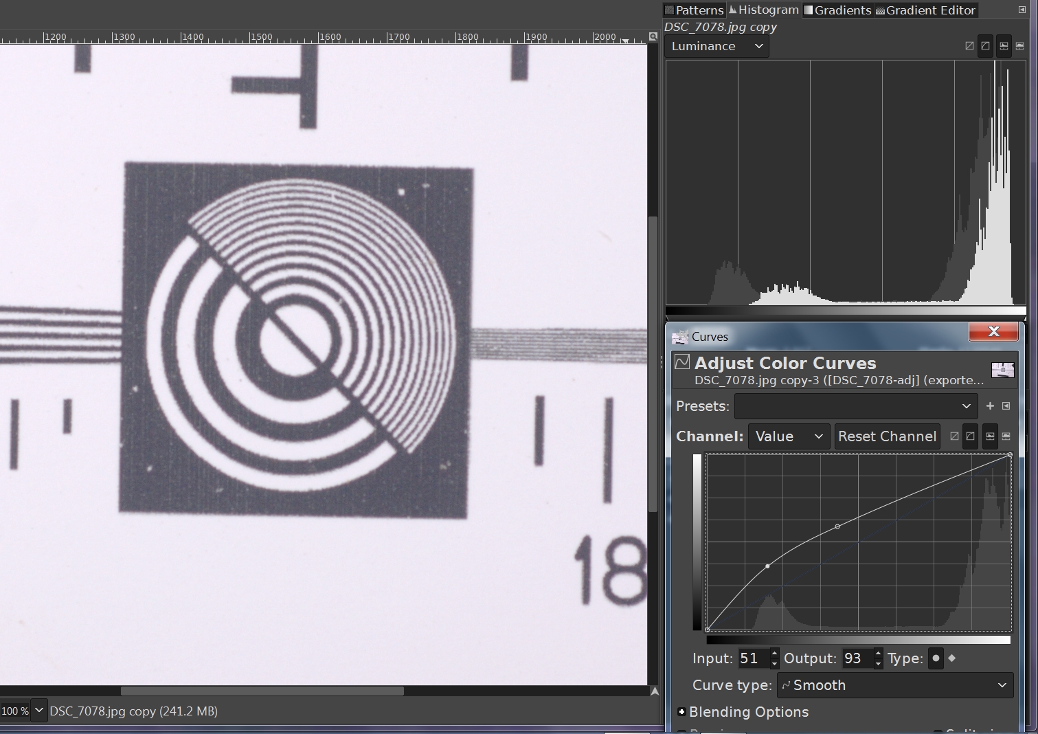

    March 6, 2024, 4:03 p.m.
    Thanks for the clarification. I used to have a 6 MP Nikon D50. I'm tempted to go and measure some "JPEG ranges" ...
  • Removed user
    March 6, 2024, 5:05 p.m.
    I found a D50 test JPEG and raised the "shadows" in Curves:
    The result could be said to be usable:
    Ignoring gamma, the JPEG "range" did change, not unexpectedly:
    adj: 51-248 range log2(248/51) = 2.28 stops
    orig: 29-244 range log2(244/29) = 3.07 stops
    Posted for what it's worth ... could it be that our concept of "JPEG range" differs?
