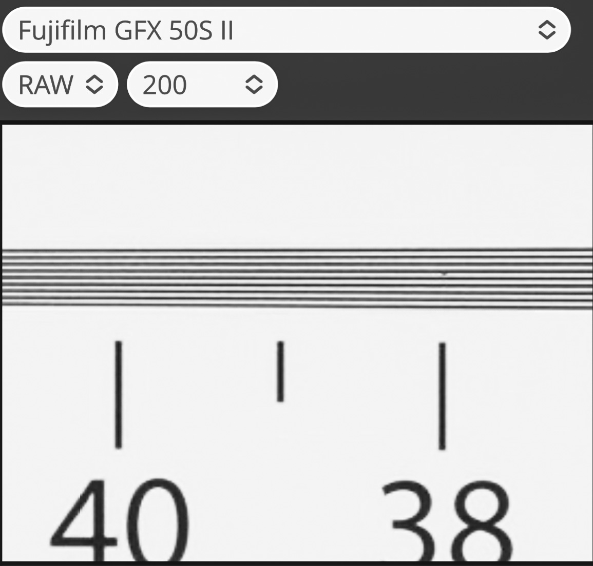

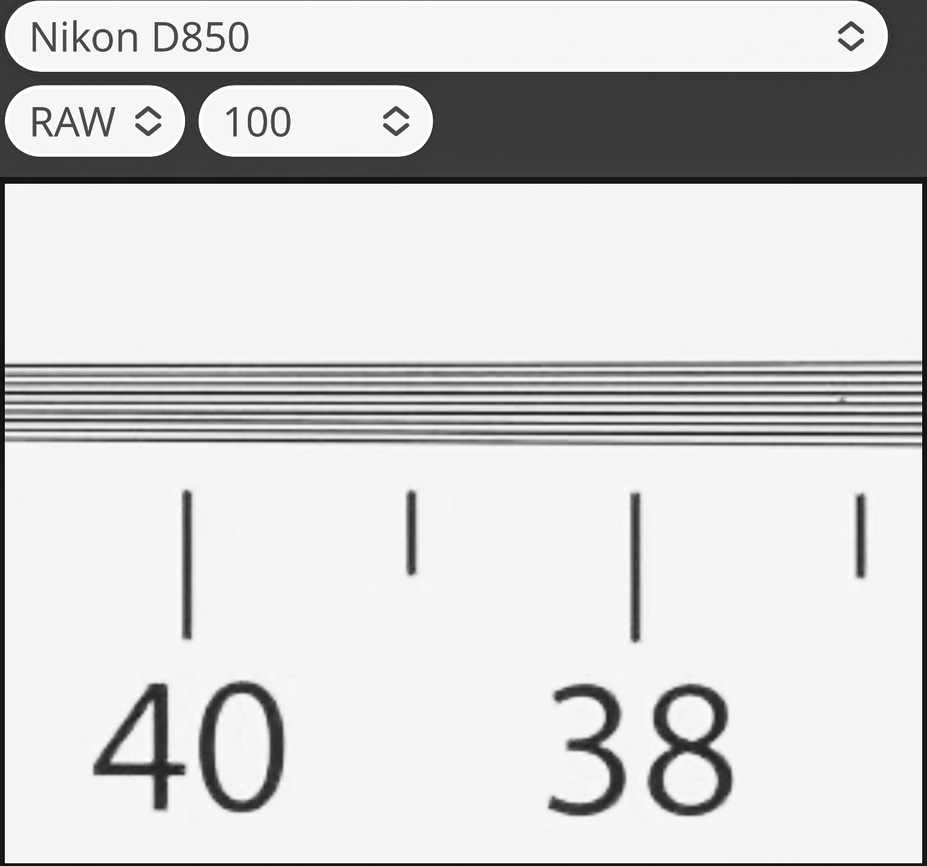

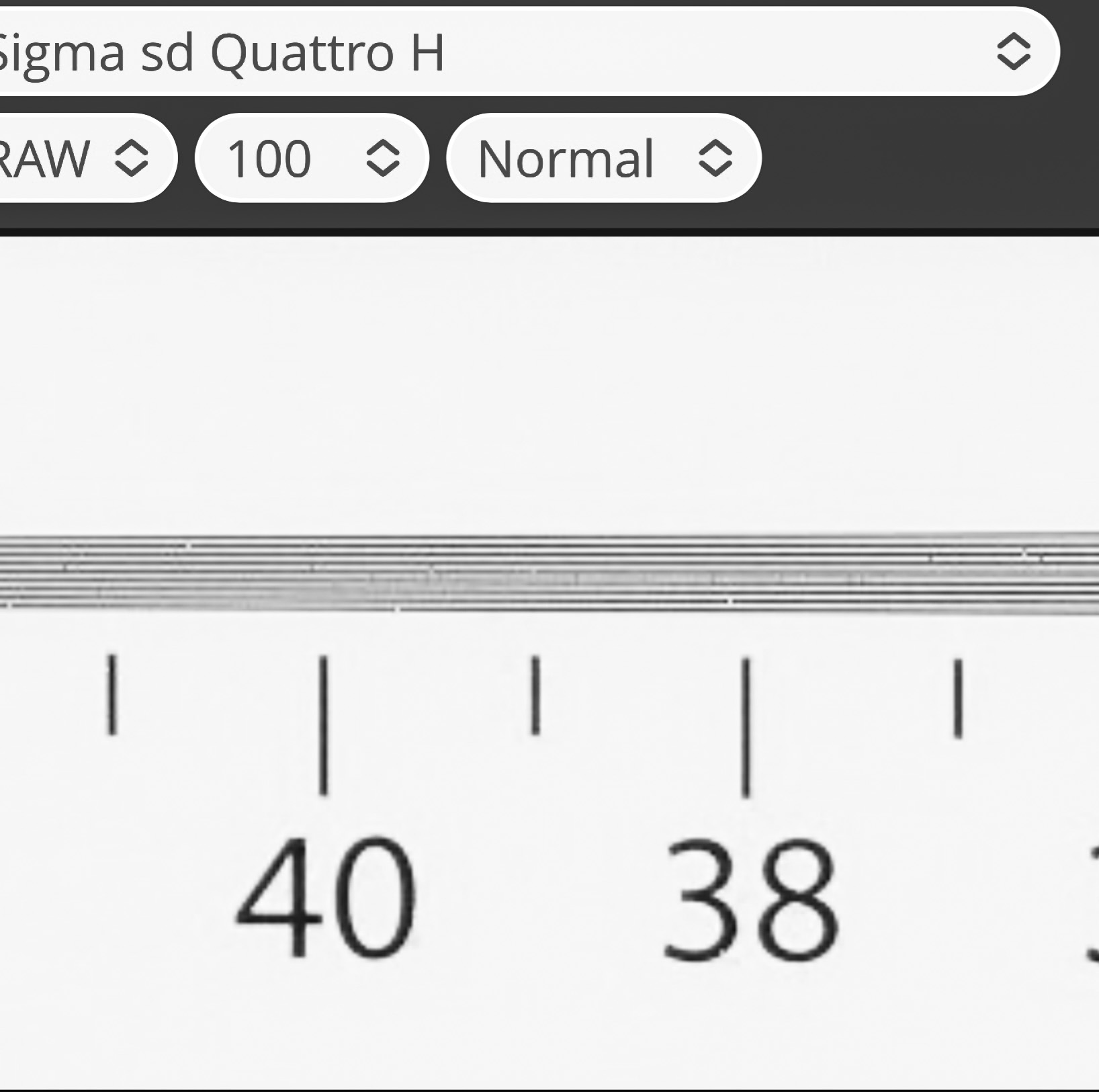

    Where the Sigma shines…and where the resolution benefit over Bayer lies is in colour information. For b&w, that benefit is greatly reduced. The Sigma in question has nowhere near 50mp of resolving power. See below how the Sigma compares to 50mp Bayer and 45mp Bayer.
    While it is a great camera, the resolution benefits for b&2 are often great.y inflated above reality
