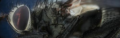

    July 5, 2023, 9:24 p.m.
    this is a fast and dirty test only (120 images should have been 200),first time ive stiched a macro. dont know why you would want to as 30meg image can print huge 5x7 foot print. this stitch could easily print 10 foot wide. it was a very simple stich in photoshop.
    JPG, 47.5 MB, uploaded by DonaldB on July 5, 2023.
