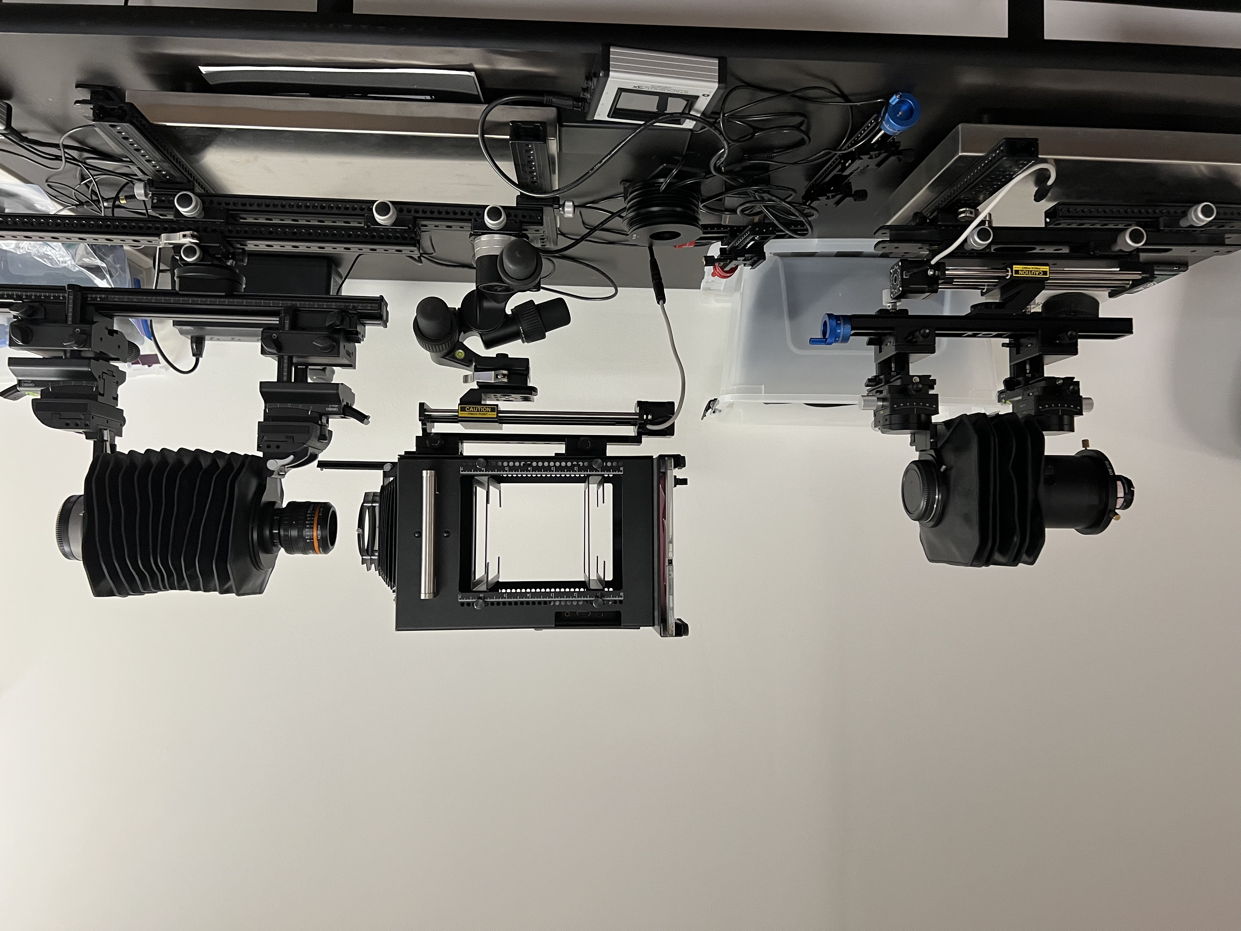

    Made some progress today...

    Wow - that looks great. Congrats! Your setup seems very sophisticated. Mine looks a bit like a Fisher Price version of that. 😅
    What is the device your HR Digaron lens is pointing towards?

    Jim has a super scanner there. One day, I wanna make one myself. All I have is an old Nikon PB-4, PS-4 and 105mm Bellows Lens. So it only does 135 film and I have MF film I can't scan.
    Glad to see it made the move OK. Even gladder to see Jim felt like putting it all back together. :)
    That box started out as a Film Toaster, but has been modified quite a bit. I'm using it for film scanning.

    Very interesting. Found your description of it here:
    blog.kasson.com/gfx-100/scanning-black-and-white-negatives-with-a-gfx-100s/
    While I don't have any film to scan, I was wondering recently what the absolute best lens for a setup like that (not including your genius steampunk-scanner box of course) might be. Not that many lenses are actually outstanding at 1:1. Have you tried the following:

    @simplejoy has written:
    • Printing-Nikkor 105 mm f/2.8
    • Minolta DiMage Scan Elite lens 39 mm f/4 (www.closeuphotography.com/minolta-dimage-scan-elite-5400-lens/)
      (EDIT to add: Didn't think about sensor size... that one probably won't cover the GFX)
    I have not tried either of those lenses. The SK Makro Symmar 120 mm f/5.6 industrial lenses are as good for scanning as the Rodie, but significantly less convenient, as you have to change lenses when your reproduction ratio changes. If you don't buy all four, the SK lenses are quite a bit cheaper. The Rodie goes from 1:3 to 3:1.

    @JimKasson has written:
    I wonder what are your thoughts on using collimated light.

    @IliahBorg has written:
    Even if I could figure out how to do it, I'd worry about it making the dust more apparent. But I admit that I've never seriously considered it. The lighting geometry I'm using now is similar to a cold light enlarging head.
    Yes.
    I'm trying two things: a 170mm condenser and a Fresnel lens.
    I use the same mounting oil as for drum scanners.
