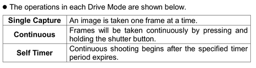

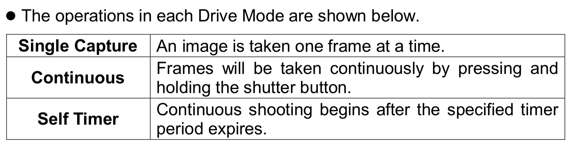

  • April 29, 2023, 11:26 a.m.
    I don’t think it’s interval mode you want, it looks like you should have self timer options of 2 and 10 seconds.
    According to the manual if one of those is set it should count down and then take the shots one after the other (self timer delay normally only applies to the first shot, unlike interval).
    This bit is under the bracketing section:
    PNG, 316.0 KB, uploaded by nightowl on April 29, 2023.
    PNG, 132.4 KB, uploaded by nightowl on April 29, 2023.
  • Members 36 posts
    April 29, 2023, 2:07 p.m.
    Great :-)! It's working with the Self Timer mode perfectly as intended: 2 seconds time, then it takes the three shots one after each other.
    Perfect. Thank you for your help :-)!
