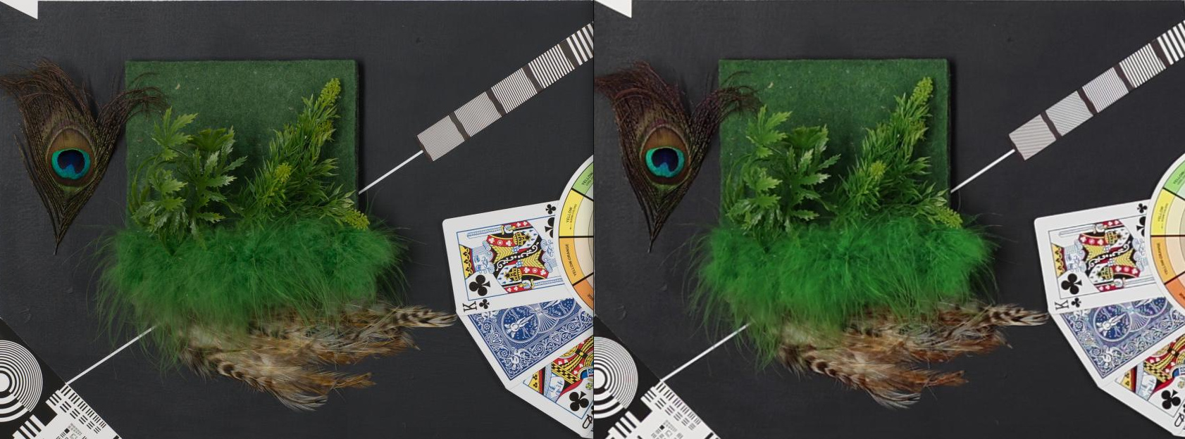

    Image quality suffer to some extent because of high compression of video stream. But the frames are usable. And this is only valid for very high quality 4K video clips.
    Same cropped areas from normal pictures are better regarding fine details.
    The quality of the 4K image also depends on the model of the camera used.
    Some cameras offer poor to very poor quality in 4K video. So individual frames are poor quality, not comparable with crops from normal frames.
    An example says all. Canon R6II, best picture quality vs an extracted frame (from Dpreview tests).
    JPG, 385.4 KB, uploaded by 3DGunner on April 1, 2023.
