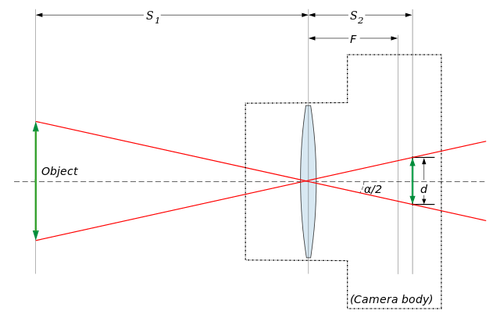

    I have used:
    angle of view = 2 * arctan ( 0.5 * 43.2 / f )
    where f is the focal length for FF,
    and 43.2 is the length of the diagonal of a FF sensor
    Here is a diagram from Wikimedia (alpha is the angle of view, and d is the length of the diagonal, i.e. the diameter of the sensor)
    PNG, 23.2 KB, uploaded by TomAxford on Feb. 19, 2024.

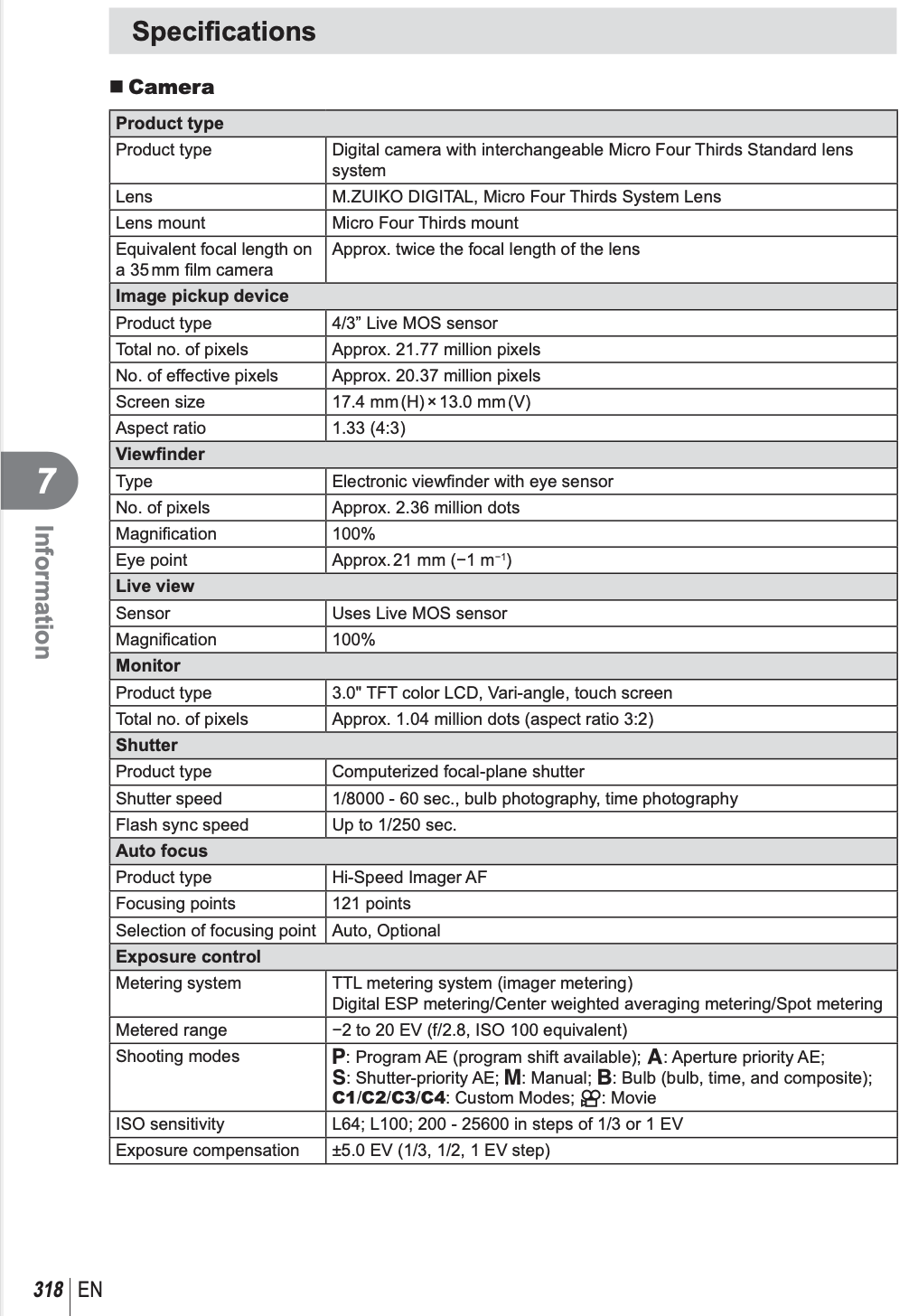

    Added note:
    The definition of "magnification" seems to vary when applied to viewfinders. Here is an excerpt from the specifications for the E-M1.3 from the official Instruction Manual supplied by Olympus. When they say that the viewfinder magnification is 100%, I presume they mean that 100% of the image is visible in the viewfinder and nothing more.
    PNG, 259.0 KB, uploaded by TomAxford on Feb. 21, 2024.
