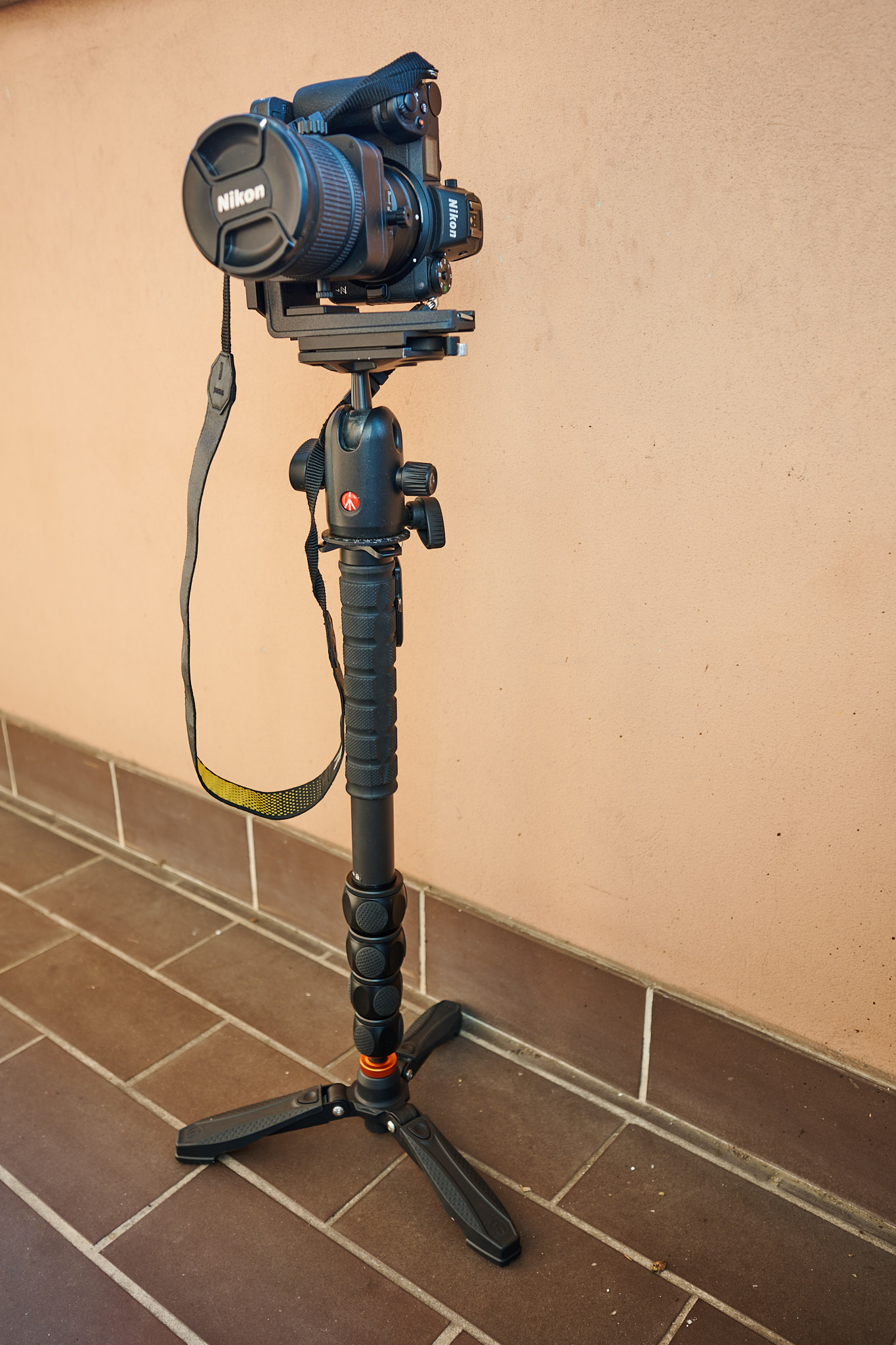

    Combined OIS and IBIS seems to have and edge when I use my Z7 + 24-200 , but I have done no testing.
    As to whether a camera has 3, 5 or even 8 stops, depends very much on the steadiness of one's hand holding technique. I do not know how they arrive at these numbers, or what they are measuring against. Hand holding is also dependent on focal length. I guess they measure against the old adage of the shutter speed matching focal length.
    I find I can get infinitely long sharp exposures with my three footed monopod technique, using IBIS, whilst my non IBIS D850, suffers from the micro vibrations that are present when I use this method.
    IBIS and OIS are probably dependent on the magnitude of the vibrations rather than time, are they not?
    JPG, 541.8 KB, uploaded by NCV on Oct. 31, 2023.
