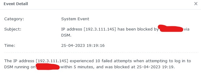

  • April 26, 2023, 10:27 p.m.
    The worst thing I've found is that someone has guessed my "connect to" name and tried to use it to log on as 'admin' with various passwords. Of course, my admin is not named 'admin' and the system blocks login attempts after a few (I think I have to set to 10). And, I get an email telling me what IP address was trying it.
    I am reasonably happy that my system is secure from outside interference. I did have a situation a few years ago when, everytime I opened port 22 (secure ftp, I think), somebody from China would notice and try hacking. They never got in and I found a better way of doing it. I think they'd got an "in" to my ISP and was sitting there monitoring network traffic.

  • April 26, 2023, 10:38 p.m.
    This is the only issue I've had on this box since Feb 21 (when I set it up)
    JPG, 28.7 KB, uploaded by AlanSh on April 26, 2023.
