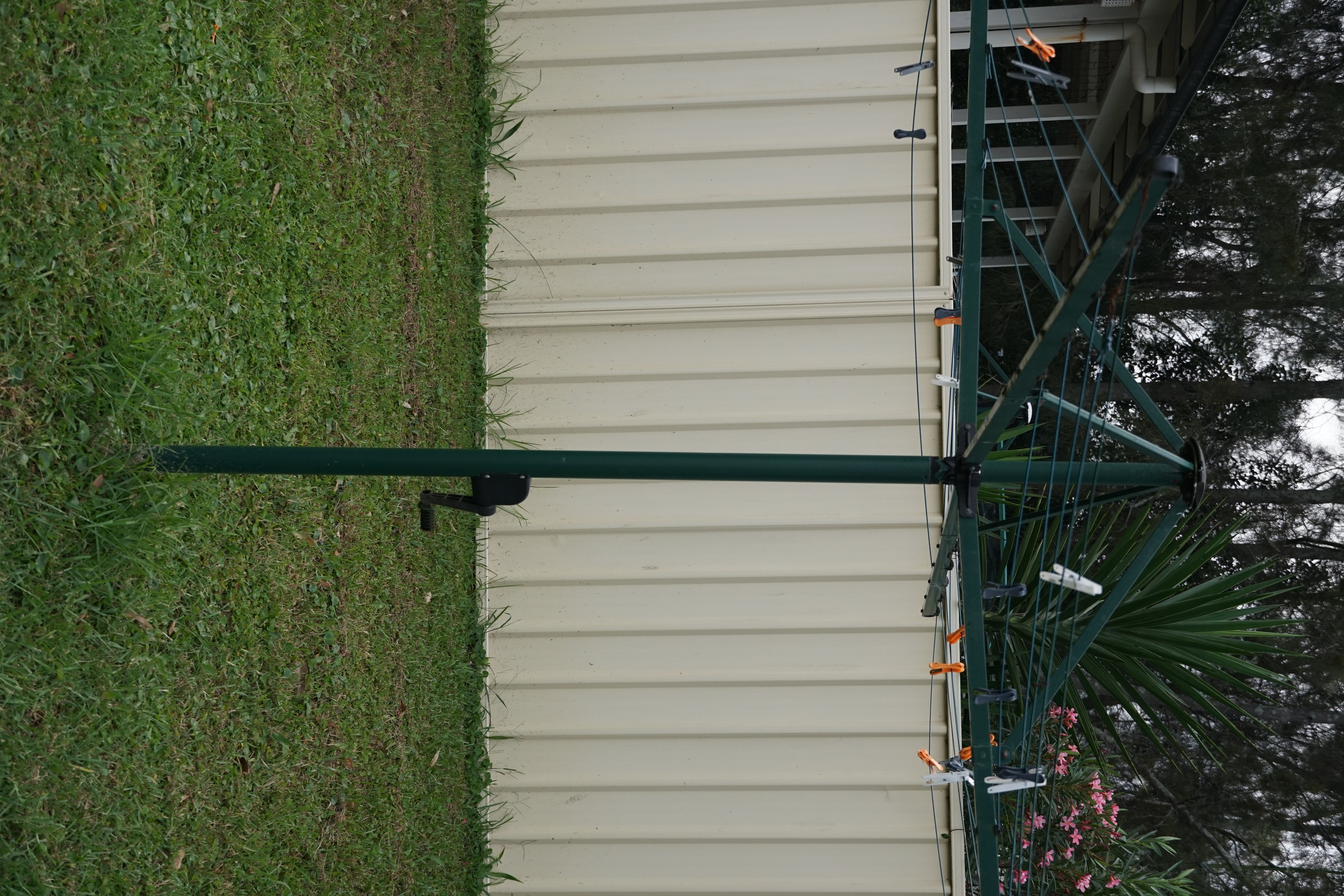

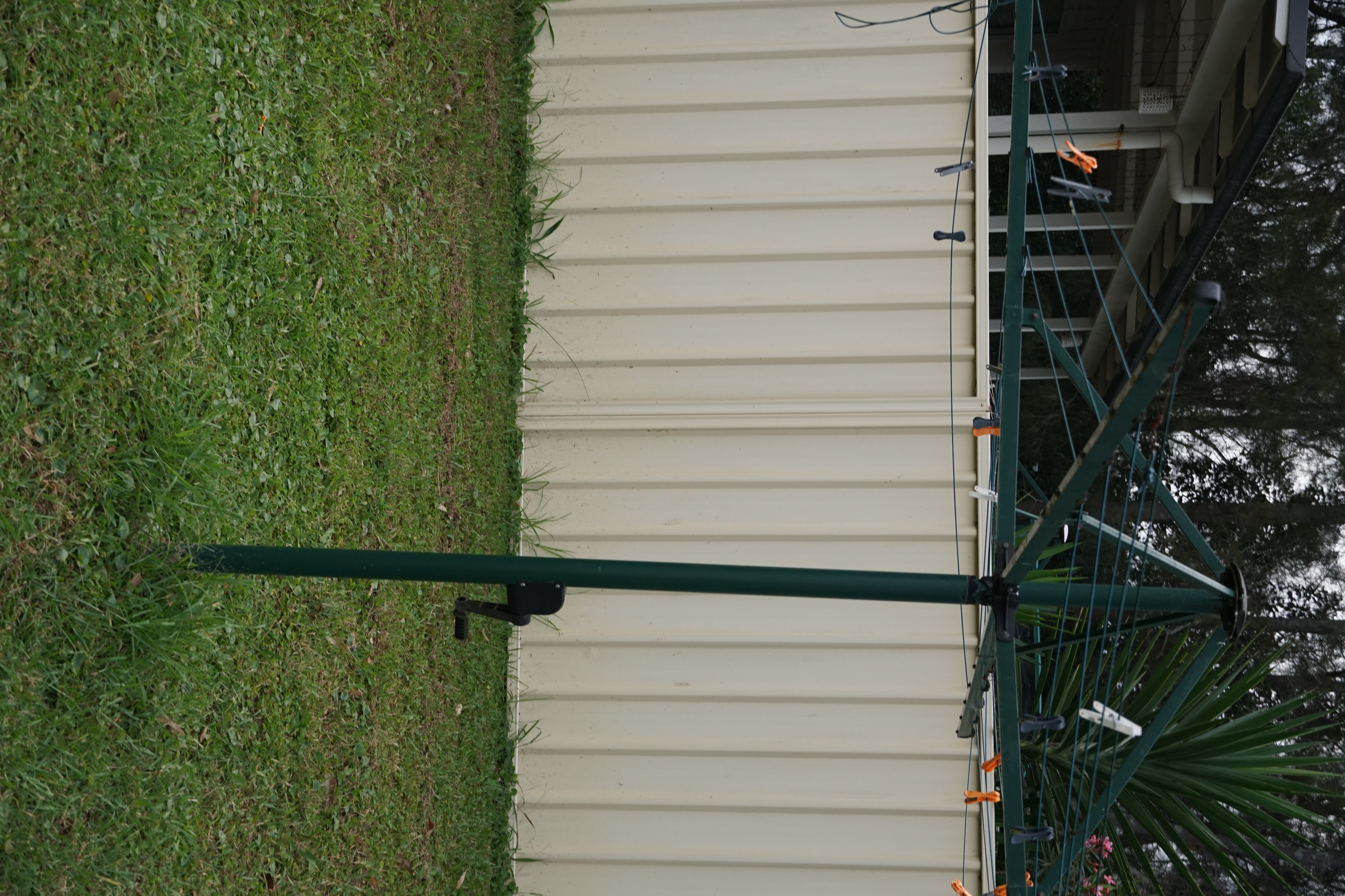

  • Members 2120 posts
    March 14, 2024, 6:36 a.m.
    fast pan and stationary shot.
    JPG, 7.9 MB, uploaded by DonaldB on March 14, 2024.
    JPG, 9.1 MB, uploaded by DonaldB on March 14, 2024.

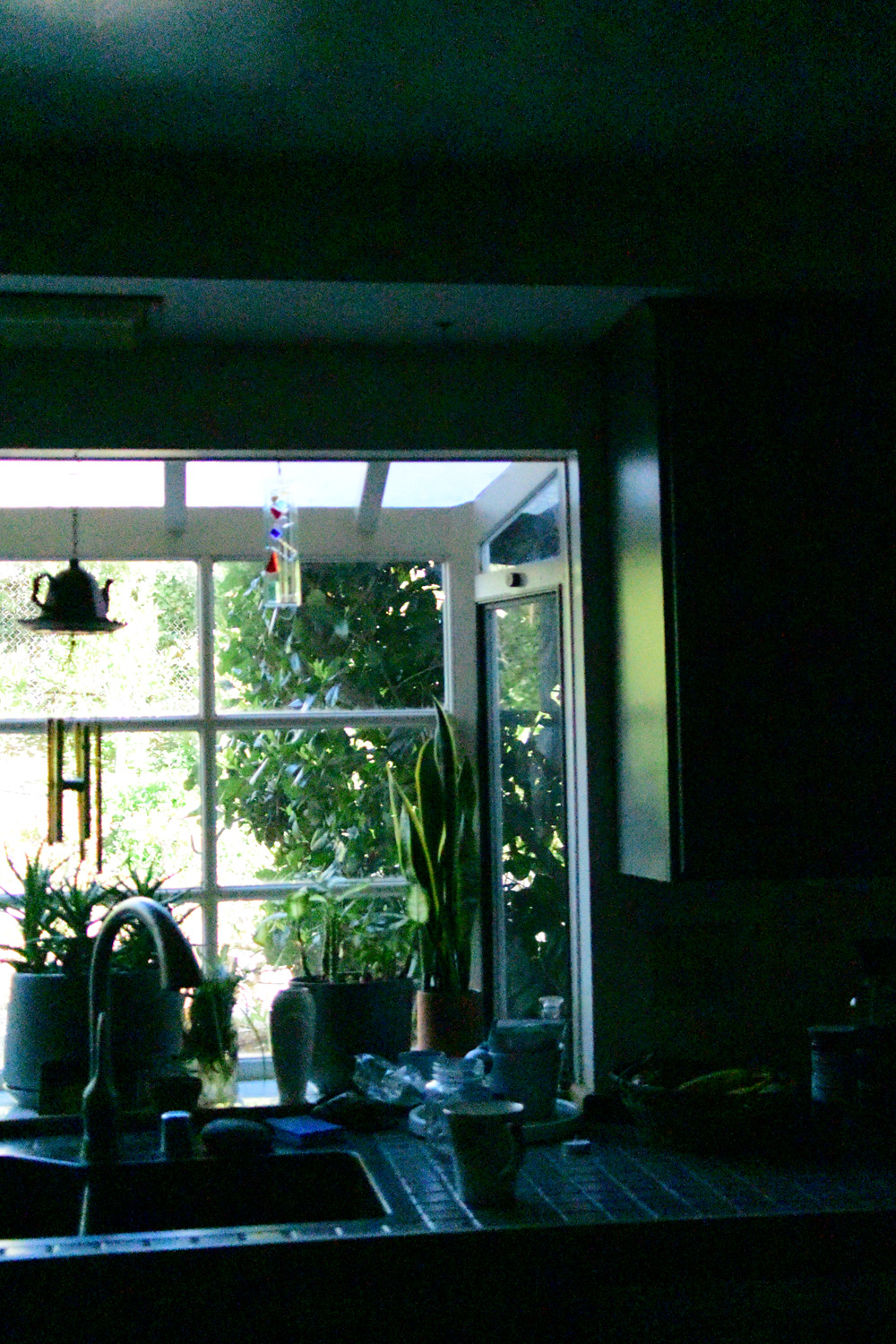

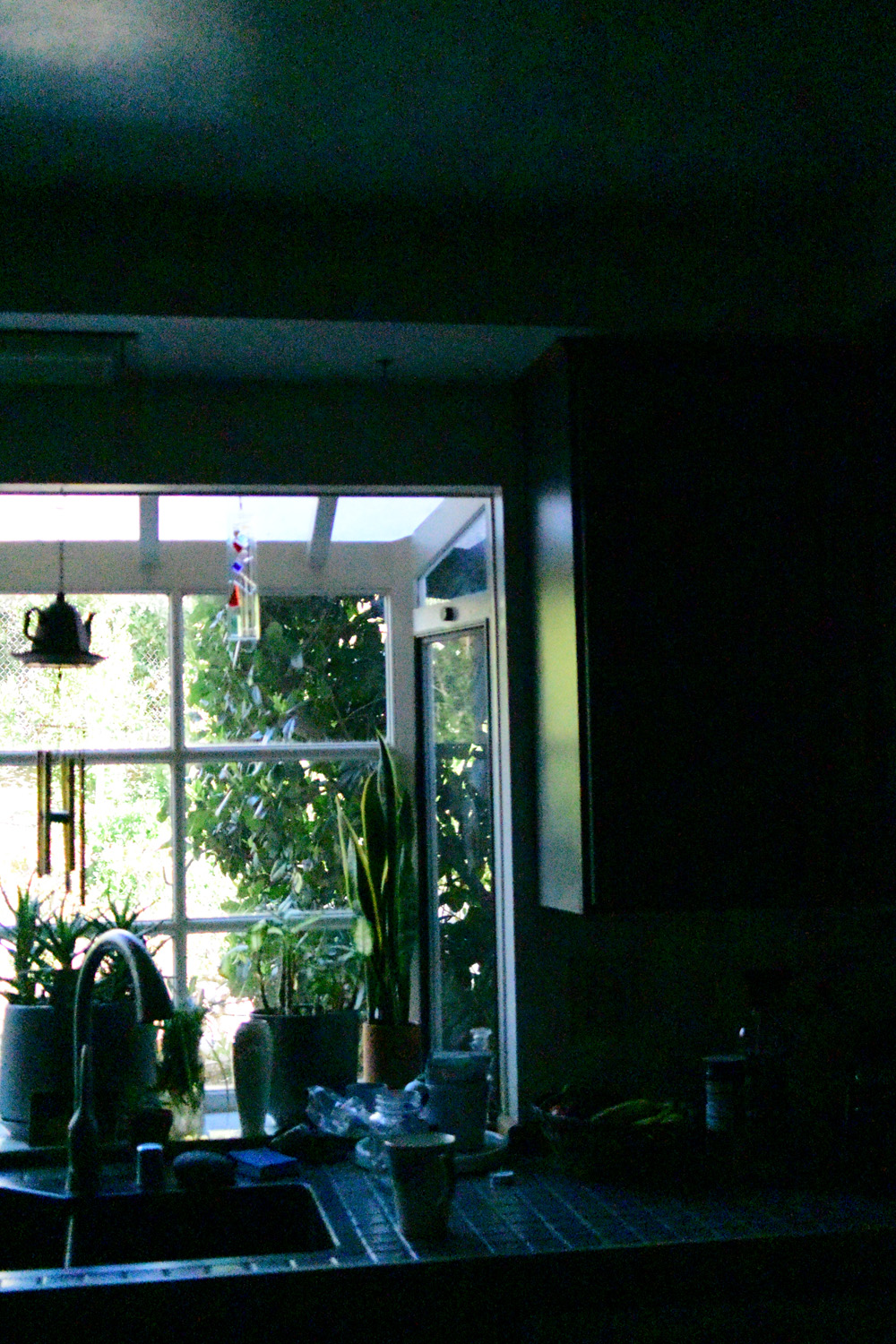

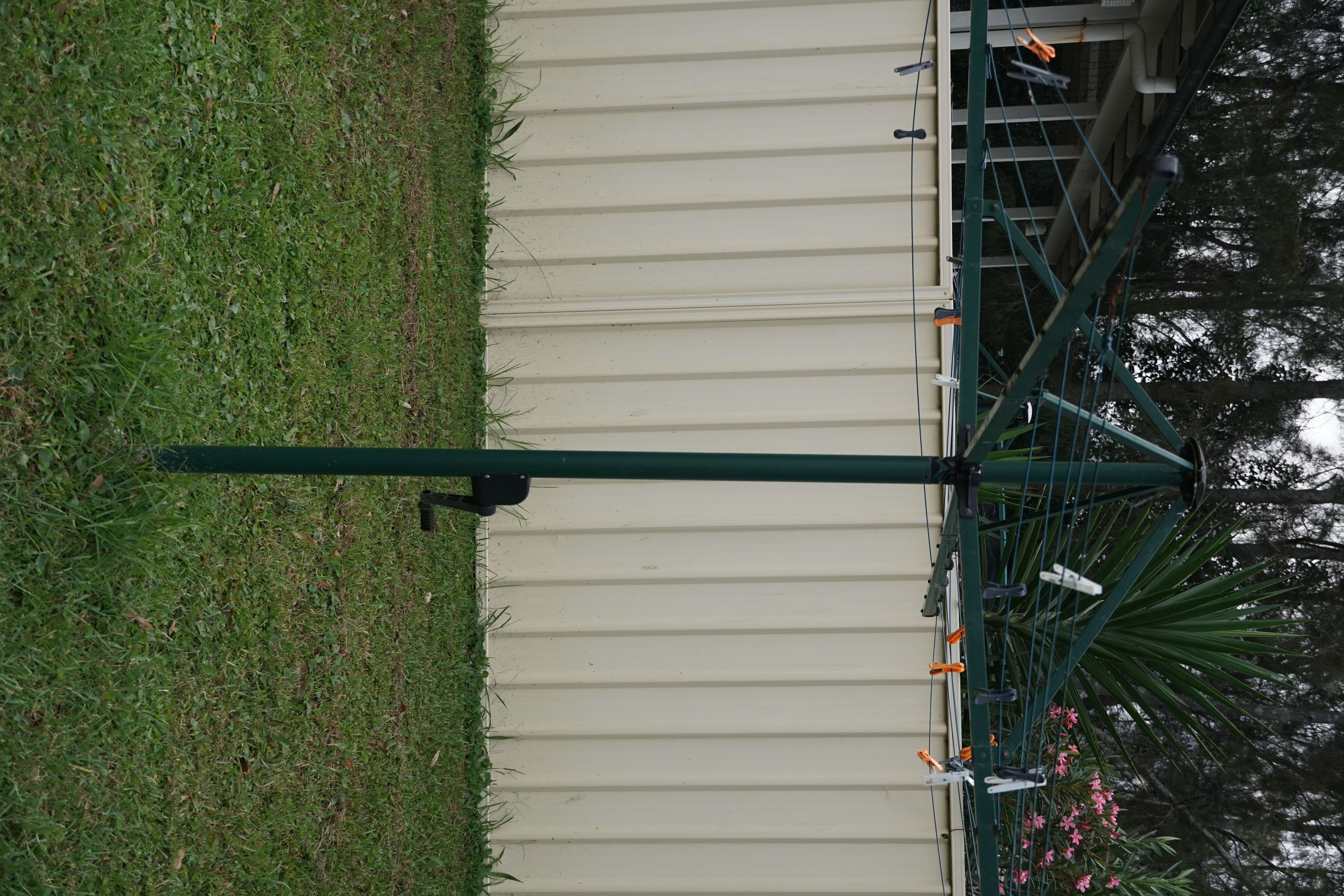

  • Members 126 posts
    March 14, 2024, 6:12 p.m.
    Yes, that example shows a bit of compression/expansion.
    Here's an example that shows more. The V3 electronic shutter has a readout speed of about 1/80s. I guess 1/8000s was unnecessarily fast, but I was panning pretty fast and wanted to avoid blur. I stopped after catching these two almost perfectly framed shots.
    JPG, 643.2 KB, uploaded by sybersitizen on March 14, 2024.
    JPG, 622.2 KB, uploaded by sybersitizen on March 14, 2024.

  • Members 126 posts
    March 14, 2024, 11:36 p.m.
    Neither is 'correct'. One is panning left and the other is panning right.
    As I said, I chose it to be sure to avoid blur so I could pan faster and show a greater difference. I could have chosen a slower shutter speed and a slower panning speed without incurring much blur and without incurring as much compression/expansion.
    You understand that the 'shutter speed' is simply how long each pixel is turned on to receive light, right? And the 1/80s part is how long the progression of pixels turning on takes to move across the frame from edge to edge? The panning speed and the sensor speed act together to determine the extent of the compression/expansion. We just need a shutter speed that gives a decent looking result without blur from whatever panning speed was used.
